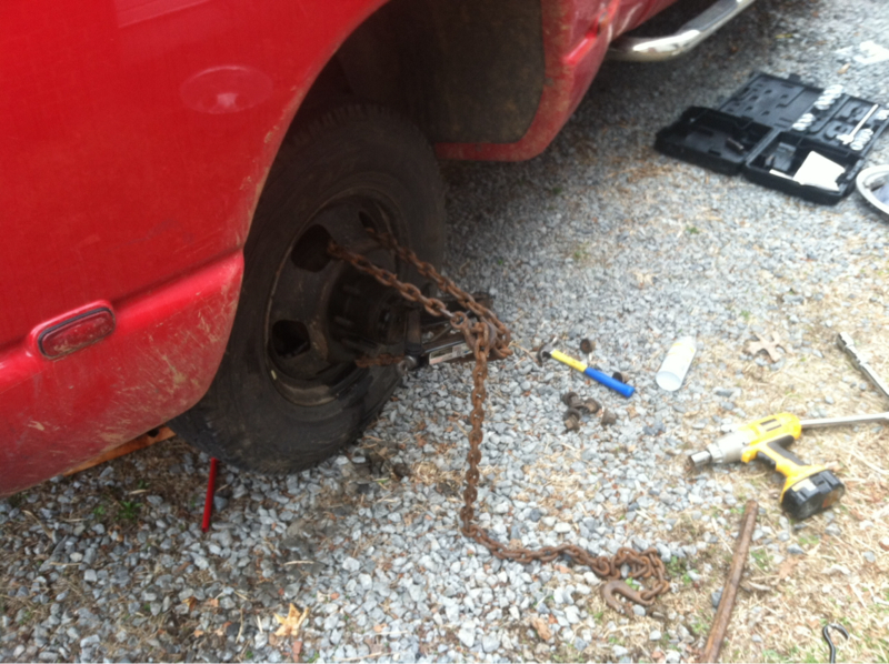

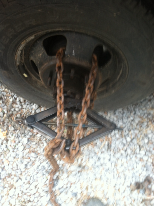

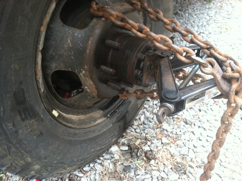

I had similar problem last weekend. 5 hrs. To get to the front universal joint. Then decided I would go ahead and rotate the tires. The picture says a thousand words.
   / Does anyone know a special trick to get the wheel free from hub (F250 SD) ? #14
That was a pic of the rear, but had to do the same on the front. Applied pressure with jack then struck with large hammer. Plus 2 cans of PB Blaster didn't hurt.
