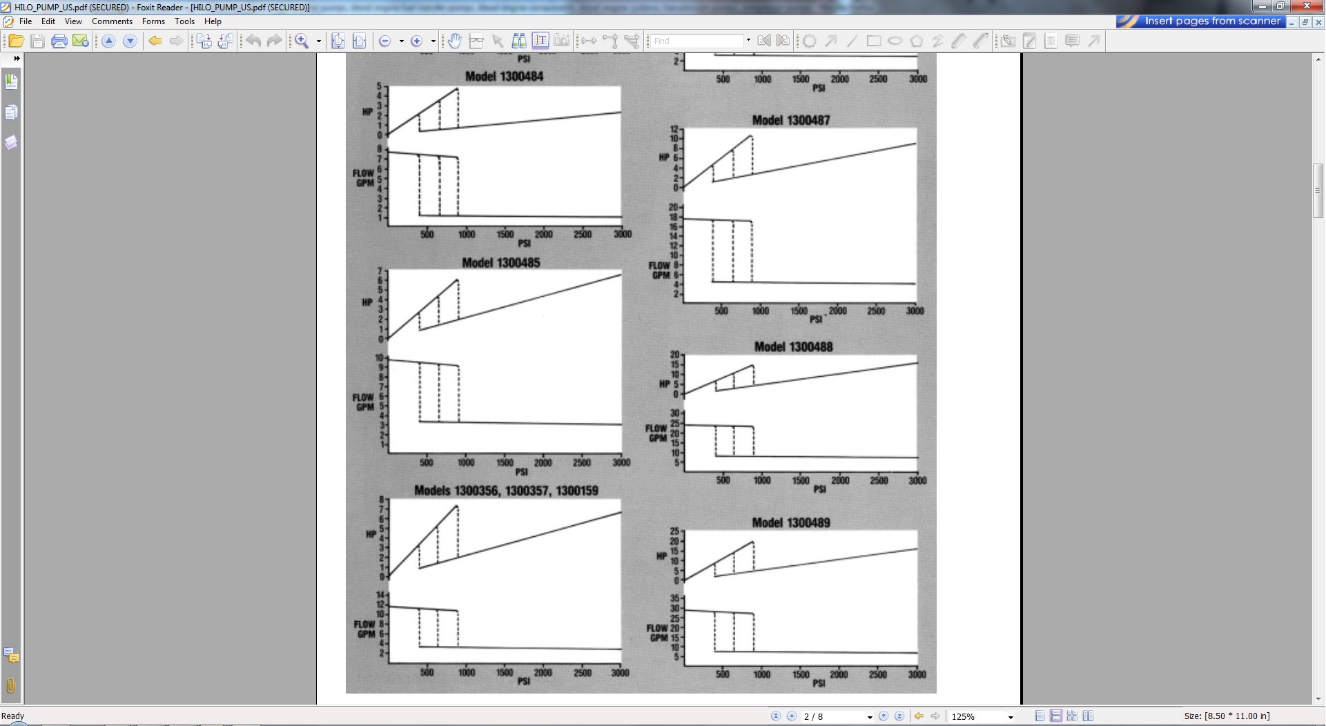

Yould think that it should run it. Ive seen the recommended HP all over the place depending on which store your looking at.
I looked at the chart for my pump, actually if you look close max psi is pushing 16hp.
Ill post up the pump chart when i find it again.
One last thing, "Barnes" is no more. Theyre "Concentric" now. You wont believe me how long that took me to find out!
Heres the link: http://www.concentricab.com/_downloads/Catalogs/HILO_PUMP_US.pdf
   / Does building log splitter make $ sense #31
Ok heres the chart. Notice the HP peaks for both the 22 and 16gpm
See the attachment. 1300488 is the 22GPM. 1300487 is the 16GPM

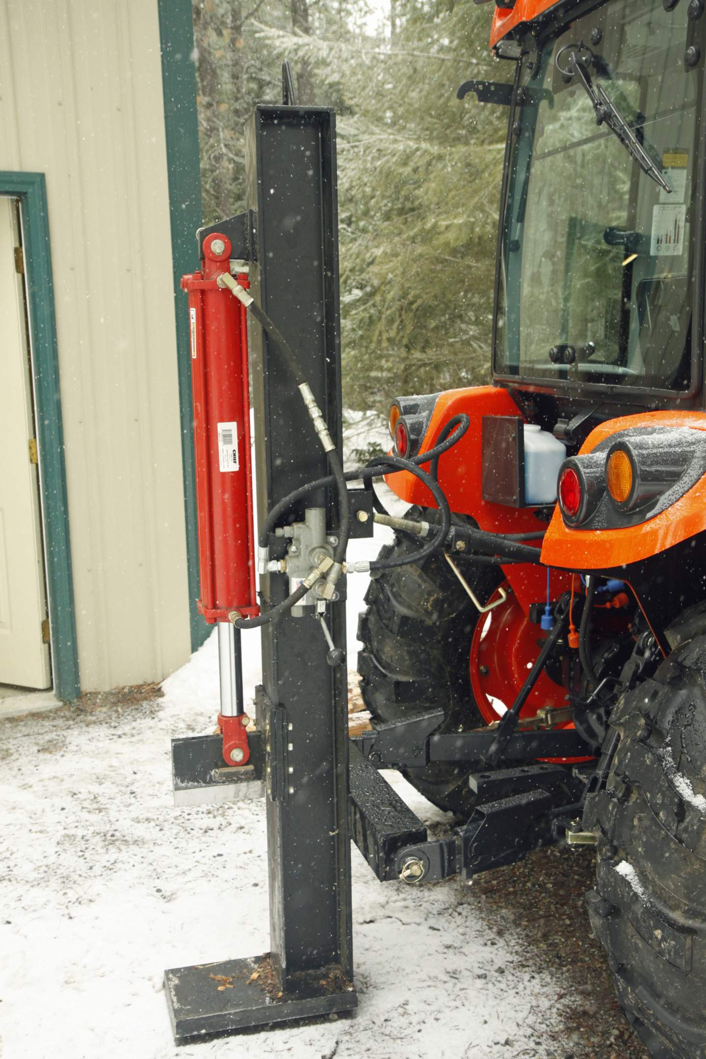

For a 3 point tractor powered splitter i am currently helping a friend build one. He found a used h beam for $60 at the wrecking yard. plus the following
1. base steel, $30.00 scrap
2. pivot wedge northern tool $30.00
3. Wedge northern tool $33.00
4. 4" x 24" x 2" tie rod cyllinder = $175.00
5. prince splitter valve (surplus center) = $ 70.00
6. hoses - unknown yet
7. rest from scrap in shop.
total = $398.00 + hoses
not sure where there getting 1200 estimates.
this one will be just like mine...and mine works great

I also notice that for 11gpm model, it is calling for just over 7HP @ max. And our 6.5HP briggs has NEVER stalled:confused2: Very confusing

I dont trust those catalogs at all. They just say "Minimum X Hp" but dont mention anything about PSI.
The chart in my above post is right from the manufacturer. And im going to say its right on. My 14Hp motor cant run my pump at 3000psi. The chart seems to indicate 15-16 as the necessary HP. Id bet if i had 16Hp id be fine.
   / Does building log splitter make $ sense #40
Actually if you follow the chart across, youll see that at 3000 psi it lists about 6.5-6.75 HP. There are a lot of variables here as youve said.
The peak of ~7.25 is on the high flow side at about 850 psi. The slope is pretty steep and depending on where your pump shifts you might never see 800psi on the HF side. If your pump shifts at say 6-700 Psi it probably is only using 5.5hp.
Or maybe your engine is making more than its rated HP?
