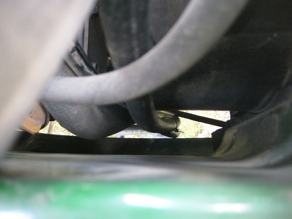

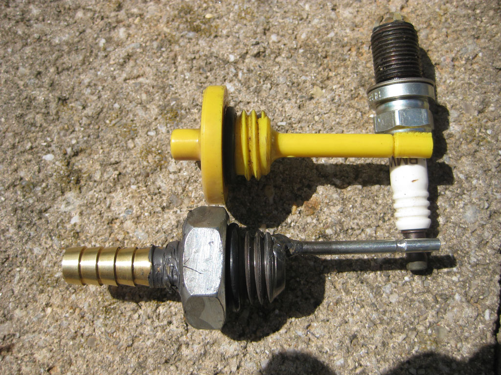

The wife inspired an addition to the vented plug....

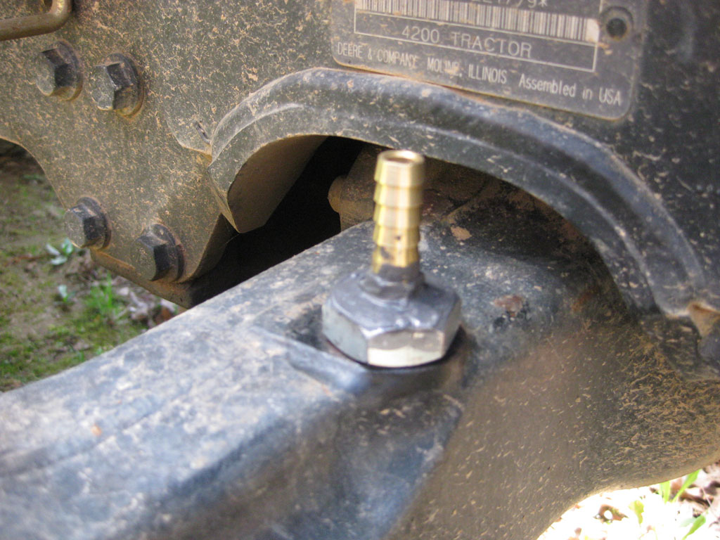

   / Does Everyone Have a Front Axle Leak? #43
Installed...
   / Does Everyone Have a Front Axle Leak? #44
No vents in the 42/3/400 tech manual...
EDIT: Roy, what kind of vent is that? I hope its a pressure release valve seeing as how it better not be vented to atmosphere that low to the ground!
No vents on my buddy's old 4300 either. I got down there Saturday. Reckon my memory isn't what it used to be!
The vent on the 790 is capped. You remove it prior to servicing the front axle lubricant. There is no a permanent venting to the atmosphere (which probably contradicts one of my earlier posts, but I'm not going to search for that). Probably not need for permanent venting as there appears to be adequate volume (in the axle) to accomodate the gear oil expansion.
That's a nice job you did on venting your 4200's axle, Arribil!
