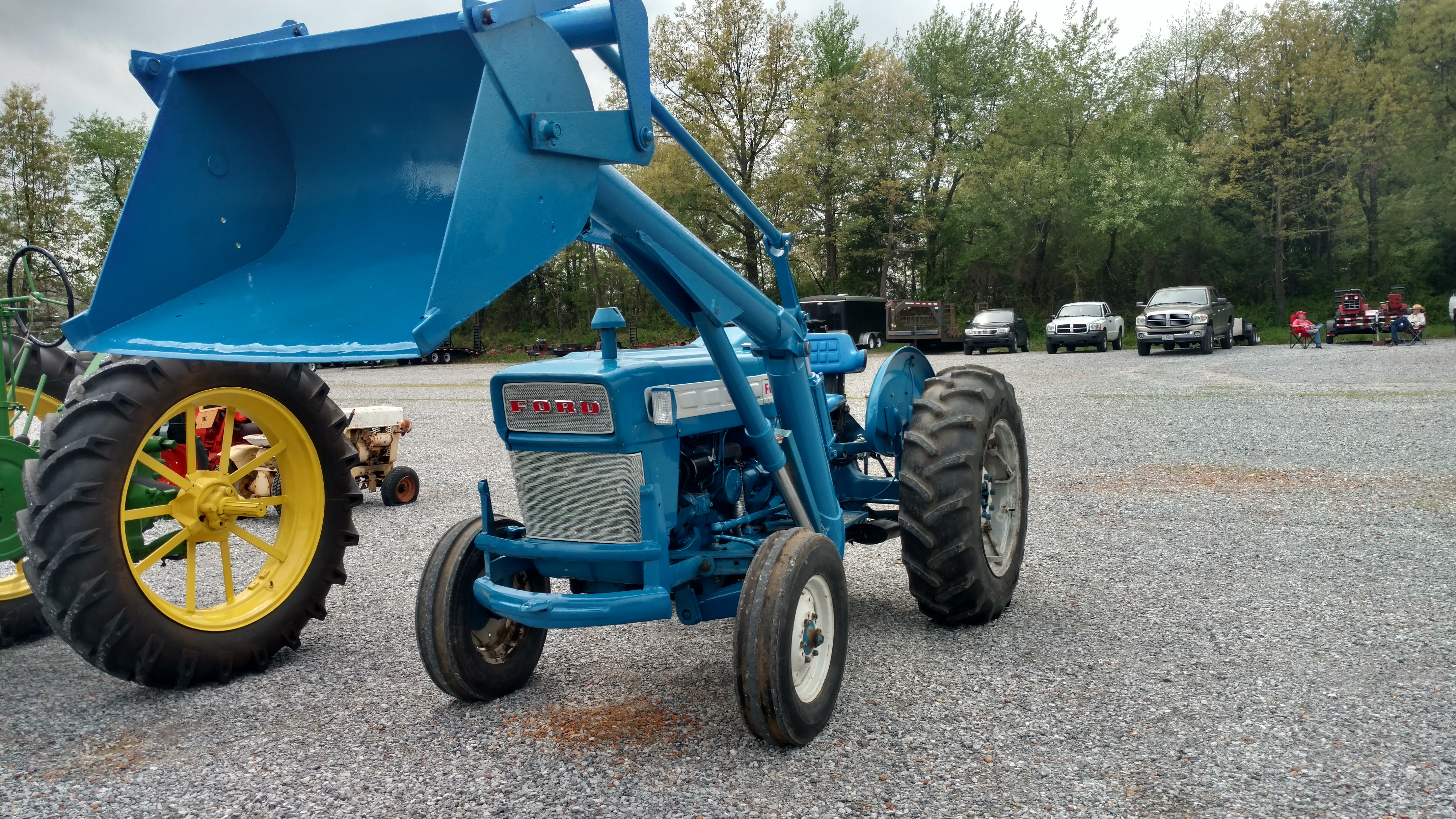

Well we showed up more or less read for our first antique tractor show. I found out if you buy a lot of gifts given the club to be auctioned off can be a positive thing all the way around.
These photos were the first I have seen of the 3000/711 loader project as it finally came together. Some like the headlights but most importantly the daughter likes them. I painted the grill with TSC Ford Gray. I used MF Red to redo the only red that I have on any Ford tractor since I could not see the difference in it and Ford read and I will need it for the 265 MF and when keeping the Cat 2 3PH fork lift OEM colors of red and black.
The difference in the grille quality from 1966 to 1980 dropped like a rock I can now clearly see.
The 2x4 cut for a last minute cylinder safety stop to keep it all the way up in the air did not hold up so I ran about 3 miles and picked up a 3/4" thick and 24" long 6" wide steel plate before they closed at 5 pm for the week. It is now stable as a rock and the pressure is on the pedestal upright. I will knotch it later for a more perfect fit and secure it with a U bolt clamp bolt around the upper end of cylinder. As it is we have to start the engine to remove this piece.
We drove the tractor to the Mayfield KY fairgrounds since I had no truck today to pull a trailer so that let me get an hour on the hour meter.
The top bar on the bumper is totally missing so we did not have to cut the end off so the loader boom does not catch on the front bumper.
The show is to be over Saturday sometime after lunch when the people/tractors load up and head out of town.
So far we are the ONLY blue tractors and the only tractor with a FEL. There are two red bellies and one very nice metallic green 35 Fergerson. Some are huge old tractors and a lot of hit and miss engines.

Looks great...you'll get a prize for sure.
I got mine put on today. It was a bit of a chore. I thought I was going to be an inch or so short on the front mount like yours and 4 inches low. I was kicking myself for not trying with my wood template first. Tried to hook it up using a hoist and tree limb. Not a good idea. No way it was going to fit that way. At all. Got fed up and drug it to the shop on a concrete floor and it was easier, but not easy. Still didn't think it was going to fit. Couldn't get the loader into the front bracket first as per the book. Finally Hooked up the hip and the tranny strap. Horsed with it for a while trying different things. Finally jacked up the bucket (loosened the small tranny strap) and its started fitting into place. Had to loosen the front bracket nuts so I could move the bracket forward as the loader moved to get clearance and then once it was lined up I tighten the nuts up and drew it into the loader. But it fit and worked fine. No way the bumper clears. Checked everything over and Pushed a couple brush piles around with the manure forks and called it good for the day. The hyd valve I had worked fine. Got to get new grease zerks. Straighten the bucket a bit. Never going to be a show piece.
If I take it off, I'm getting a couple of those cheap car dollies at Harbor Freight to put under the bucket. A floor jack on wheels under the other end and it should be easier the second time around. ;

Awesome to hear you have a working Ford 711 loader now. You started out with a much nicer loader than we did. A $12.99 quart of the old Ford blue from TSC and a good paint brush will make yours shine too but will not make it more functional. While we had the pins out I removed the old grease fittings and reamed out the old grease and replaced with new ones. I had to use a nail and a hammer to drive out some of the 50 year old grease.
Did you get the sense the 711 was strong to handle some pushing OK?
There were no entry fees or prizes for this event that they seem to use as a membership drive, at least it worked on me. It is only $15 per year however. While the 3000 is 52 years old it was the only blue ford there and the only tractor with any kind of loader. One JD guy did ask where was the other half of the loader. I told him I looked for it but ran out of time to keep looking for it but would try to find it for the event in 2019. He laughed. At 67 it seemed like I was younger than many but there were some kids out driving the tractors too. If I come up with a good trailer option I may go to the one in Paducah KY later this year since it is only 40 miles away. There were 40-50 year old sons there with their dads so I think the antique tractor events will continue.
There was a lot of my brand is better than your brand ribbing but it seemed to all be in fun. Prizes might make it get more serious however. :)
