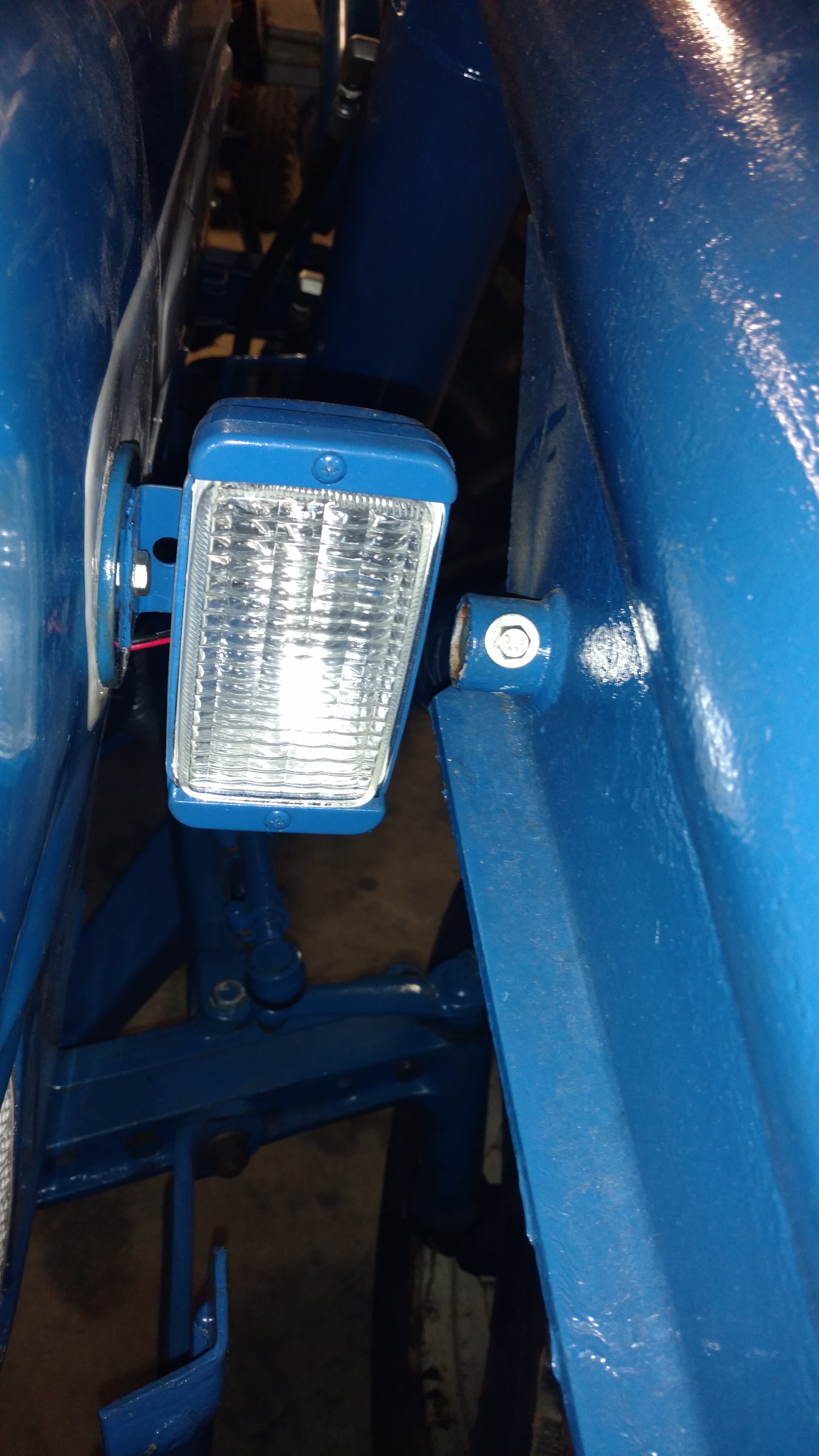

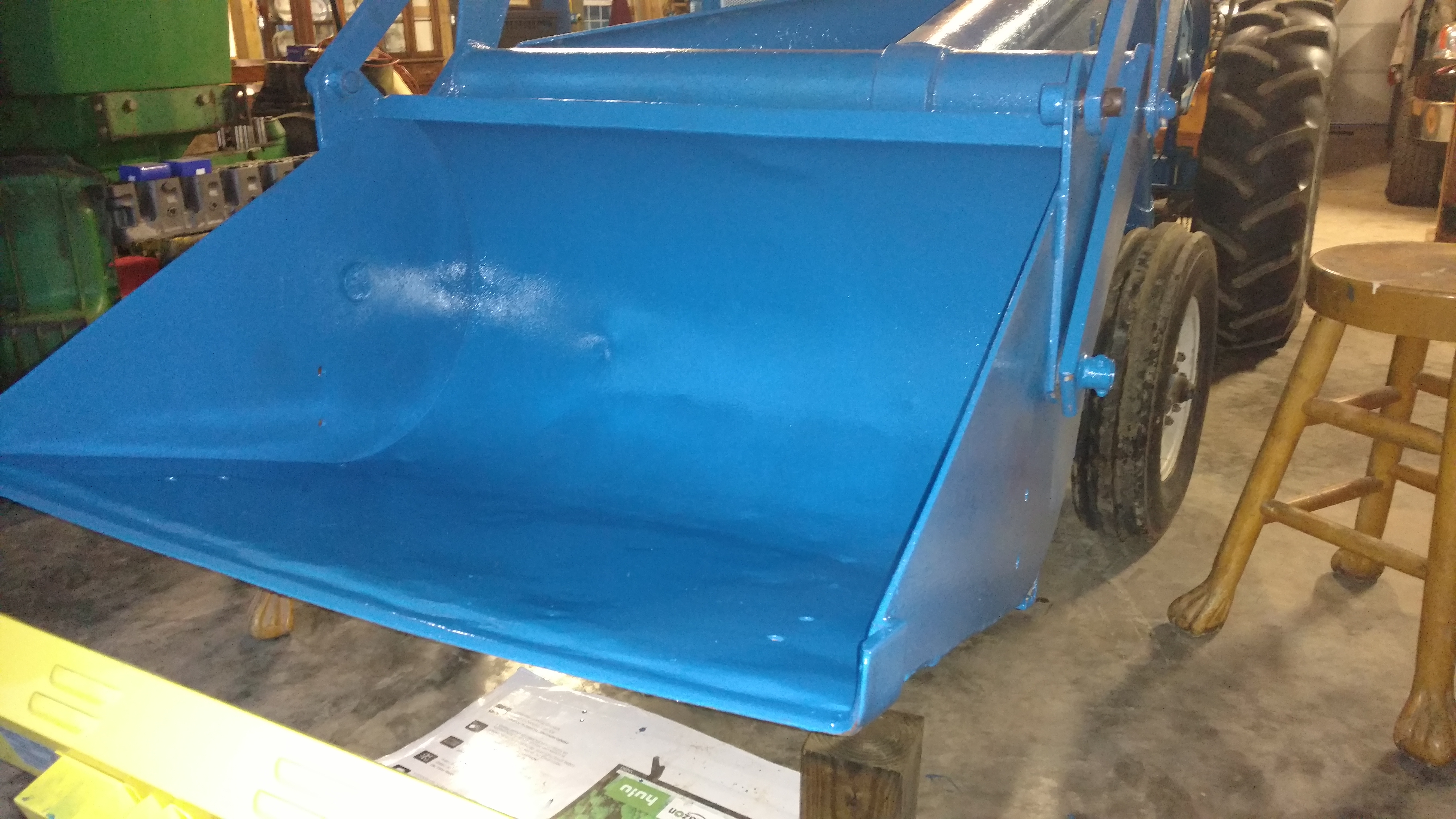

Even with our .500" shim we had to take a die grinder to prior ownership making the hip mounting plate thicker due to welding on bracing after it broke in the past. Try jacking up under the front bolster so that neither front tire will touch the floor/ground when fully depressed with just your weight. Check clearance at extreme range of motion in each direction. Again that is awesome info should I totally lose my mind and mess with another 711 Ford loader now that ours on the 3000 and seems to be ready for the show the tomorrow and Saturday. :)
I am pleased with how the now straight and beefed up bucket turned out as well as the Ford 711 one arm loader friendly set of headlights.

On the lights the shop owner said we could not send a one eyed tractor to a tractor show. My solution was my first choice for a work light replacement because it was like the broken one that came on it but he said they came with one with and off and on switch at the light which I remember from our new 1962 801 Ford and I found one which we used instead. I just picked up the second one when the head light solution evolved and I did the headlight paint job using a $5 can of old Ford Blue from TSC.
If we pull off the loader I am thinking we will do it at the top pin and just leave the base on the tractor since all of my arthritis limitations. While these lights are not a good match for the era (I am storing the OEM lights that are in great shape) at least now we will not have a missing headlight.
