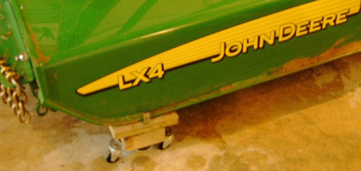

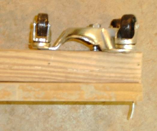

Here's mine. These tri-dollies weren't heavy enough. A couple eventually broke. Had the same problem with plastic dollies underneath my carryall. Gotta use steel dollies.
I now have heavier steel dollies on a 2x6. The original tri-dollies were great because they would sit without falling. To achieve the same thing with the heavier, single dollies, I put 4 of them at offsets to each other. One of the reasons why I had to go with a 2x6, to get the width so the board would sit upright by itself. Once the bush hog is lowered onto it, it'll of course sit fine even 2 of the single dollies.
You gotta remember to remove the board when pulling out. One of other reasons why I went with the 2x6. It won't break if I happen to drive the tail wheel over it.
Note also the little angles. This keeps the dolly from slipping out from underneath to the side when you push the bush hog about in storage.
