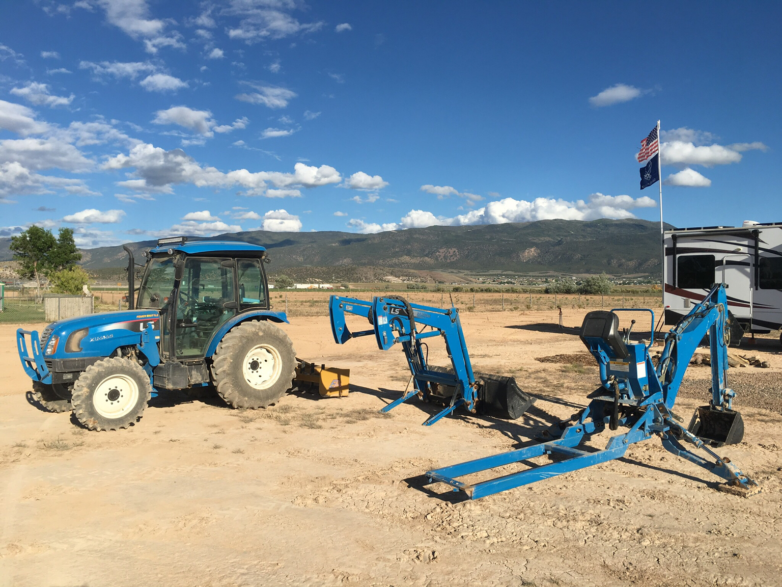

Here is a pic of my 3102 backhoe for XU series machines.
Getting it off takes about 3 minutes. Getting it back on takes me about 15 minutes or so. Its all about getting the tractor lined up. With 2 people, its actually pretty quick. One drives the tractor, the other guides and works the backhoe controls to get the subframe the right height and level.
   / Dolly for LS XG3025 LB1106 Backhoe
3Lfarms thanks for the photo and the info. Do you think a dolly on a concrete pad or floor would make a "one person" installation easier? Initially I was thinking about storing the backhoe on a dolly in one of the bays in my shop. The dolly would allow me to move the hoe close to the wall so I would still have useable space in the center. However looking at the size of the subframe & hoe combined I might not have enough space to do that inside of one of the bays. My other option would be to pour a concrete pad under one of my shelters and store the hoe there, so the question, would a dolly be beneficial in that scenario for a one person operation?
