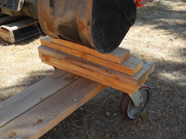

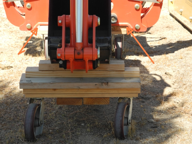

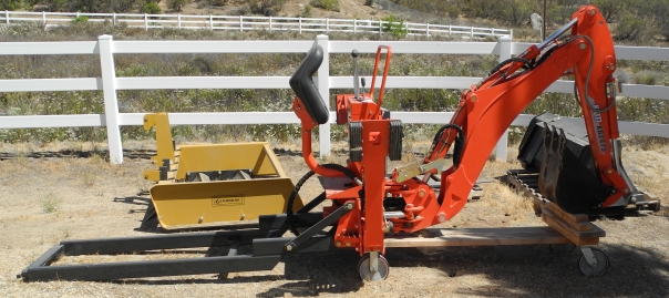

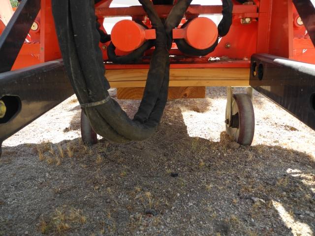

1) Here is the backhoe on its dolly. Normally it lives on concrete in the garage, but at the moment it is in the yard. When in the garage I usually put a Harbor Freight dolly (the little size, 11?) under the front end of the subframe just to keep it off the ground.
Total length of the dolly is 62". Wheels/casters are 9". Width front and rear is 24 1/2".
2) The height of the wood under the bucket (9") was trial and error. The lengthwise boards are not really load bearing and are 2x6s for total width there of 11".
3) The arrows show that the width was not trial and error. It is fit to the contour of the underside of my backhoe thus will be different for most every backhoe.
The backhoe balances on the front of the dolly, so rear platform height controls subframe height. To some extent, anyway. Rear wheels swivel, front are fixed. None have brakes.
4) The height of the dolly at the front is arbitrary. For mine, that is 4" of wood over the 9" wheels.
No pics of the dolly without the backhoe on it, sorry. Anything need clarifying? :)

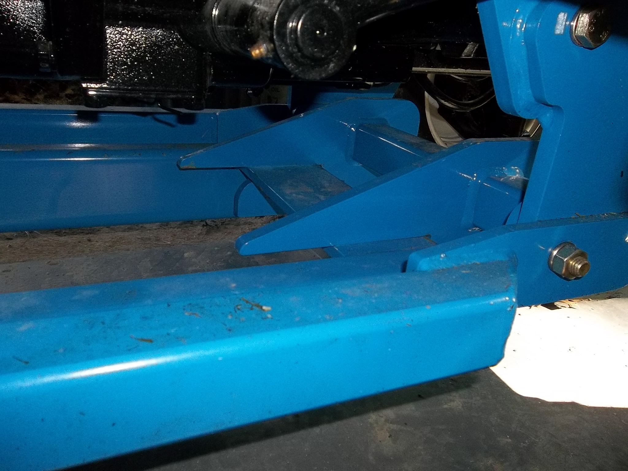

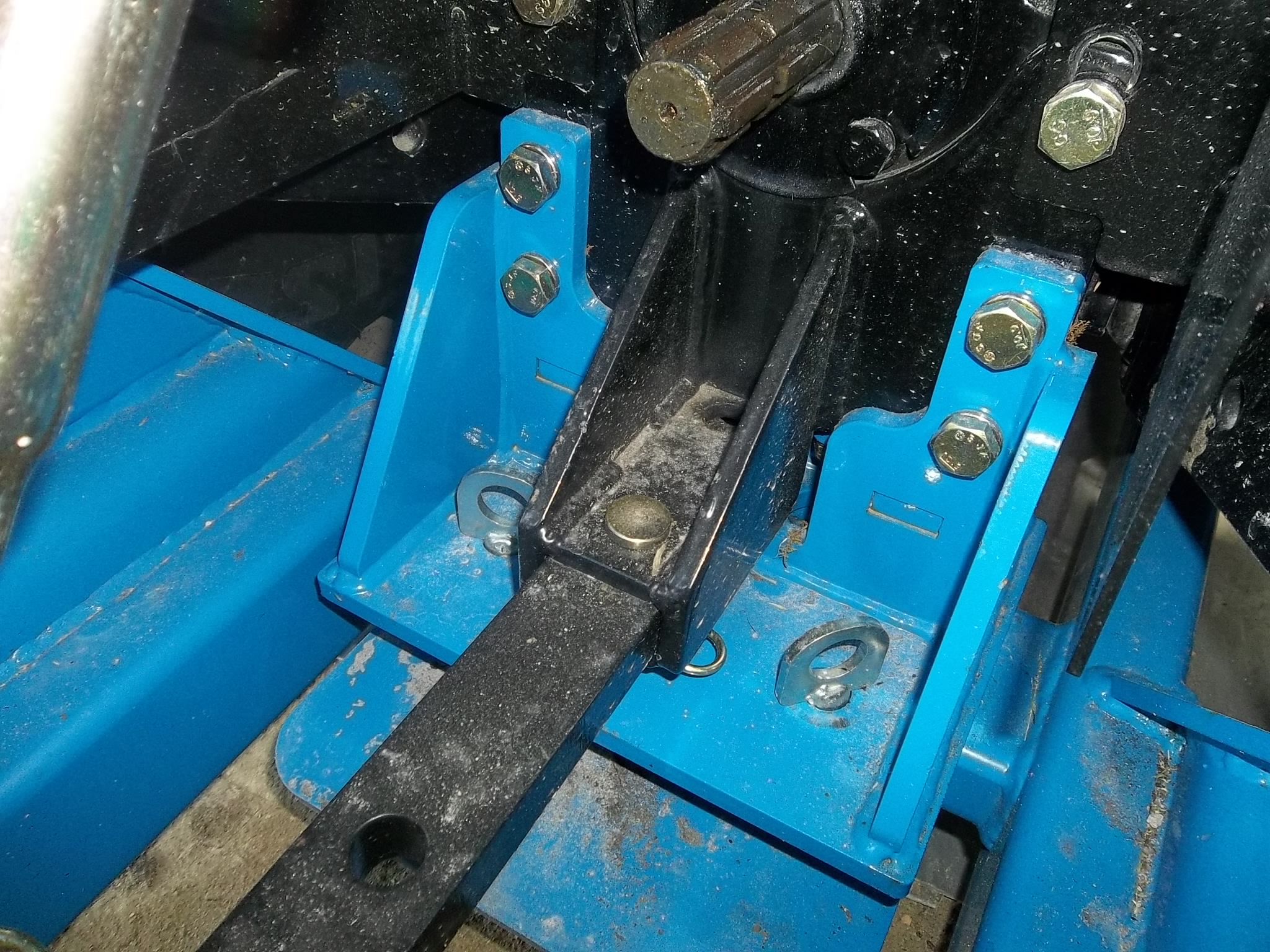

In a previous post I mistakenly stated that the subframe comes off with the backhoe but as 3Lfarms has correctly pointed out, only a portion (ladder portion) comes off with the hoe. The main part of the subframe stays on the tractor and connects at the front to the loader mounts and in the rear to the rear axle housing. The first attachment is a pic of the front mount. 100_1137.JPG The second photo is an attempt to show which part is removed with the hoe and which part stays on the tractor.100_1138_LI.jpg The last photo shows the rear mount and the two pins that hold the backhoe on the portion of the subframe that stays on the tractor.100_1139.JPG On my tractor (XG3025) it appears that the drawbar is not modified by the backhoe subframe. I also must agree with 3Lfarms that the addition of the backhoe subframe appears to add significant strength to the tractor. Hope I haven't muddied the water with the photos!
