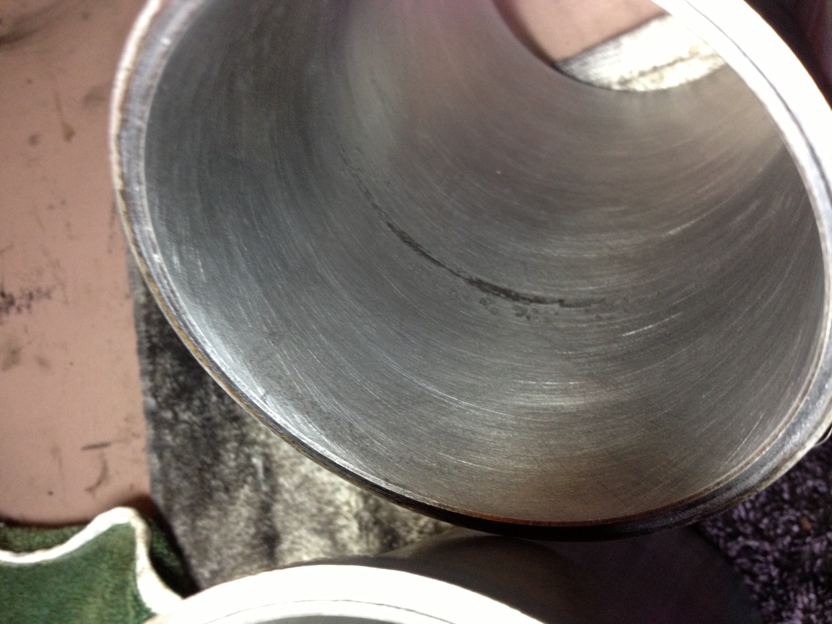

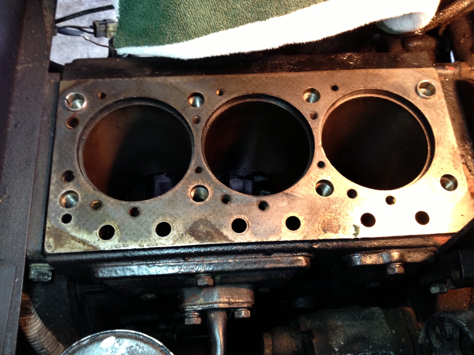

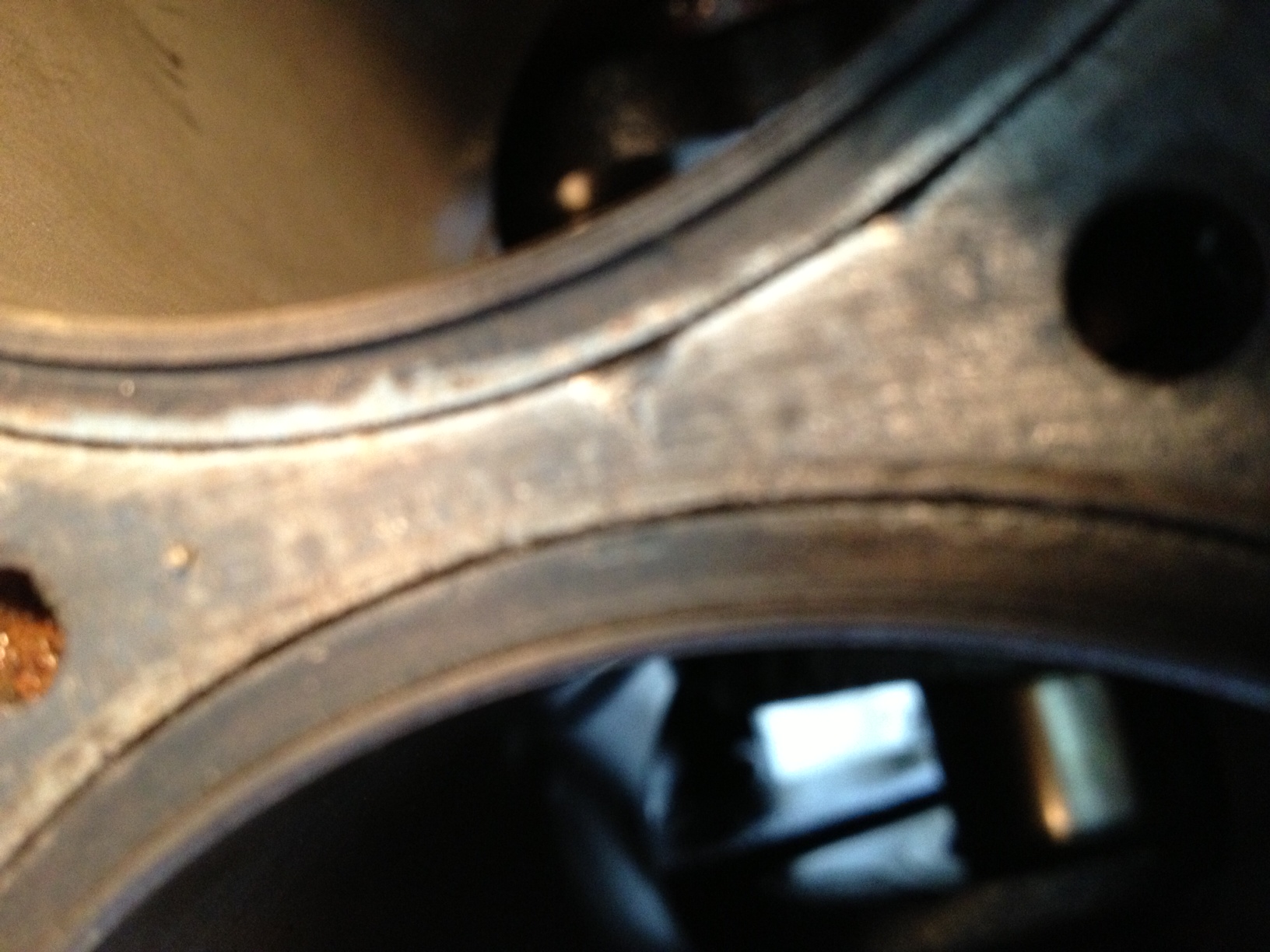

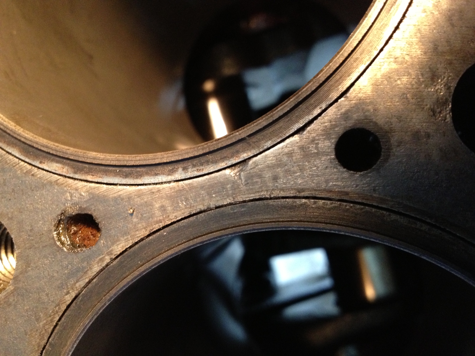

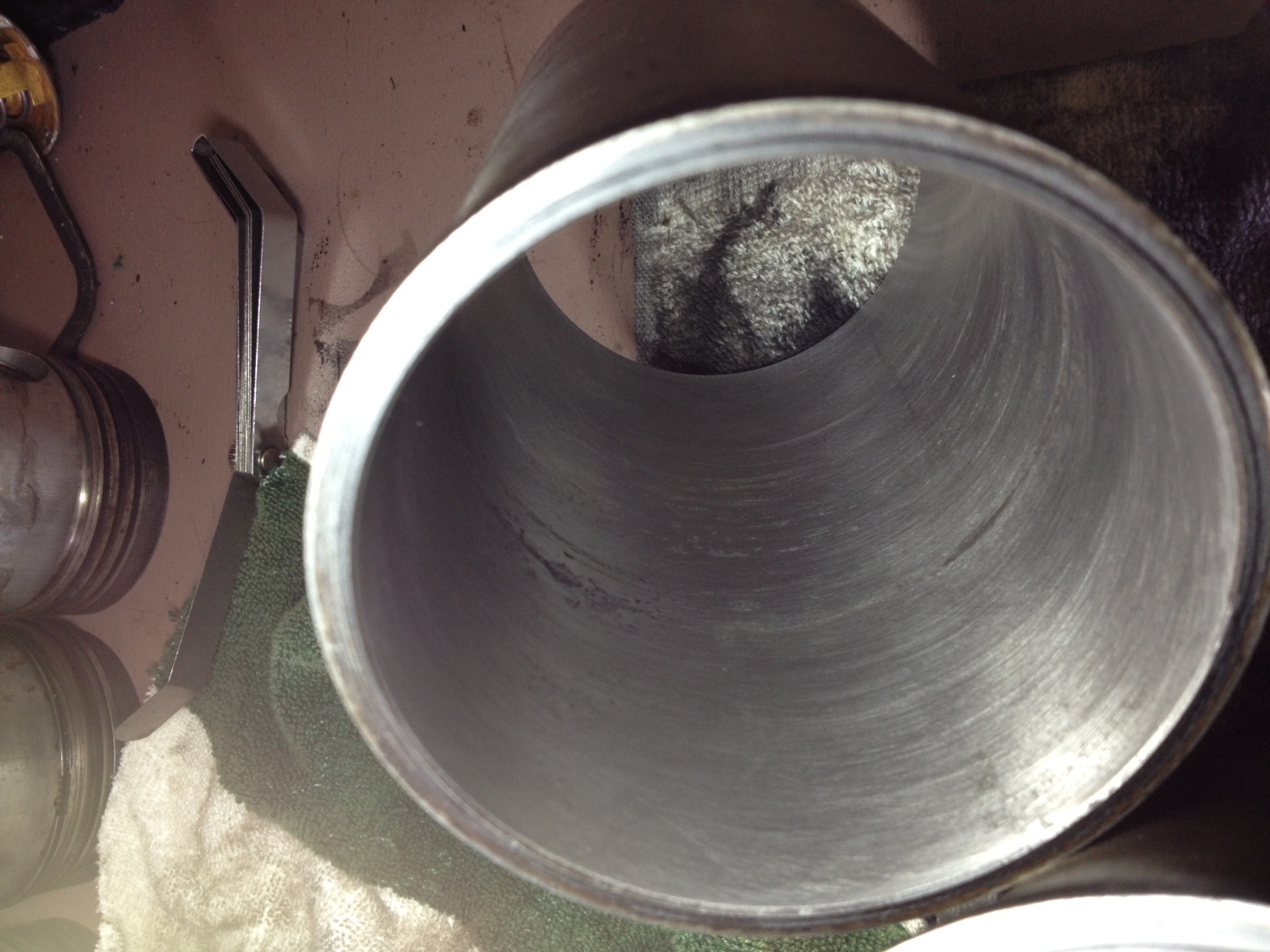

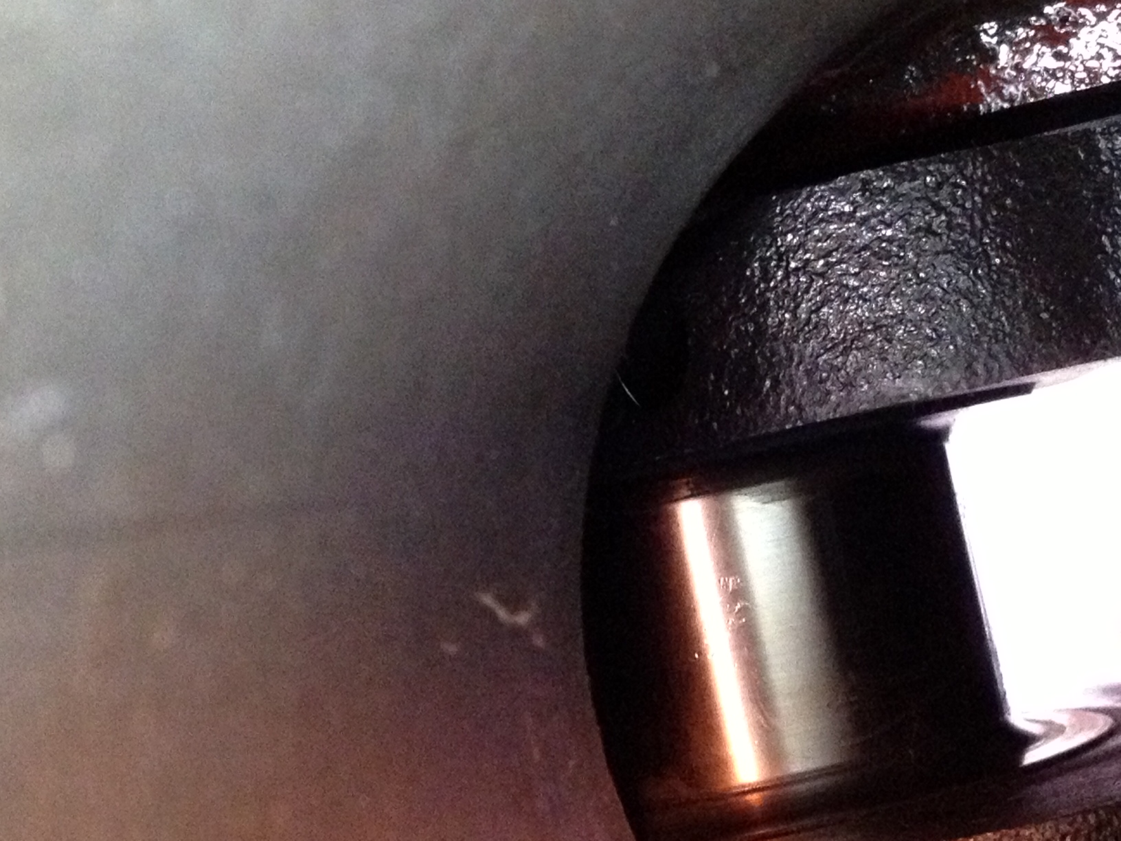

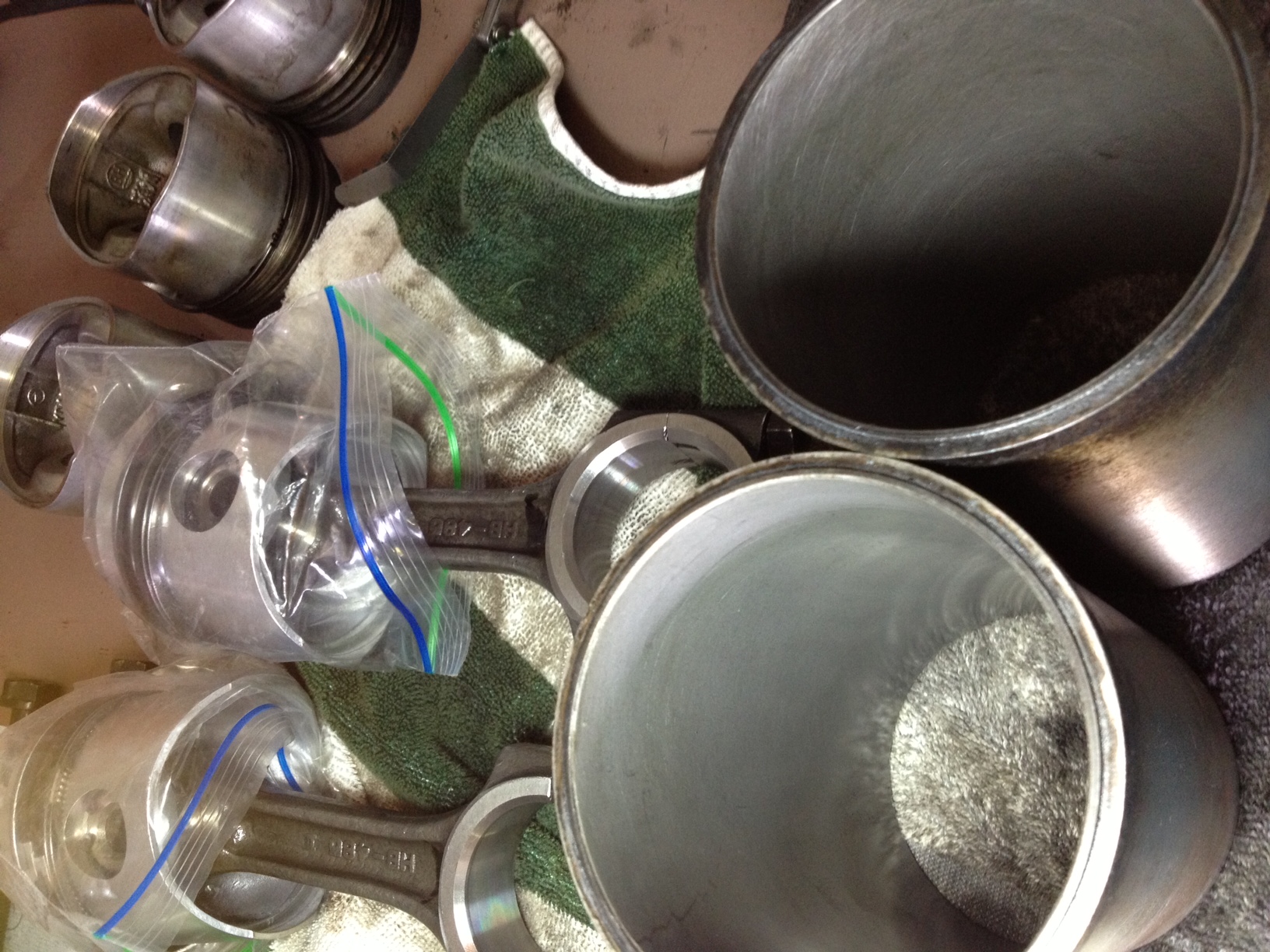

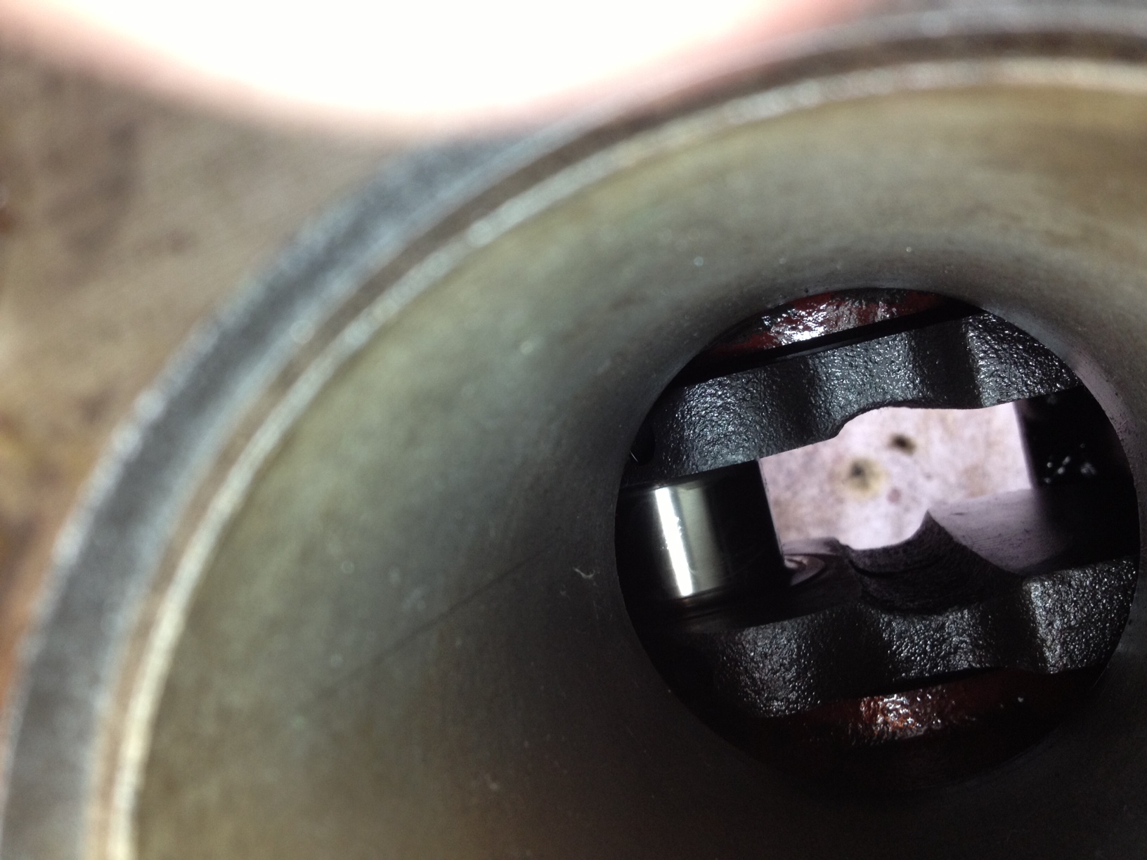

well when it rains it pours hahaha< I did some measurements on the sleeves today and the ring gap on cyl 1 and 2 were .305mm or .012in on the bottom and .254mm or .010in on the top of both sleeves, that is within spec so that was good, but sleeve from cyl 3 was in such rough shape i couldnt hone the ugly out of it so im gonna have to get a new one, it kinda looked like the sleeve was ate up from water or some fluid left on the cyl for some time it also looked like the po would turn the motor over a little and let it sit for a few months at a time and it would let the fluid work on the sides of the sleeve in diff spots, ill add pics of it, also i think a toothless redneck from the foothills of ky with a tool bag with nothing more then a hammer a screwdriver and a cresent wrench in it worked on this tractor before i got it, or maby this is how they come from china you guys will have to tell me if this is just normal for what you see when you open one of these up, and if its workable, I found a scrape on the jurnal for cyl one it looks like someone hit it with a screwdriver, i cant really feel it but i can see it, i ran my fingernail over it and couldnt feel it, ive added a pic of it and also between cyl 1 and 2 there is a spot on the block, right next to the sleeve were it looks like some moron took a chisel to get the sleeve out, I also added a pic of this, is this normal chinese workmanship or did bubba with a six pack of bush beer get in here before me

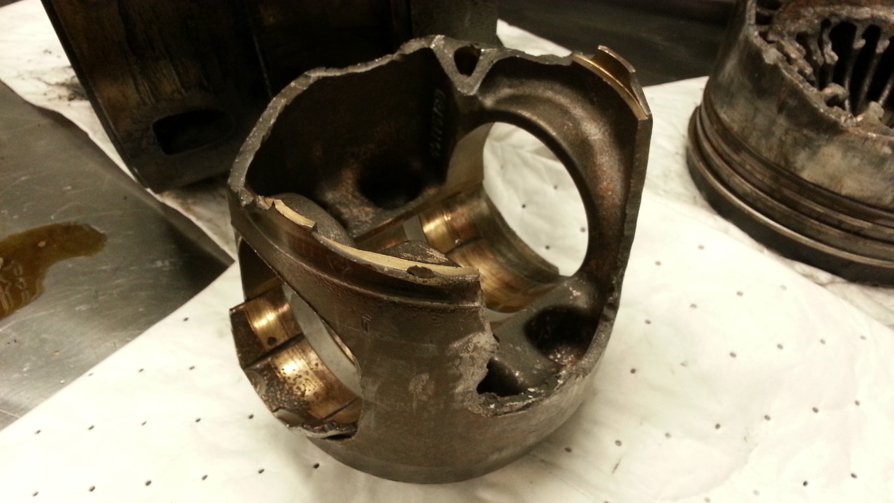

You think you're having a bad day? These engines cost about 10 large per cylinder to rebuild. We have sixteen.

yea that looks like somthing got real hot and came to a sudden stop and didnt want to

Okay, Bob wins the Bad Day prize. (grin)
Yeah, that looks like the one cylinder liner had water in it for a while just sitting there. I'd replace it for sure, otherwise you're bound to chip a ring on it. I'd guess that happened after he overheated it and blew the head gasket.
I wouldn't sweat that little scratch on the con rod journal if it was mine, but then I'm cheap. Lazy, too.
