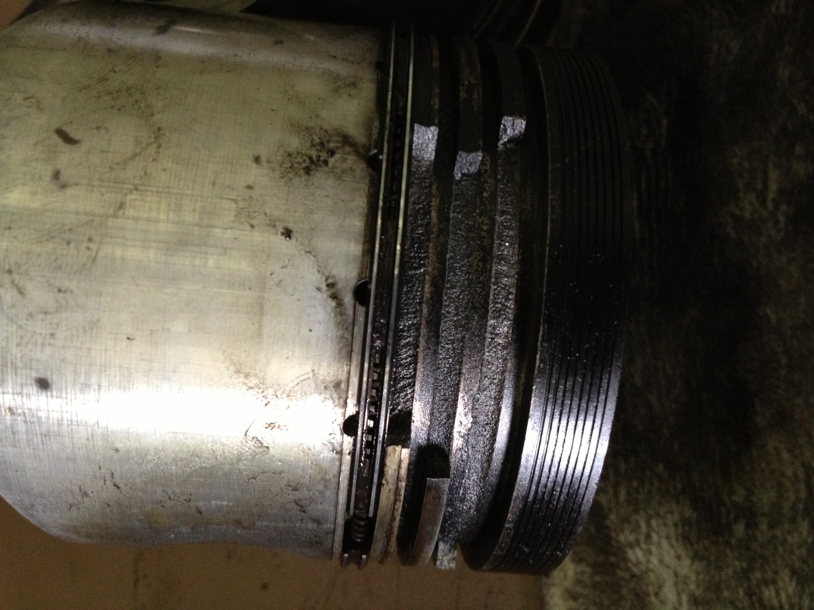

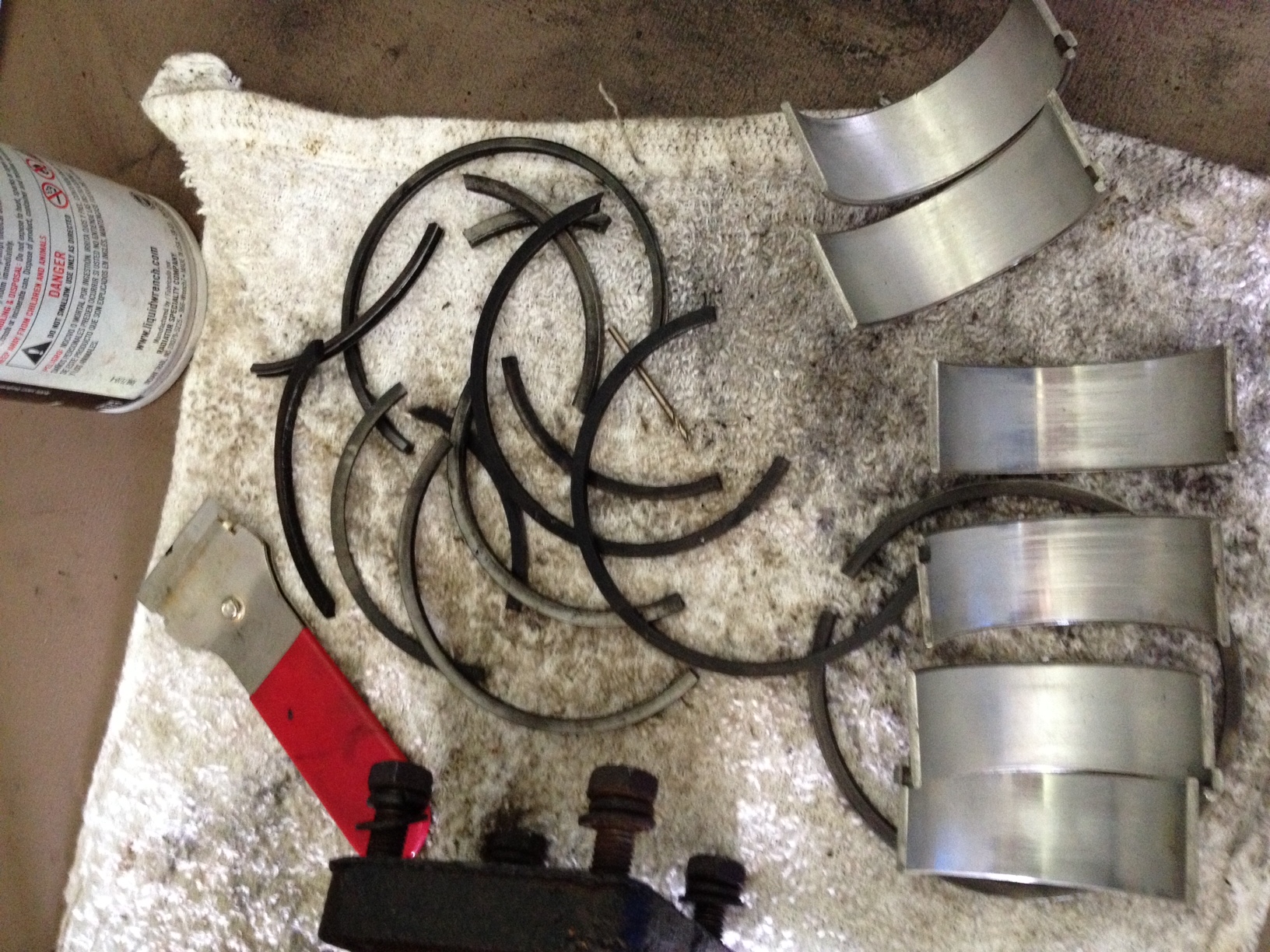

well went out and pulled piston no2 in the center that had 455psi comp and guess what all the rings were all good, but theres more, the piston was broke in between ring 1 and 2 so it deff was a good idea to change out all three or i would of been doing this all over again, what do you tighted the rod bolts down to when putting it all back together, Thanks again guys

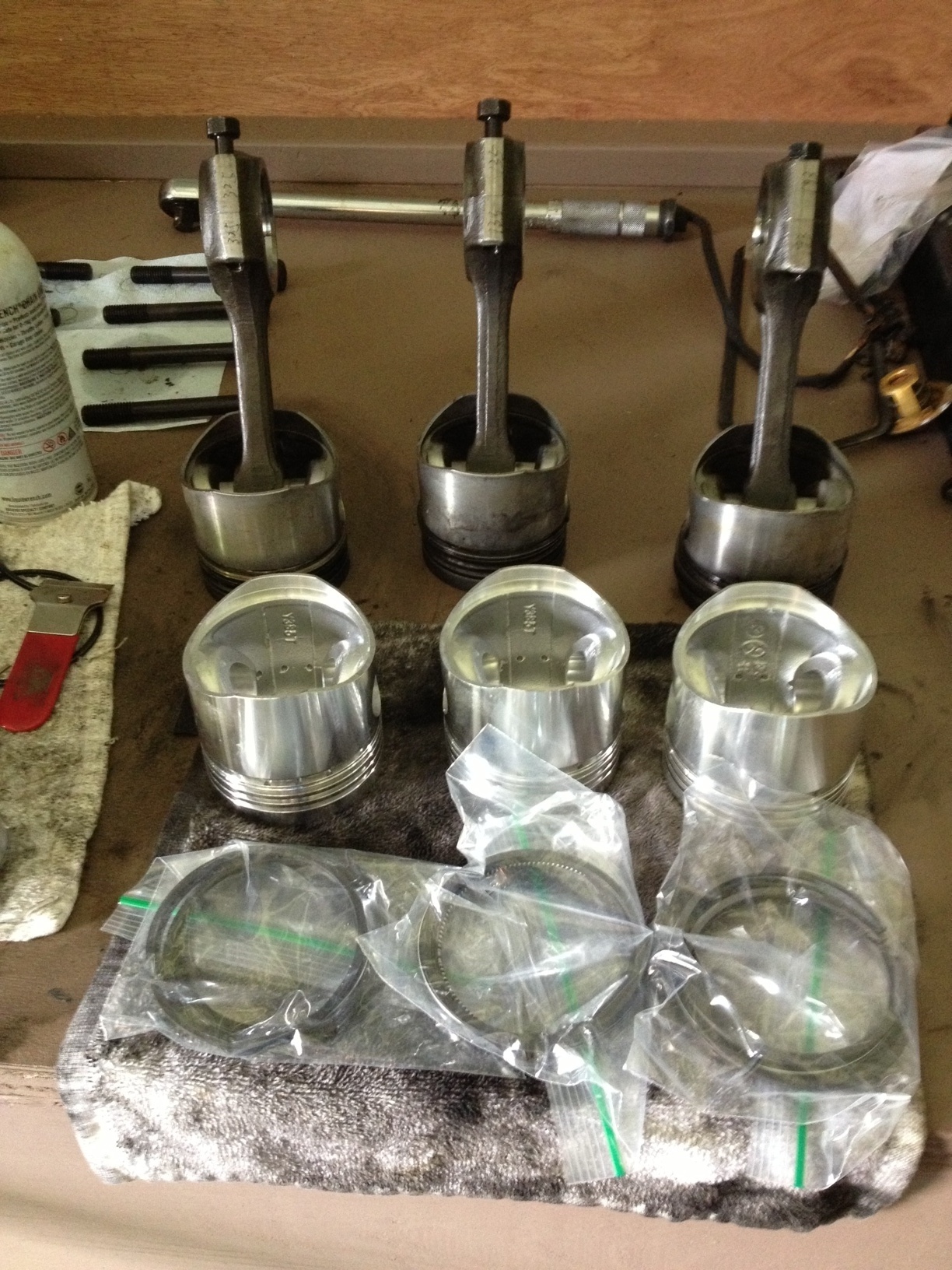

heres some pics of the broken pistons and rings that were in the 385 and the new pistons

well i got the new pistons and rings put on the rods today and got the liners out and had enough time to hone 2 of them, before it started to rain hard with a lot of lighting and theres no were better to be then in a 1000sq ft metal barn so I called it a day, ill post some more pics tomorrow, I know there prob the same but the new pistons said y385 inside of them and the ones that were in the tractor said 485 inside of them also I dropped a ring into both of the sleeves before and after honning and there was almost zero gap in the ring opening is this ok or should there be a small gap
The 385 is the 3 cylinder version and the 485 is the 4 cylinder version. They use the same pistons.
