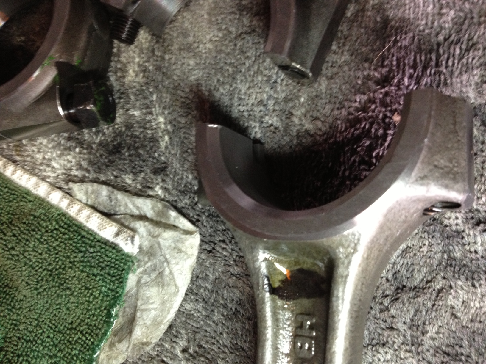

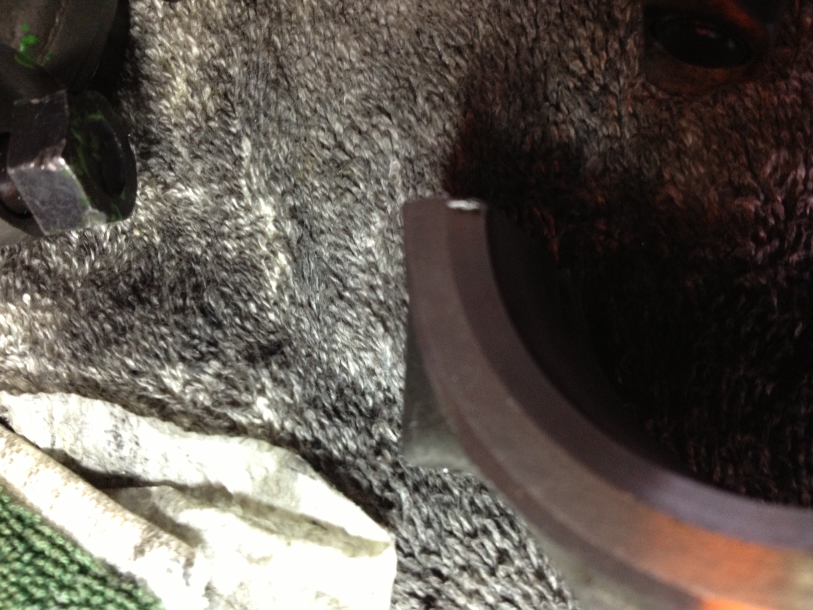

hey greg im gonna do that, i just went out and drained the oil, pulled the drive shaft dropped the oil pan and pulled the rod bolts and looked at the bearings they looked very good they were not squashed and shinny on the sides, and i re-installed per my book at 68 ft lbs, (I had them at 80 before) my screen for my oil pickup had a bunch of crap on it so i cleaned it also, got it almost all put back together but i have to go back out and put the oil back in it and tighten up the driveshaft center support,

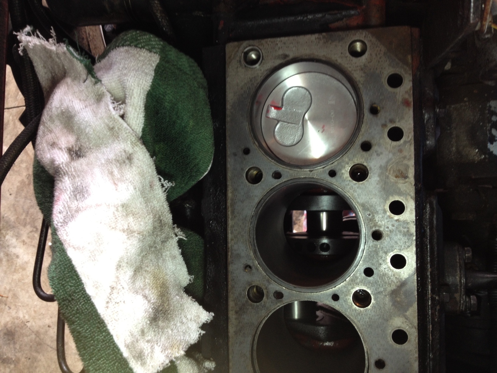

i think i have a blown head gasket, this last time around i thought i smelled that cooking antifreeze smell but my temp was good, and i looked and saw bubbles comming into the catch tank (bottle), im too pooped to do a comp test but ill do one tomorrow, I cant see how i screwed up that gasket but i guess stranger things have happened, o and after cleaning off the oil pump screen now the pump starts out cold at 70psi

hey greg im going to try that tomorrow before i take the head off and look at the gasket, I hope i find a dry filter
