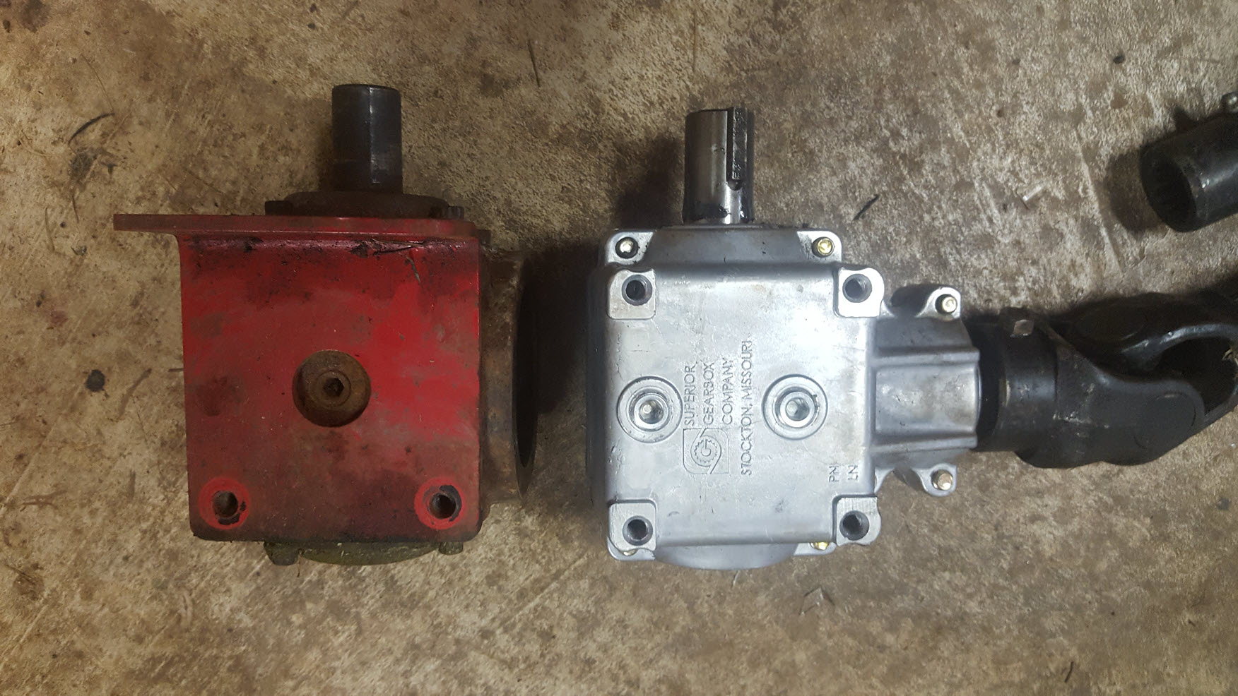

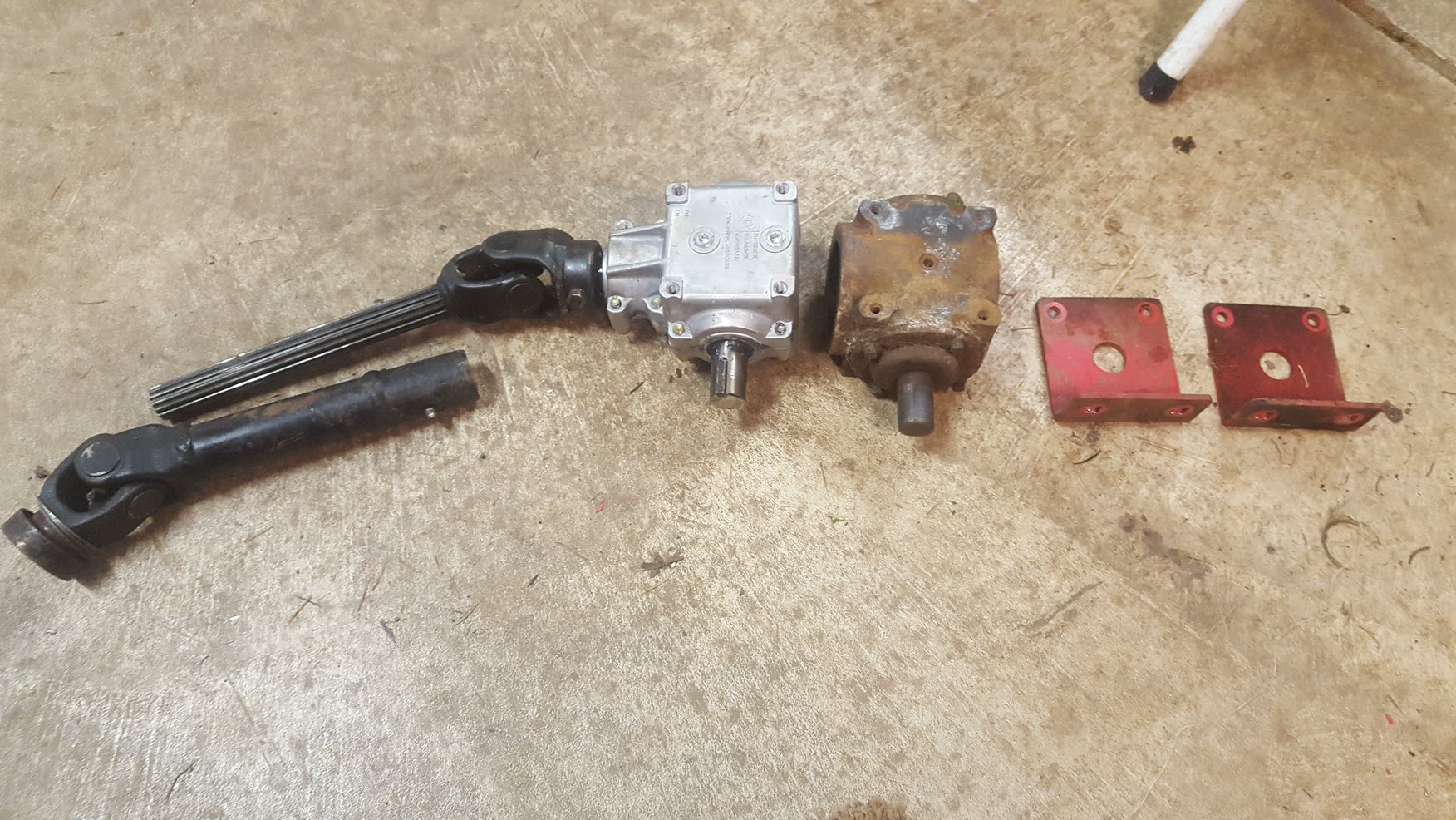

I should have paid more attention. I burnt up the main gearbox on the 60" MMM on the MAX. The little voice inside my head was telling me there is a service point there, and I didn't listen. I cant count how many times I have had this mower deck out to do maintenance, and been through the manual many times. Somehow I missed it...
There is a service kit listed (seals and bearings), and could try and rebuild it, but it is pretty cooked inside. The gears and shafts look fine but I don't trust them as hot as they got. Looks like a $575 list price mistake I wont be making again.

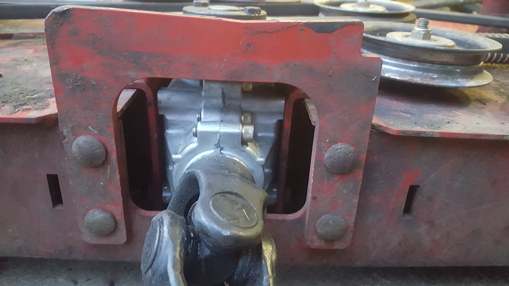

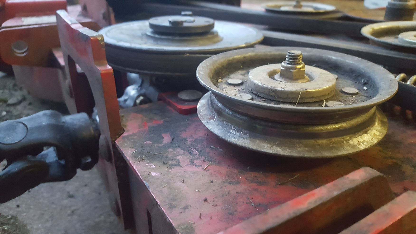

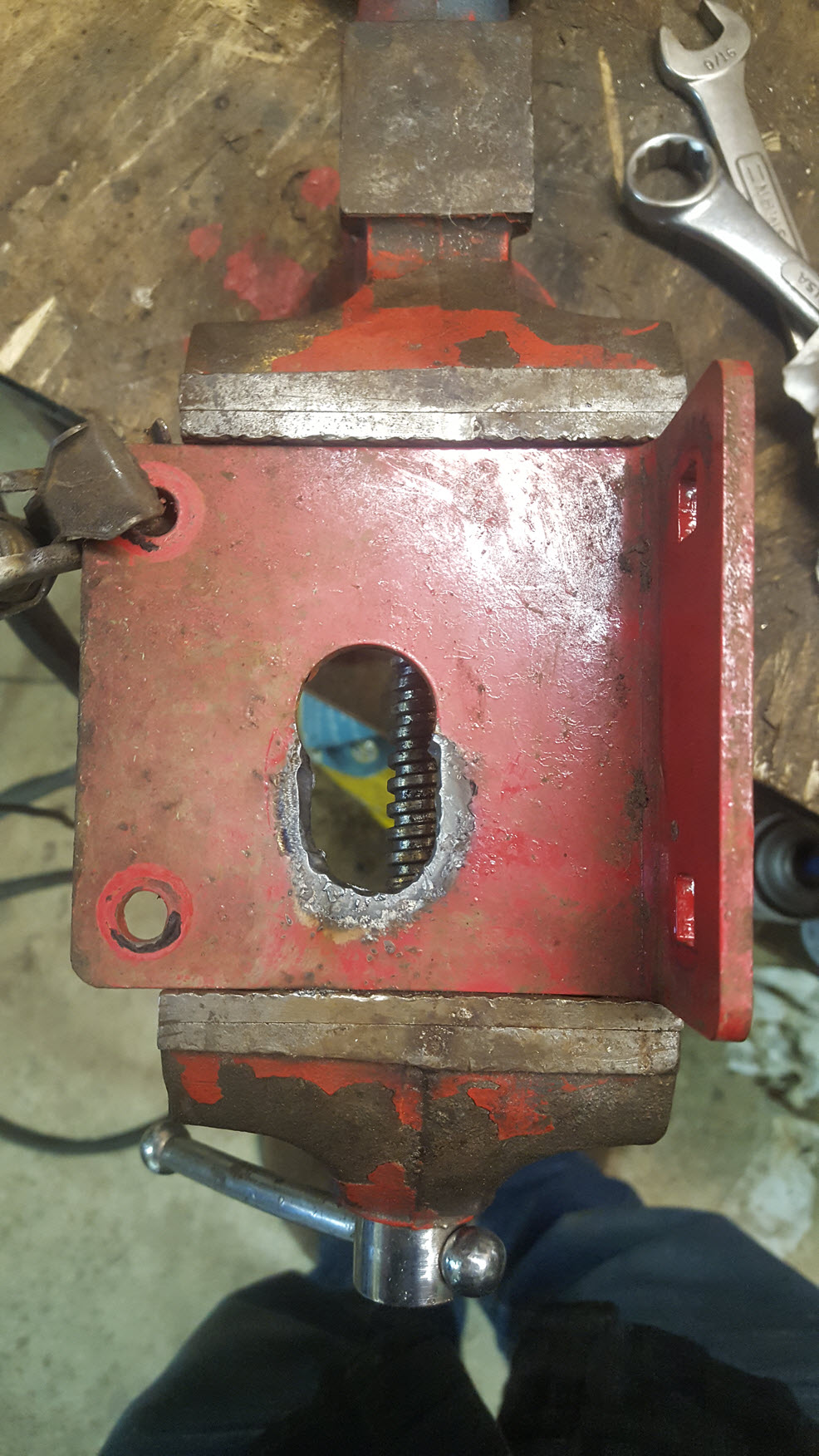

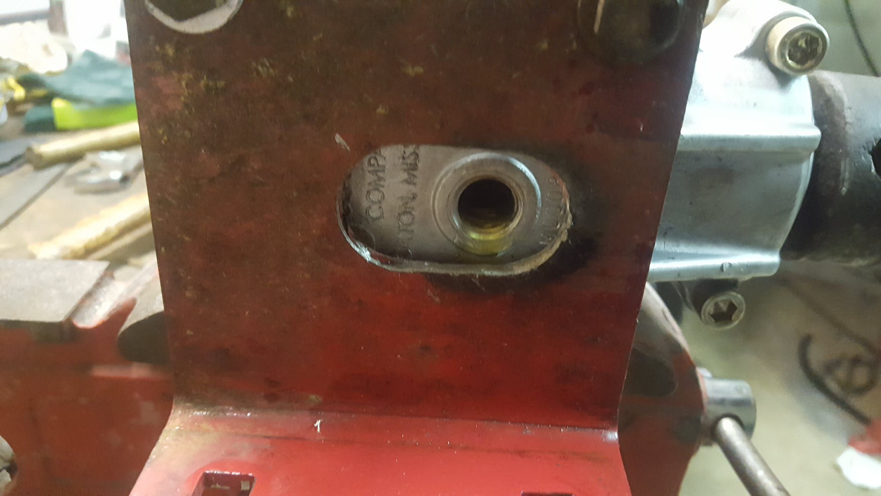

Well, Mahindra pulled a fast one on me. The good news is I got the new gearbox and in a timely manner. The gearbox however, is not the same as the original. The fit-form-and-function appears to be the same. Well... Almost... not without a little modification. As you can see by the photos, the oil check/fill plugs are in a different location than where the original hole is in the mounting bracket. So out comes the plasma cutter and die grinder to finish. There are actually 2 holes per side on this one, and I am covering one of them up. I don't think that's an issue because you can still add oil up to the plug on centerline with the shaft. (Hope that's right.) Bolt up, install pulley to dimension, and all is good. No sweat! But it would have been a nice to have a bulletin or instructions included.

I am posting this for those that don't know about phasing u-joints.
On that drive shaft, lining up the zerks when you slide it together, should put them in phase.
They are laying 90 degrees out of phase in your picture, that is what made me think about it.

/ Dont ask me how I know #14
They will vibrate when the shaft angles are like this.
The theory and math formulas are above my comprehension, I just know on my TORO Groundsmaster, it vibrates if I slide it together out of phase.
