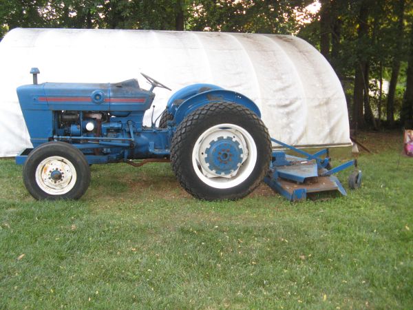

Hey Gents...I'm looking at a Ford 2k that has turf tires on the rear. I'm wondering whether the turf tires have any downside...I plan to use the tractor primarily for cutting hay..TIA
   / Don't even know where to start #46
Well, others may correct me but turf tyres have the least traction of the three tyre types. Lightest footprint but worst traction.
as long as you don't need agressive traction diamond tread sand or turf tires are fine.. good flotation. I have a few machine with turfs.
be aware that many turfs are on 24" rims not 28" rims and are quite pricey when you go to repalce them.. but don't let that dissuade you from a good tractor deal.

Thanks Soundguy...did you mean that if I decided I needed diamond tread at some point that I'd need to replace the rims and the tires? 5L55H35Je3Fb3Le3N8c7h51d14ba96cab1ca9.jpg
One more q ..if you would...according to tractordata.com the 2k has a non-synchronized trans. Not sure if that's the only trans it was sold with... do you? I've never owned a car with an auto trans but all were synchronized manuals...Any insights about the unsychronized trans...is it for pulling heavier loads? ...is it an economy trans?
   / Don't even know where to start #50
Thanks Soundguy...did you mean that if I decided I needed diamond tread at some point that I'd need to replace the rims and the tires? View attachment 275539
All a non synchro means that you can't shift while moving. With a tractor you start in the gear you are going to use. You just need to feather the clutch. Sound guy seems to be quite familiar with the Fords. transmissions will be different on different models and submodels of a series depending on how the tractor was specced.
If you haven't operated a tractor before it is a short learning curve. If you have "machinery sense" you will listen to your tractor with your ears your hands and the seat of your pants. You will soon learn when you are stressing our abusing your equipment'
If you have turf tires you would not need a diamond pattern or vice versa. Used tractor rims are quite cheap and readily available. The only change I could imagine you making would be to an Ag tread. With 2wd you only need to change the rears.
