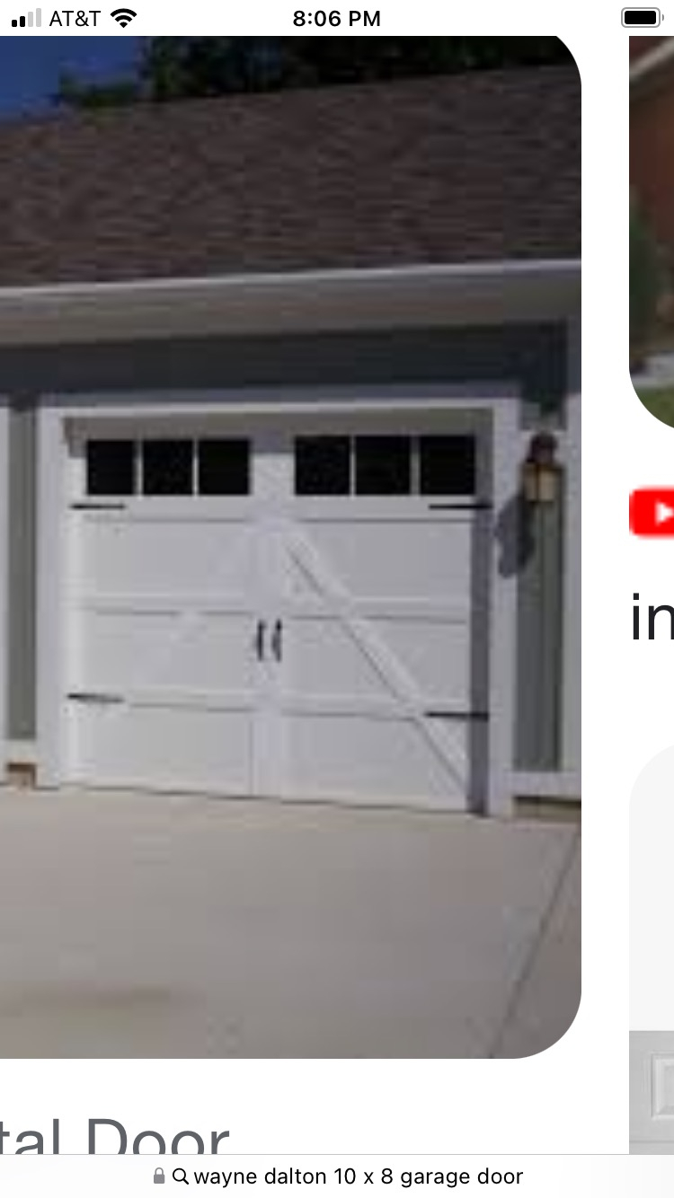

Wife picked out the sectional door for the barn. Of course we know who will be doing the install!
