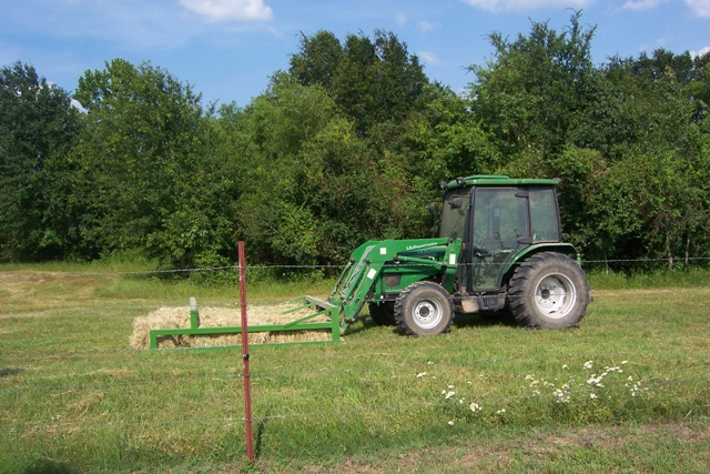

Mines a SSQA on front of the FEL ... Accumulates 10 bales I have had no problems with dirt, rocks or debris.
The grapple and accumulater are the best thing for square bales. And the two cost less than just the drag type accumulator.

blue river how easy is it to see from the tractor cab . this is what im concerned with on the one i bought thanks

The grapple is a little harder than the accumulator only because you have to be pretty acurate to load the bales tight in the field and unload in the barn.
You'll get the hang of it pretty quick. You may know this already, the accumulator will not make the stacks that tight ...you will need to sweep in from the side and push forward and then use the hydraulics and they will squeeze together tighter than anyone can stack them.

Curious about now much money you had in material to make both accumulator and then the grapple like you have. I'm interested in getting my neighbor to make them for me he has a welding shop. Looks pretty slick

Nice lookin outfit! thumbsup:

I bought the grapple cause it appeared to be a little more than I could build ... I have about $485 in the accumulator material and 12 hrs of labor.

Let me share with you this is by far the best thing I have done to my hay operation.
When I went with the smaller 4x4 round baler I thought they would sell and found out I can sell more smaller bales for more per bale than the big ones ... yes more bales to bale per acre, more bales to load and haul ... but last year before the price soared becuase of the drought I still sold for $45 a bale and my neighbor with 5x6's was getting $35
Then the year before folks started calling for square bales so I decided to proceed forward and with the lack of labor available I knew I needed to find a way to cut out that labor ... when I sell the square bales I give my price per bale and then tell the customer we will load your trailer for 50 cents a bale ... did not have anyone say that they would load it.
