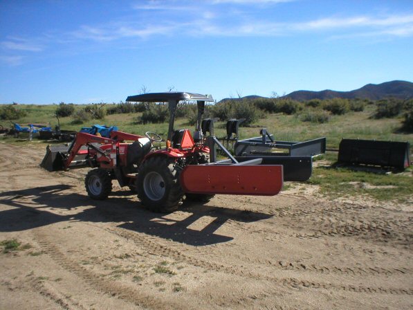

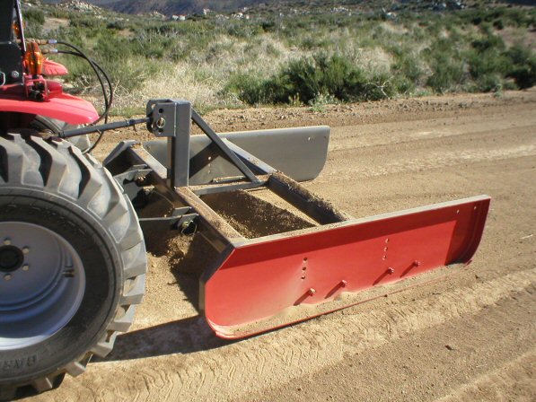

In my opinion, you will be better off with the 60" unit. That is what I run on my 3215 and at times is all it wants. As far as the technique that works best for you and your conditions, I honestly can't say what will be best for you. I do up, down and in the center without any problems, but that is with my conditions and type of material on the road. (DG)
   / dragging my driveway #24
What is vitally important for grading a road with a grading scraper is that one side of the skids stays close to the center of the road as you travel. If it "hangs over" into the wheel track on the opposite side of the road from where you are grading, you will wind up scraping off the top of your crown. It will work fine if your scraper is a bit narrower than the road. You can make multiple passes if needed.
The way most scrapers are made, you want the right side skid to be right at the outside edge of the road, or just slightly past that if you have any ditch or your road surface is elevated a bit from the base. I set my blade carrier so that the right side blades are just a bit (3/8"-3/4") below the skid so that it just takes a moderate "slice", and so that the left side blades are just slightly above the skid, meaning NO cut to the center/crown. Since my scraper is a foot too wide for most of my road, I have to be very careful to set adequate tilt on the lift arms and just have the tractor mechanically hold the left side up. Confused yet?

Do be aware that you will need to "set" the "blade carrier" on a LandPride to your liking. They have 3 large bolts/nuts on each side that attach the carrier to the frame. I found that the easiest way to set mine was to loosen all 6, then set the whole scraper down on a nice flat smooth surface with strips of wood the correct thickness underneath each skid. Or under the outer edge of the blades themselves if you want them above the skid. Then securely tighten all 6 back down. An impact wrench is nice as they take about 100+ ft-lb.
