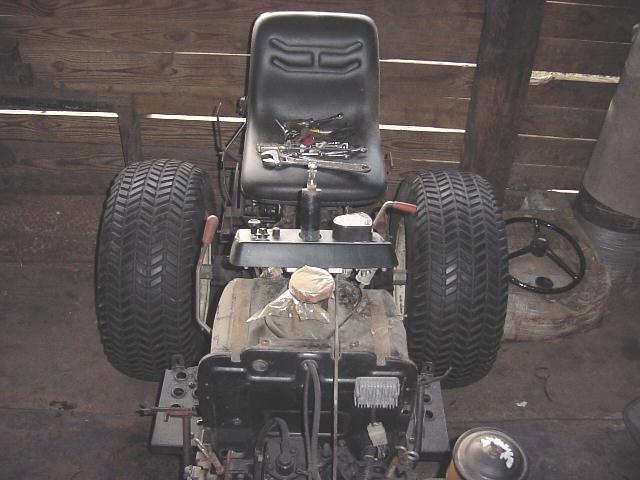

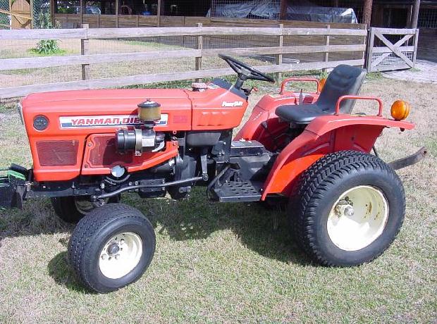

Thought I would share my latest project with you all, this is something I've wanted to do for years and didn't have the know how or time, heck I still don't have either but I'm up for a good stab at it. I don't hear much or see much about this little tractor maybe it wasn't that popular back when Yanmar was sellin' them here
Anywho a big thanks for the guy's from this site that have helped me with my learning curve to start this.
First pic is the starting point, not to shabby but could look better

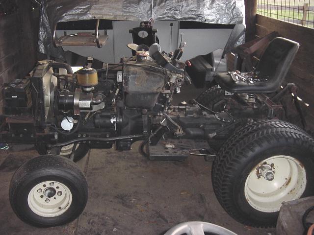

Kind of naked, still need to keep at a point where I can start and drive it being I'm doing th work next door at a neighbor's old chicken barn, and I don't want to push or pull it over there.

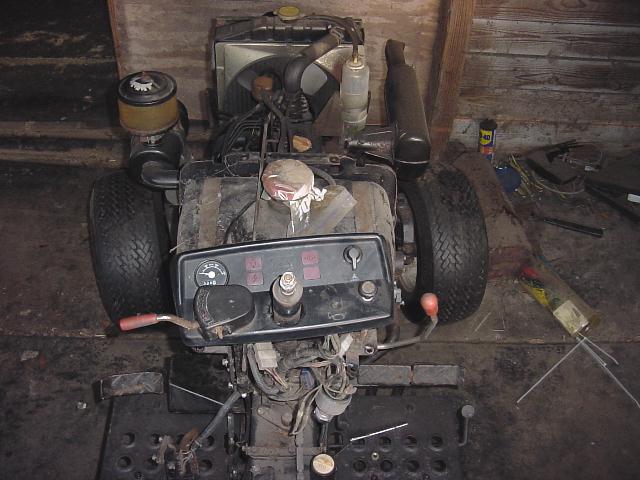

more nakedness

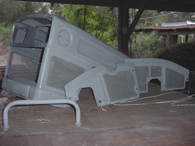

Some sheet metal primed, but I blundered and didn't cut my primer and got a little "orange peel" so a little sanding in the morning and hit it with another coat.

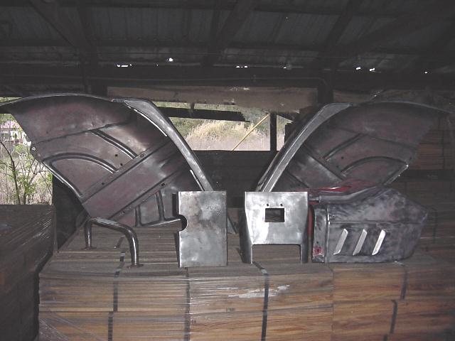

last one for the evening. the rest of the sheet metal stripped and waiting for a coat of primer in the morning.

Whiskey,
It looks pretty darn good to me so far. Hard to see anything in prime. Have you decided on a color, colors?? Going back red, black and white?
Keep us posted......can't wait to see more pictures.
Regards, Mark
   / dressin' up an old YM187
Re: dressin\' up an old YM187
Mark:
I'll replace the red/orange with Massey Ferguson red and maybe some of the brackets under the hood, gloss black for the tranny & motor and a gloss white for rims and grill.
