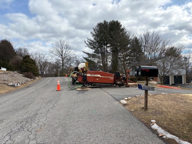

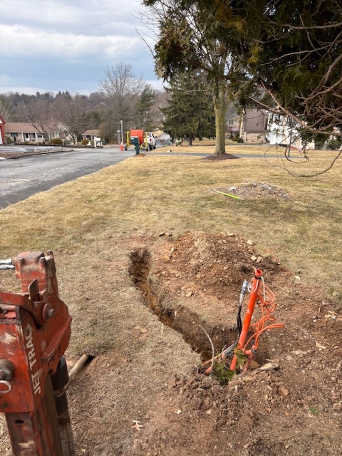

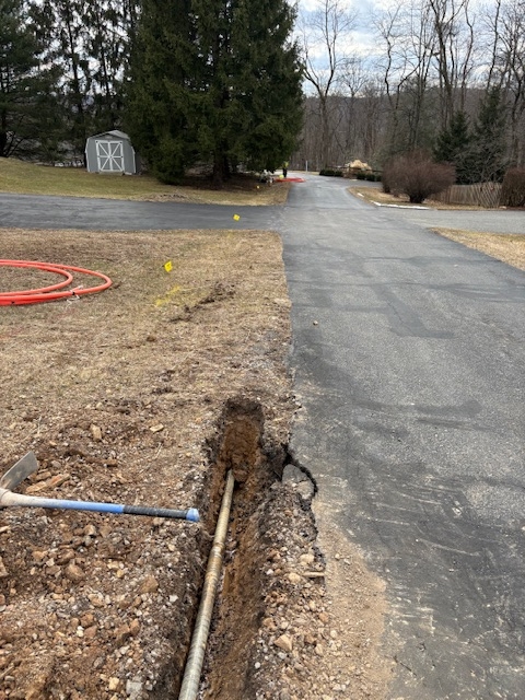

The the ground has been frozen or then frozen and top melted(0 traction). So I’ve been almost only drilling. Here are a few pictures.

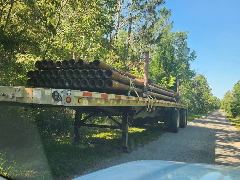

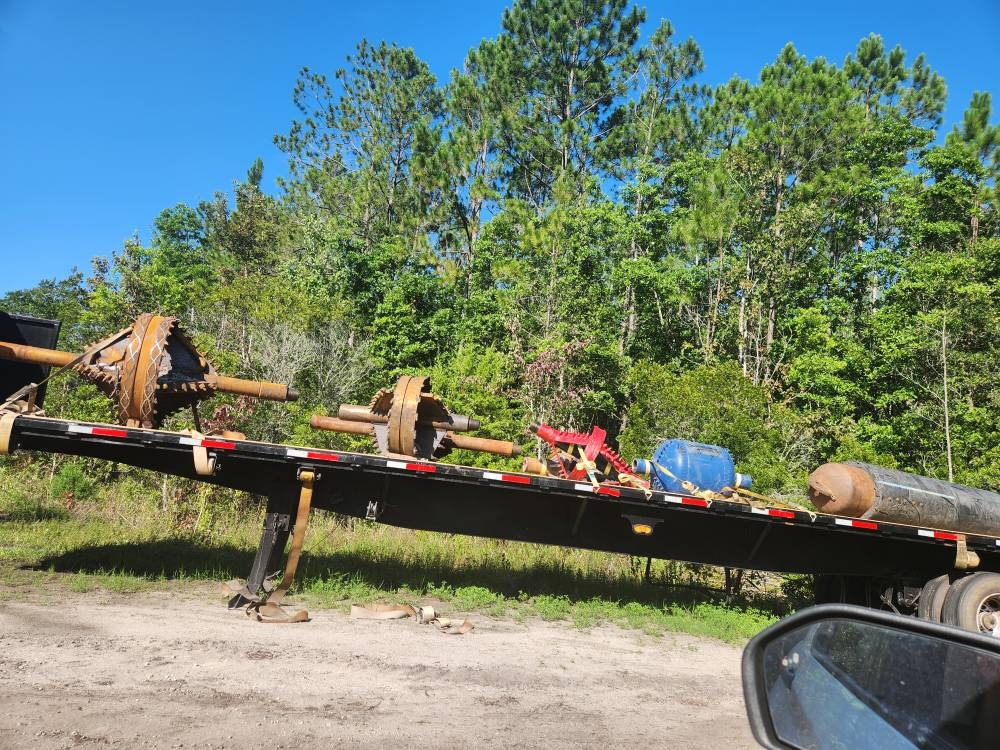

Rods and reamers staged near exit pit.

Big stuff. Wonder how many gallons of water they will us on that?
This one is a 30" at about 1400LF. So, a ton.
We also have a different one coming up, about 65 ft deep to clear some bridge fender piles on a creek/river crossing, and they are flying in a special, not for sale yet, locator. Pretty sure on that creek they are using a pretty normal sized machine, in the 40T class.
