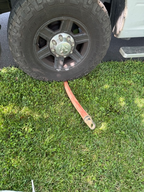

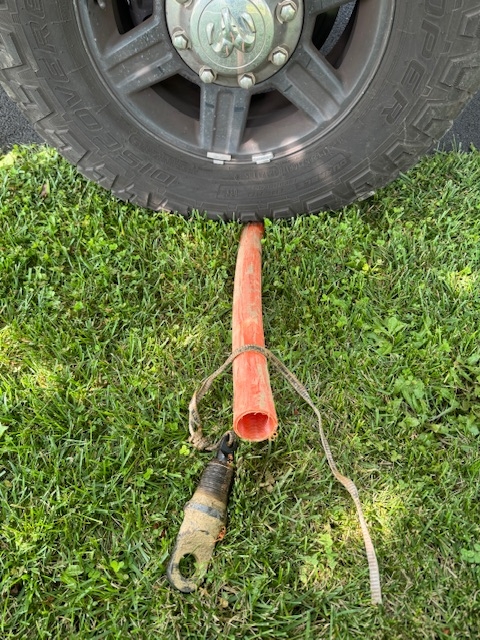

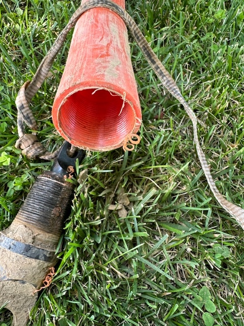

The carrot is amazingly strong. This and a 3ft breaker bar through hole is the only way to hold them to unscrew them.

I see guys use either a carrot or Chinese finger traps. The carrots last a lot longer, but I don't know your experience; but if you say deal with 1.25 Dr13.5, 1.5" dr9, 2" dr13.5, ect, ect; you start needing to carry a lot of them. That really is just an issue for the guys that might do a 2" water service on Monday, a 3" gas on Tuesday, 2-2" telecoms on Wednesday and 3-1.25" telecoms on Thursday.
There is one newer fiber provider doing a larger install, and I thought it very odd, 2-1.5" and 1-1". Dealt with many that do 3-1.25, or 2-2"; but never one that mixes sizes in a single bore.

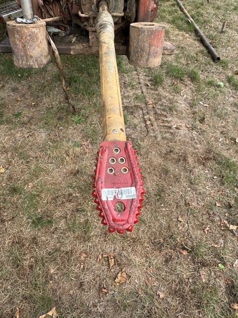

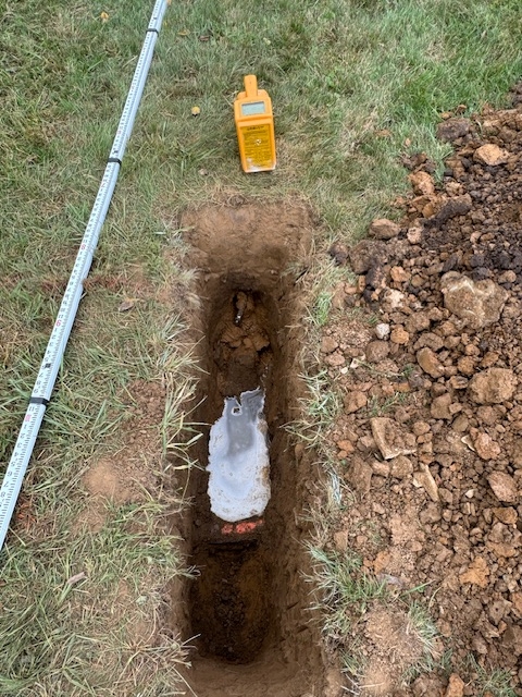

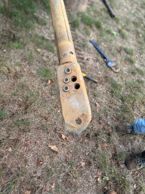

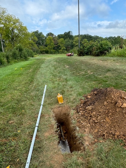

The first duckbill was for sand/clay. I think I lost those teeth on the first drill in PA. lol.

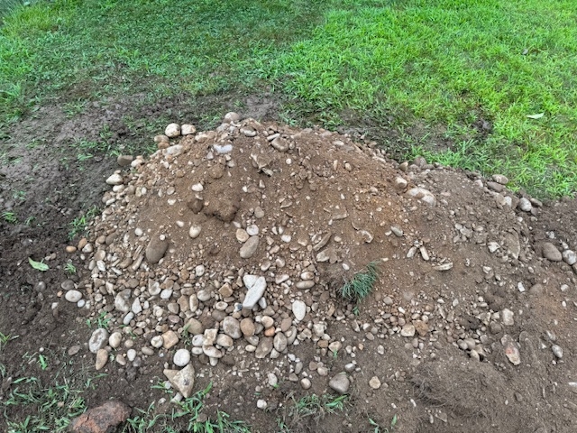

This the best dirt I’ve seen here. Most is more rocky. I’ll get a picture later some are basketball sized.

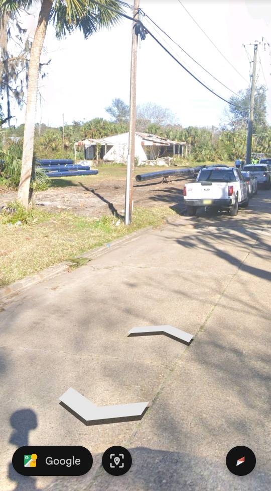

We aren't really supposed to share pictures taken at work, because technically, they aren't ours. However, the Google Earth car drove by, and I pulled the street view up. I believe this one is 16" HDPE at 700LF, behind a 22" reamer. Got a 12" steel, at 4000lf coming up next week.

The Google car even got the pipe fusion machine in the street view

The money$$$ per ft to drill/pull that must as be high as Elon musk.
