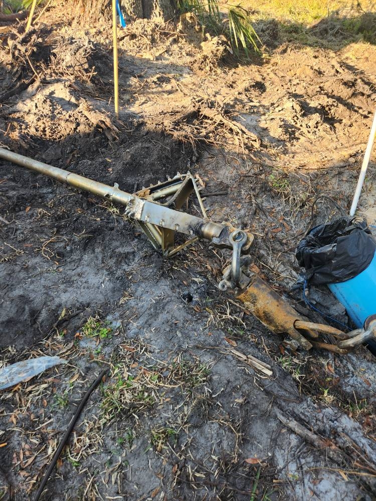

So, a question I've wondered, but never bothered to ask, 90% of the bores I watch, we used a solid reamer, but every now and again, we have used an open style reamer. Is it just cost of having a 16, 22, 30", ect, and the open type is cheaper, or do they offer an advantage in certain soils?

So, a question I've wondered, but never bothered to ask, 90% of the bores I watch, we used a solid reamer, but every now and again, we have used an open style reamer. Is it just cost of having a 16, 22, 30", ect, and the open type is cheaper, or do they offer an advantage in certain soils?View attachment 2396075
I don’t have an answer, everything I pull does not require any reaming. I just hook swivel to duckbill and backpull.

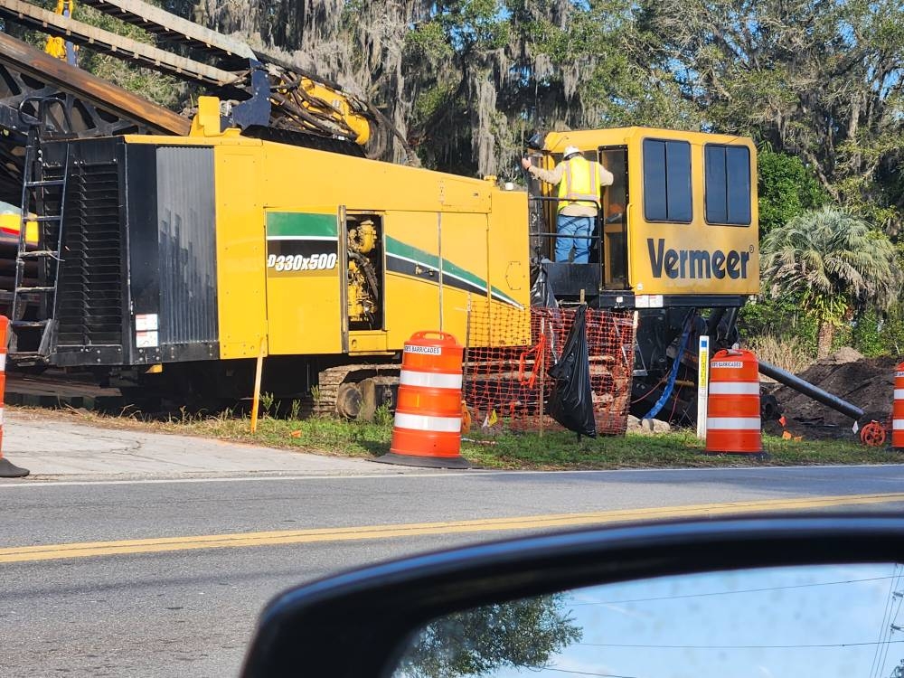

Today I'm sitting here watching a 1700lf HDD, 12" steel, using a Vermeer D330x500. For anyone wondering, it's not an exciting process, every single step is slow, from loading each individual rod, to changing heads/reamers, to initial setup.

Today I'm sitting here watching a 1700lf HDD, 12" steel, using a Vermeer D330x500. For anyone wondering, it's not an exciting process, every single step is slow, from loading each individual rod, to changing heads/reamers, to initial setup.View attachment 2578331
Thats quite a machine.

They also have a 3700lf shot, and they are going to try something I've never seen. One drill on the north end, one of the south, both drilling towards the middle, and at the meeting point, southern drills pulls out, and north drill pushes through the path created by southern drill to the south exit. I've seen a push-pull double drill, where they basically pass the reamer between them, but never a meeting point.
