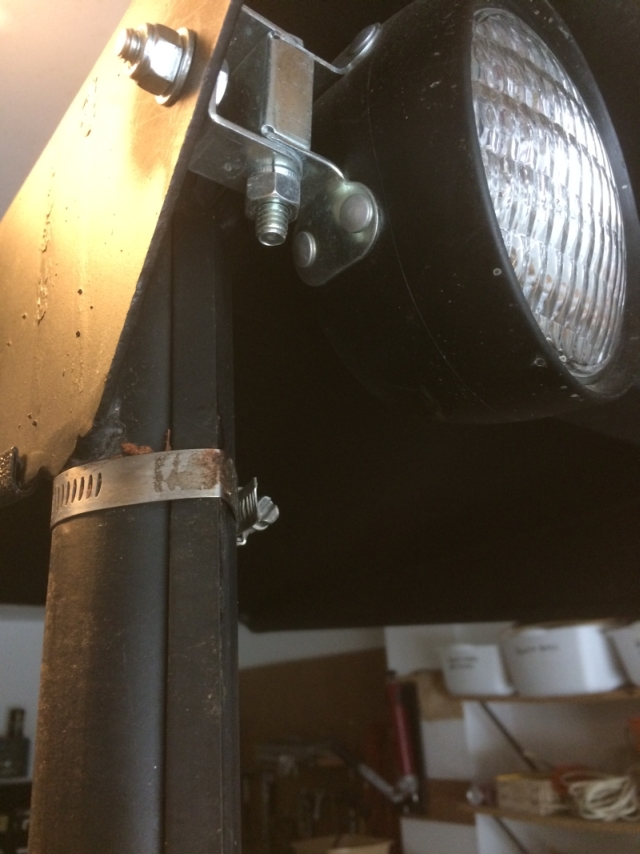

Below is the wire exiting from the hole at the top of the ROPS. The lights are mounted on holes drilled through the canopy. The lights are daisy-chained so only one power wire was needed running up inside the ROPS.

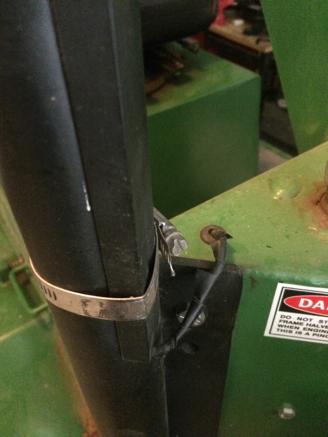

this is what I did.......ran wire up through existing grommet hole to outside of pipe.....got a piece of small steel angle.....painted it black and clamped to round post of rops to protect wire.......covered exposed piece of wire with electrical tape....been like this for 12 years with no problems.......moving lights up was best thing ever.....I can actually see now........Jack

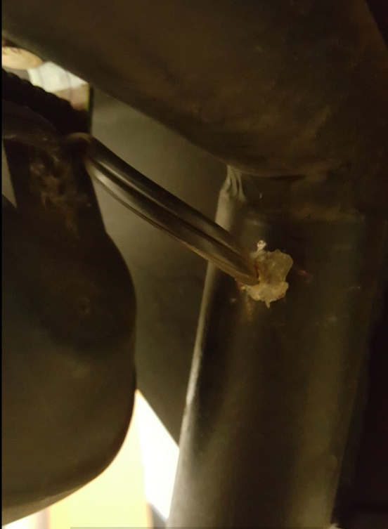

I use an entirely different system to secure my wires. Cable Ties do not hold wire in my hood. Too many tree branches in the cab, they always get ripped out.
I use Silicon calk. Black. I put a heavy bead down on the inside of the rops and then lay the wire into the silicon. I then put a ton more silicon on top of the wire, then lay a 2" piece of papertape all the way down. Let it sit overnight, then pull it off and let it sit some more. Works like a charm, hard as heck to knock off.
For mounting liights on the PT, I drilled into the lid / canopy and bought some LED Lights off of ebay. Having the lights up high makes a massive difference. Oh, my lights are hung underneath, in the cab. On the roof they would just be fodder for hungry trees.
