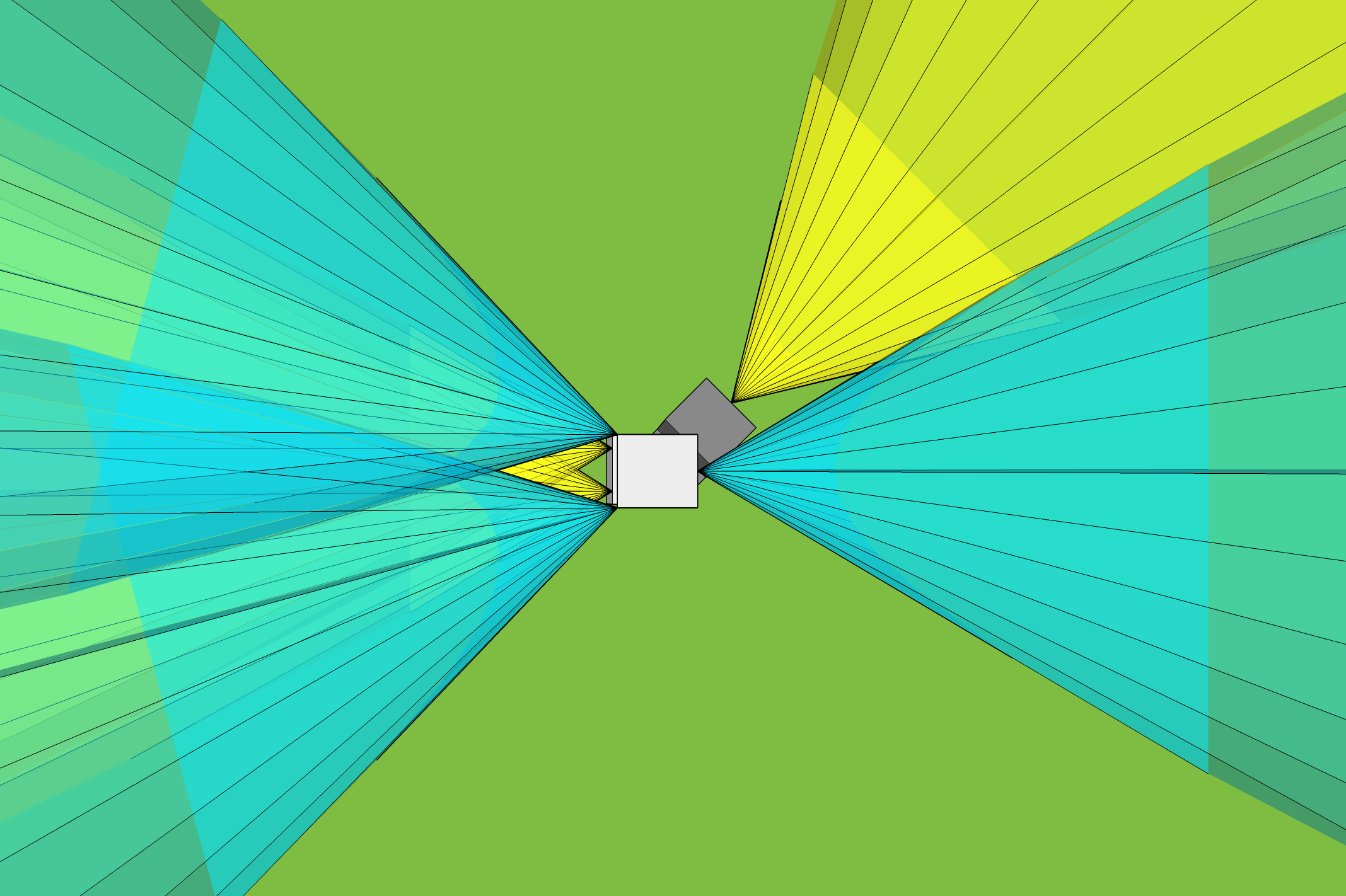

So I understand that this doesn't really apply to the mounting subject, but these are the lights I went with.
Amazon.com: Lightfox 8Pcs 18W 4Inch CREE Flood LED Light Bar LED Pods Fog Light Waterproof Work Lights Off Road Lights 4WD Truck Car SUV ATV UTV Jeep Pickup Boat Driving Lamp, 2 Years Warranty: Automotive
Figure I'll put the two up top, replace the two stock ones on the bottom. This way regardless of attachment being used and whether it is up high or down low, I should be able to see what's going on.
For the back, I was thinking on dead center on back of the canopy and one on the engine cover. The PT-425 with the EH72-2 has the upgraded power dohicky putting out 30 amps @ 12V (360W). I assume this is at full throttle. Each of these lights is stated to be 18W each, so 108W total. I assume these could also be put on a PWM dimmer if necessary, dropping the power requirement if necessary. This would leave 252W for the hydraulic cooling fan, charging the battery, etc. which I think should be OK. I understand this is probably overkill and I may add switches so that the tops, bottoms, and each rear could be turned on/off independently.
For the non-PT owners out there, this tractor articulates in the middle with the ROPS attached to the front section. When going in reverse, the ROPS isn't necessarily pointing in the direction the back half is going.
These pods have a 60 degree beam on them. With each of the front ones offset 15degrees both to the side and down and the rears just 15 degrees down, this is what I'm thinking I could expect.
The light gray is the front half / ROPS canopy pointing to the left, the dark gray is the rear/engine compartment, pointing to the right.
   / Drilling hole in ROPS of 425 for lighting wire? #35
Impulse, I used similar lights on my tractor's ROPS and they work great. I ordered 2 pair, and used 2 forward and 1 reverse on the ROPS which give me a LOT of light. I use the 4th one attached to a 'ground magnet' made for welding. I put a standard 2 prong 12v plug on a cord, and I can use it as a portable light around any of my mowers or tractors. Most of the time, it's on the front of my BCS 2 wheel tractor when we head out to our campsite. You'll love the lights.

I have two up and two down forward, and I almost never use the original two lower ones. I do use the one inside the engine compartment pointing backwards, as that's where the tractor is going. I didn't find back of the ROPS lights very useful to me.
Most alternators are able to put out full power at slightly above idle (~900-1000rpm). Cranking the engine can take quite a bit of power that takes awhile to trickle back into the battery, and fan usage can really cut into the tractor's power budget. My original lights were 55W (1445), so I cut the power usage by 2/3rds and increased the illumination at the same time. I think that you will probably be very happy with just two in front and one in the back.
