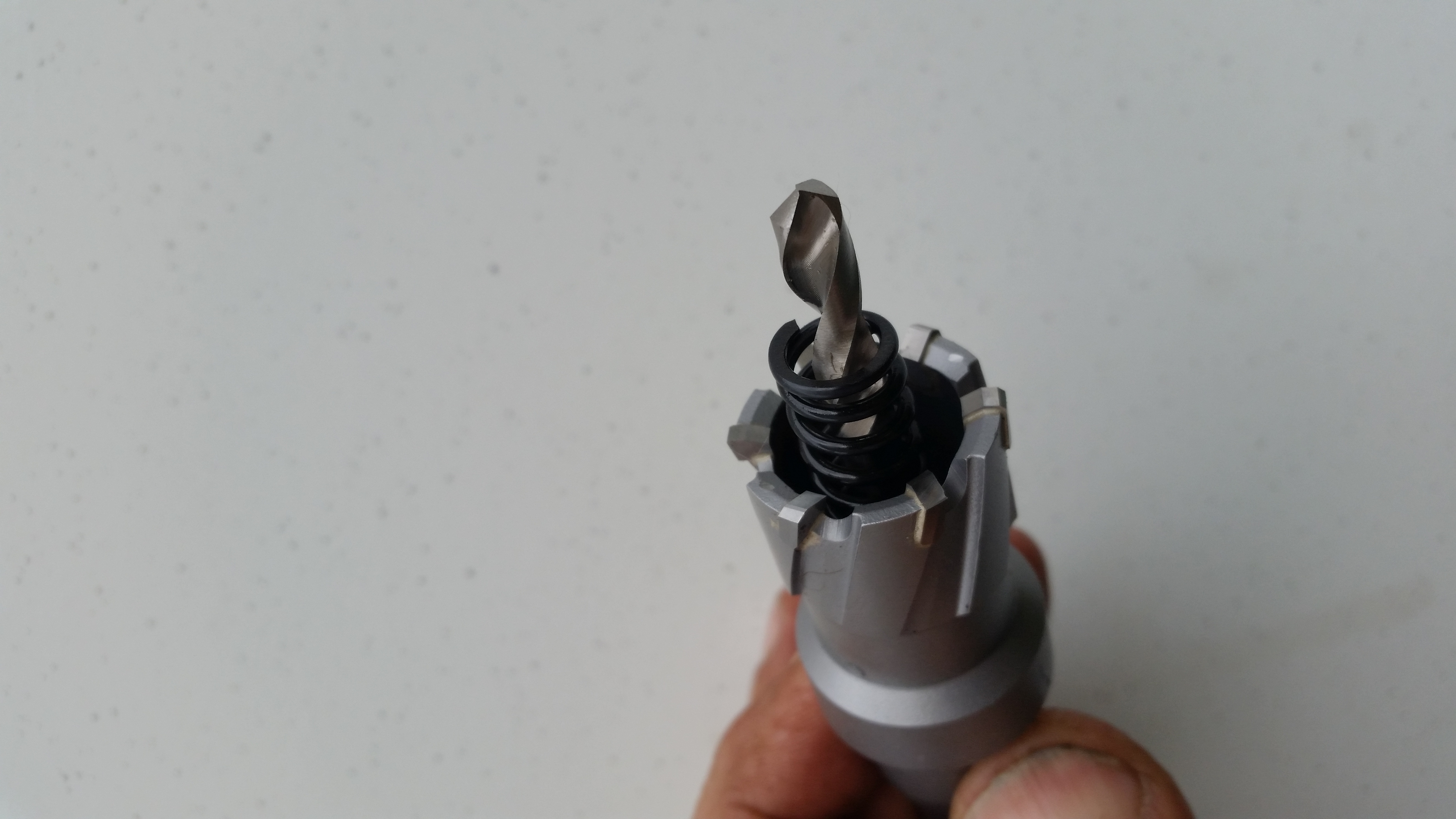

   / Drilling holes in steel #9
I bought these drills for my present project to drill for bushings mounted in box tubing with 1/4" wall. Works well with less torque needed to turn them. Bought these in 1 3/8" down to 7/8" sizes very satisfied with the results after using these to drill holes in tubing and flat bar. These will cut up to 1" deep but other depths are available.
This is the 1" size.
   / Drilling holes in steel #10
I have that style also. I use mine mostly for under 10 ga.
Terry
