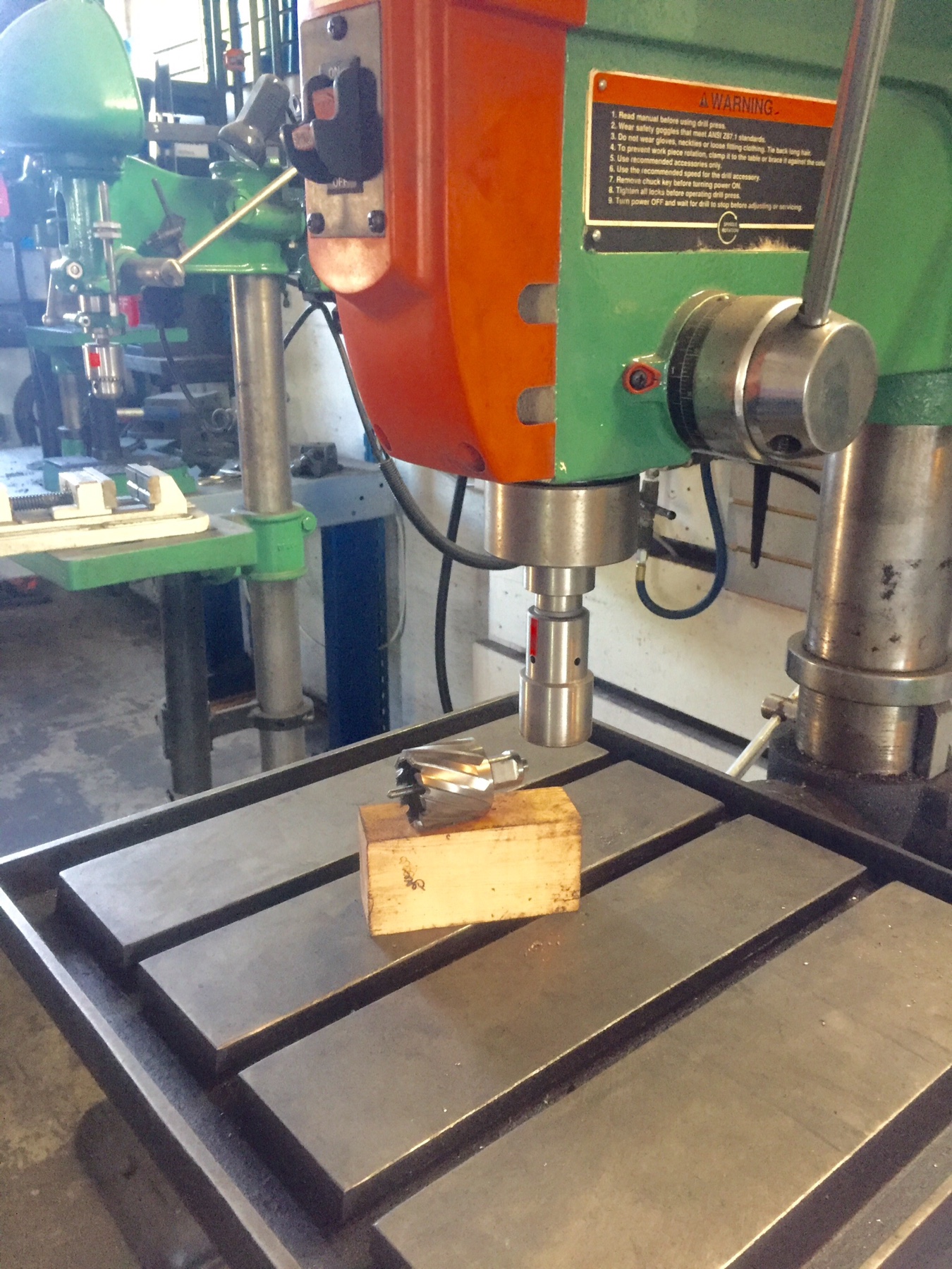

I bought these drills for my present project to drill for bushings mounted in box tubing with 1/4" wall. Works well with less torque needed to turn them. Bought these in 1 3/8" down to 7/8" sizes very satisfied with the results after using these to drill holes in tubing and flat bar. These will cut up to 1" deep but other depths are available.
This is the 1" size.
Annular bits combined with a magnetic drill base is the perfect setup for "field work", or things that cannot go under the drill press. 1" holes in 3/8" plate are nothing. Kind of pricey, however (with a good drill and bit set running $1K), unless you go with the Chinese versions.

Another good option is purchasing an arbor adapter for your drill press to accommodate using annular cutters.
An appropriate adapter is under $50 and Made in USA annular cutters are always available economically on eBay.
