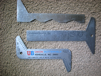

Sharpeners that use diamond-coated wheels work well, they just don't do high volume work w/o 'eating' wheels.
Learn to use one of these, and become adept at drill sharpening with bench grinder or belt sander. ;)
(I'm using a Lisle 92000 (discontinued :(), and am continually seeking parts for it ...)
   / Drilling holes in steel #27
...the old grind. Now I understand your username
I would love to come across a used Lisle 92000...
