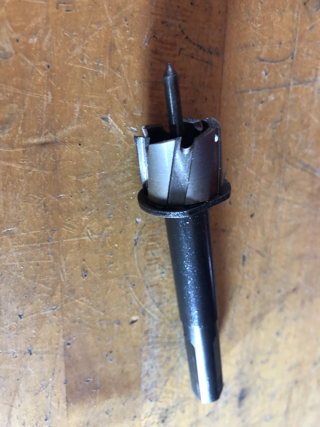

Since you already have a drill press consider what others have mentioned for layout and buy an annular sheet metal cutter for your press.

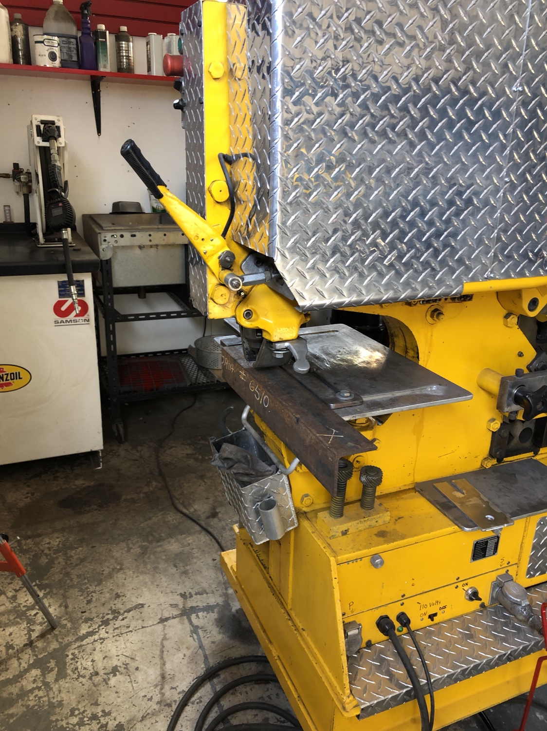

The best way would be to punch the holes on an iron worker. Since I got mine earlier this year I only use my drill presses less than half the time.

It is hard to get a center punch on target, but I find the iron worker to be a lost cause for accuracy, unless you prepunch the holes anyway..

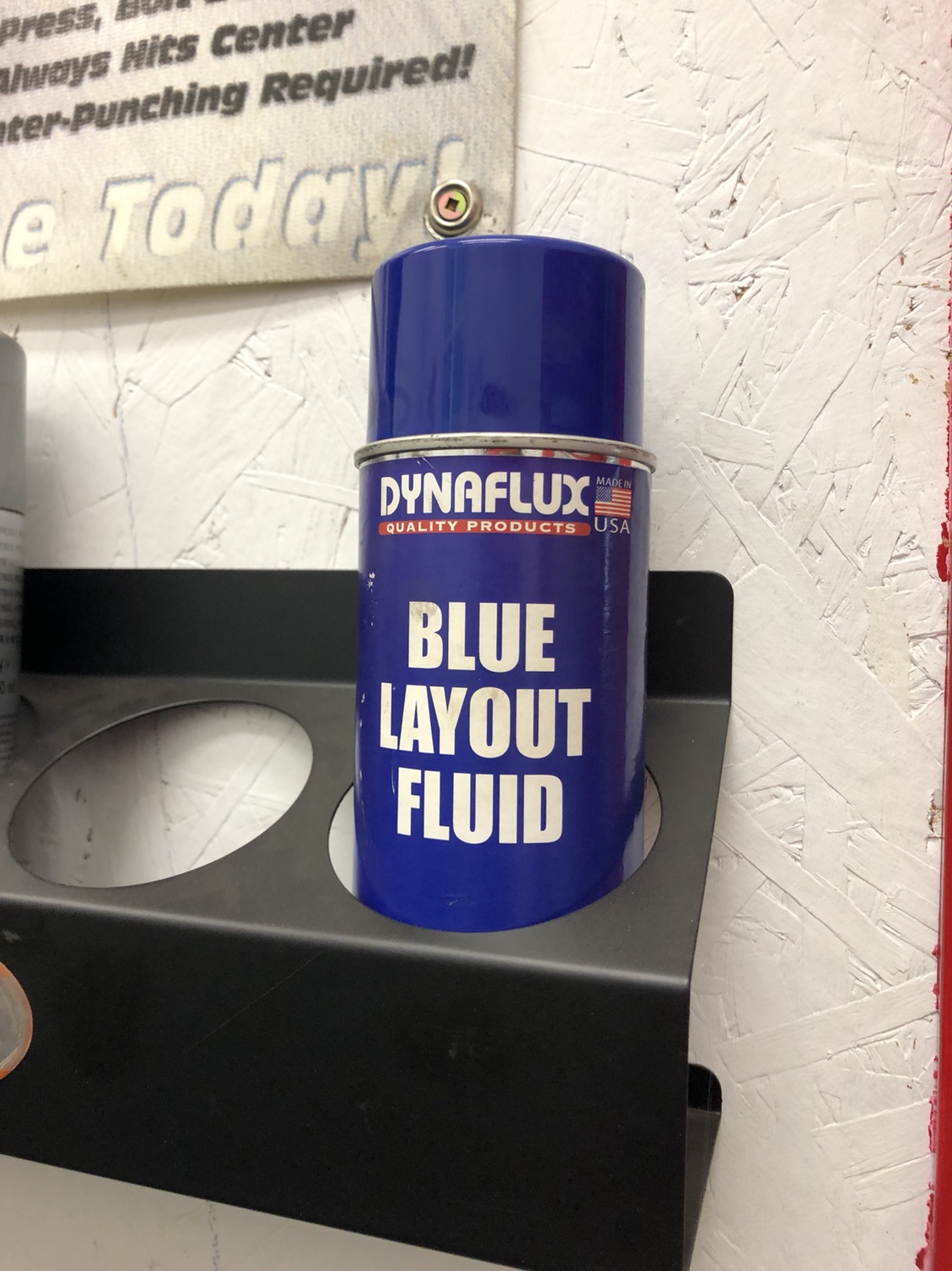

We used to use a bluing ink for layout work, but I just color the metal with a sharpie, so the scribing shows up nicely and rub it off with some acetone.

I use blueing ink also.
And you’re right about center punch accuracy. If I’m REALLY particular I’ll use my optic punch for layout. Sometimes I tap lightly with a prick punch followed by a regular center punch. MOST times I’m just too lazy and use the auto center punch
Below left to right in order of preference (quick and dirty to OCD)
