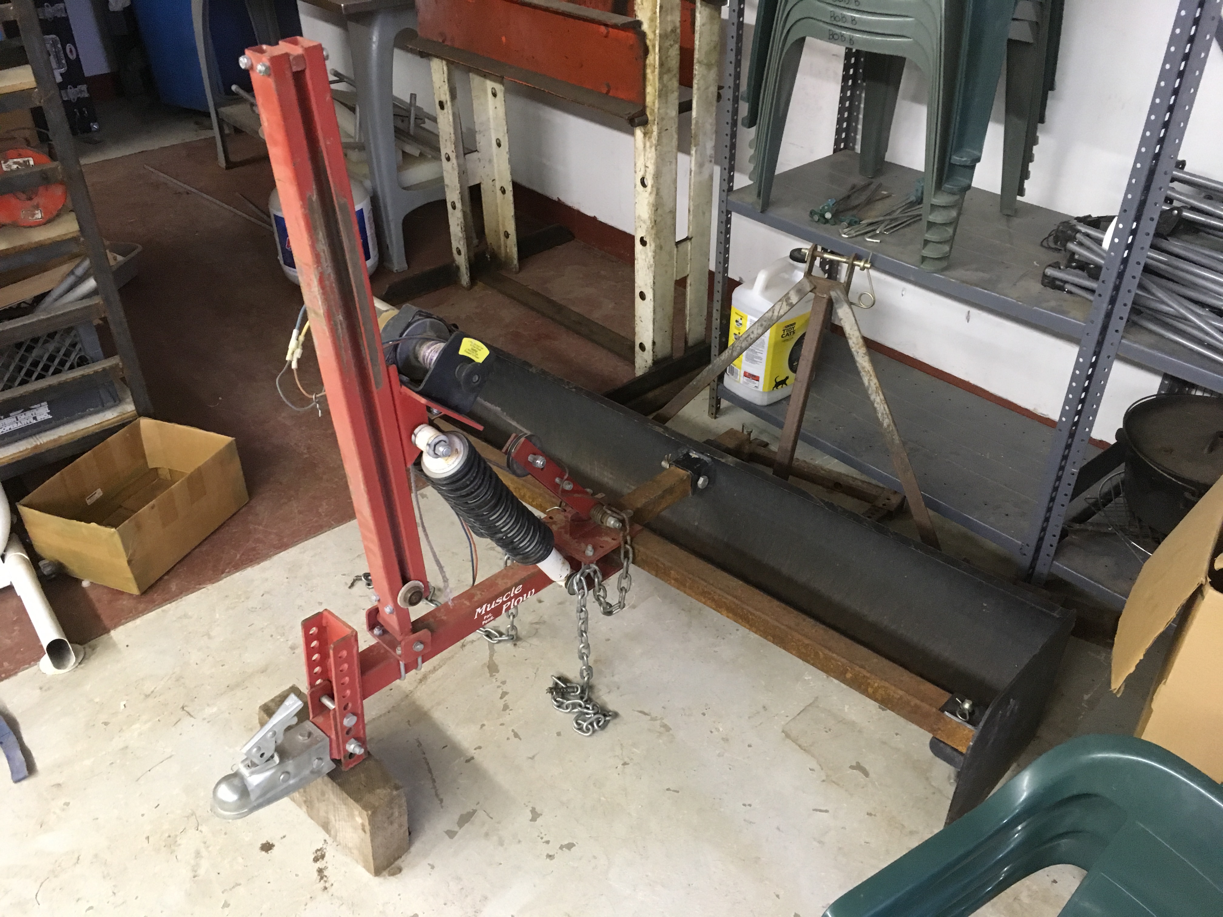

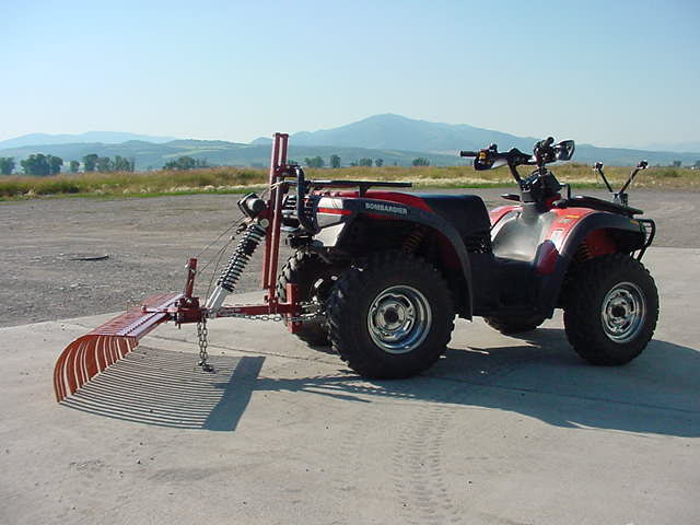

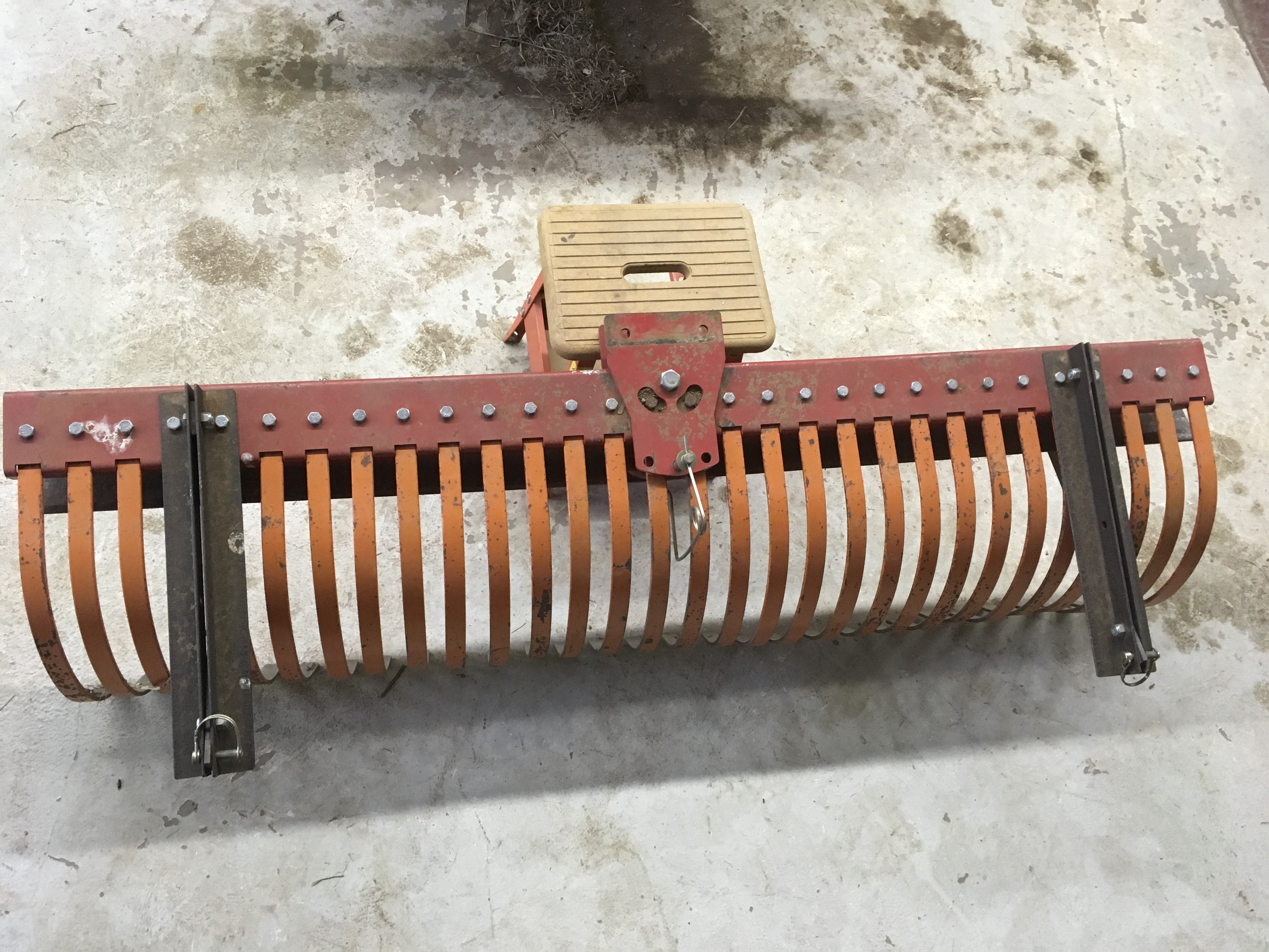

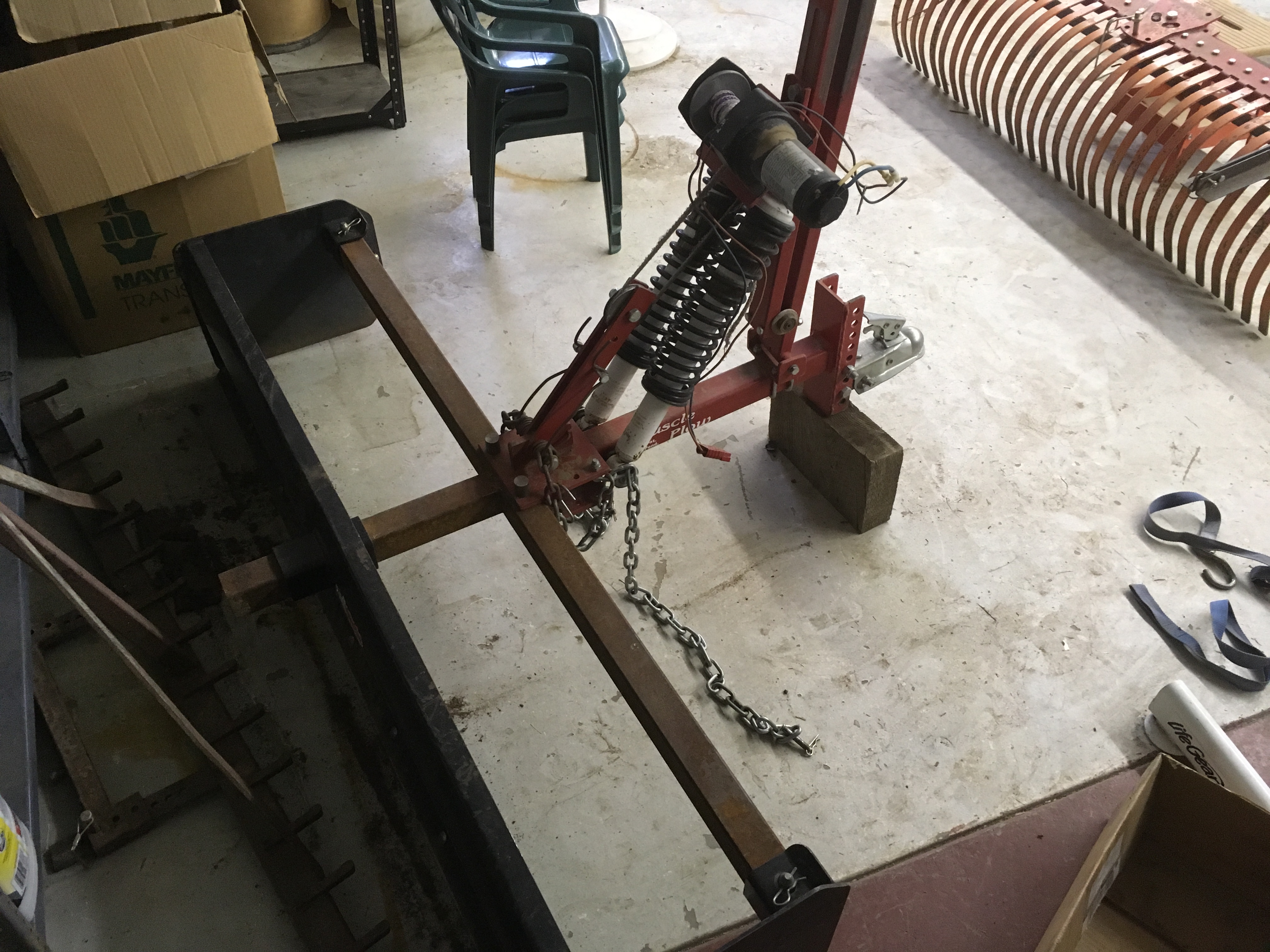

I finally had a chance to take some pictures of a rake bolster I made quite a few years ago, maybe some of the ideas I used may help the OP. This rake was only made for an ATV so it is 60" long and lighter duty than would be needed for a tractor.

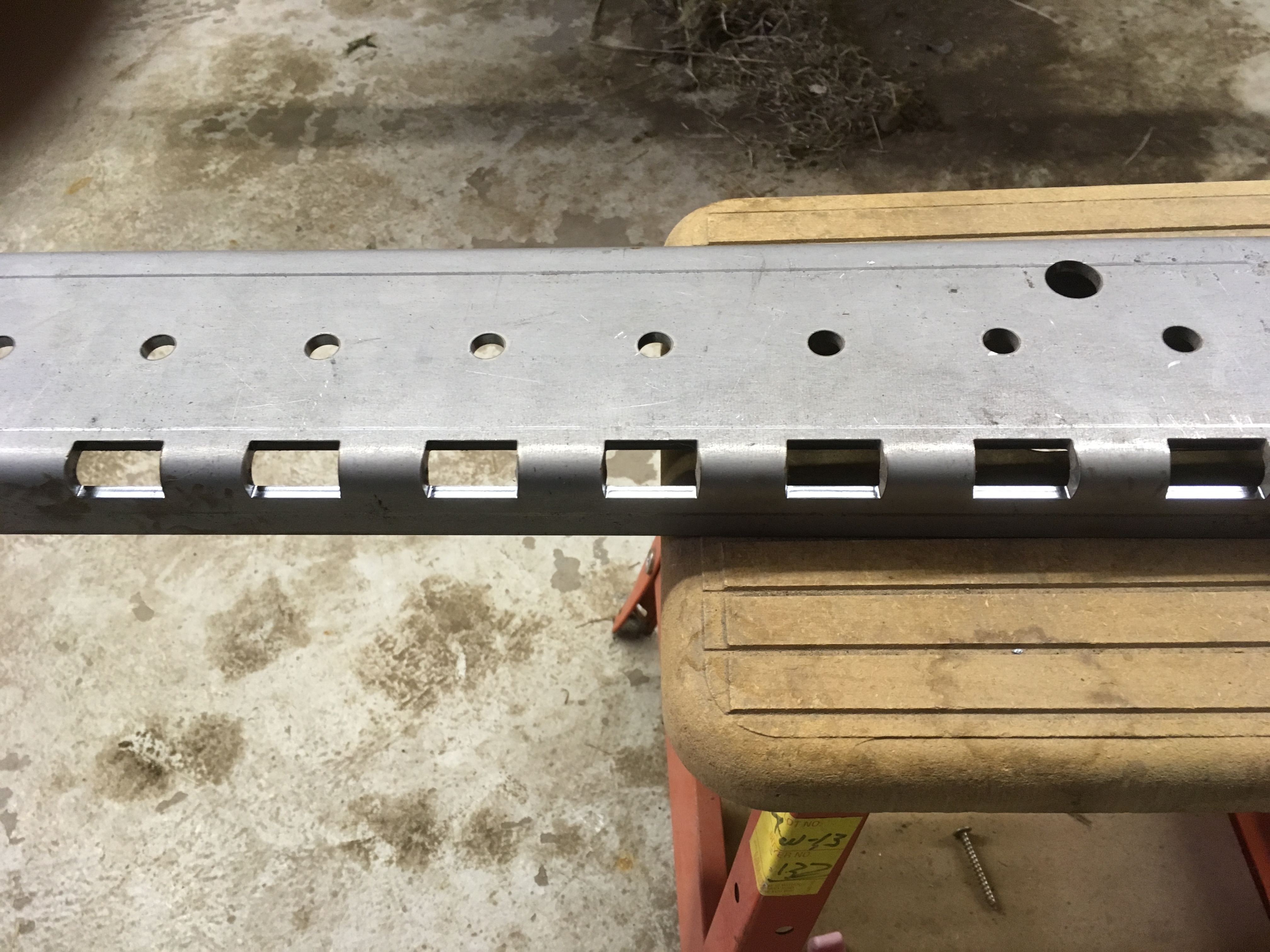

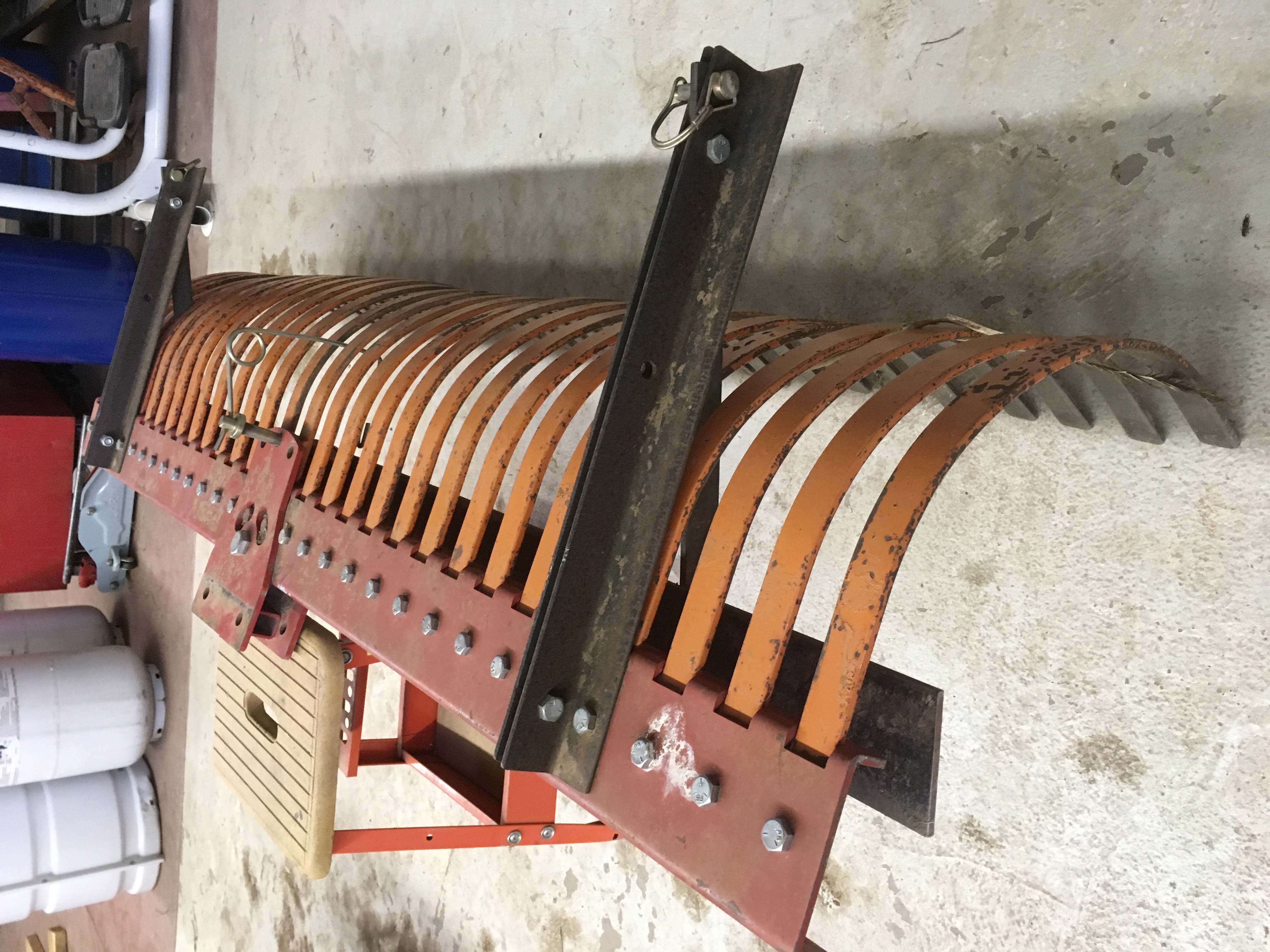

Initially I had a company bend the plate into a channel shape. I have a mill so drilling the holes and machining the slots was easy but took a lot of time. Once I had built mine, several people said they wanted one after they saw how effective and versatile it was so I did the layout work for the bolster as well as some other parts to be made using a laser cutter. Then I just contracted out those parts which saved me a lot of work and saved the customers money.
Following is the bolster which was laser cut out of a sheet of plate, then bent as needed. Basically I just adapted the York rake design to an ATV and bought the tines from them. A single bolt holds the tine in and the slot keeps the tine straight.

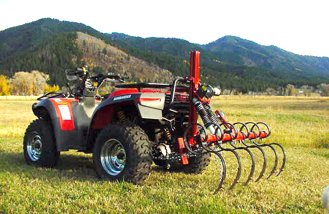

Following is the complete system with the box blade, S-tines and rake on it. Two pins hold on which ever implement I need which includes the box blade, rake, back blade and a bank of S-tines. I also have a scarifier that works in conjunction with the rake and box blade.

That’s really nice. I wish I had the ability to cut 50 square holes but I can’t do that. Plus I need a stronger frame than the 1/4 “ plate. But that looks very well designed and made.
