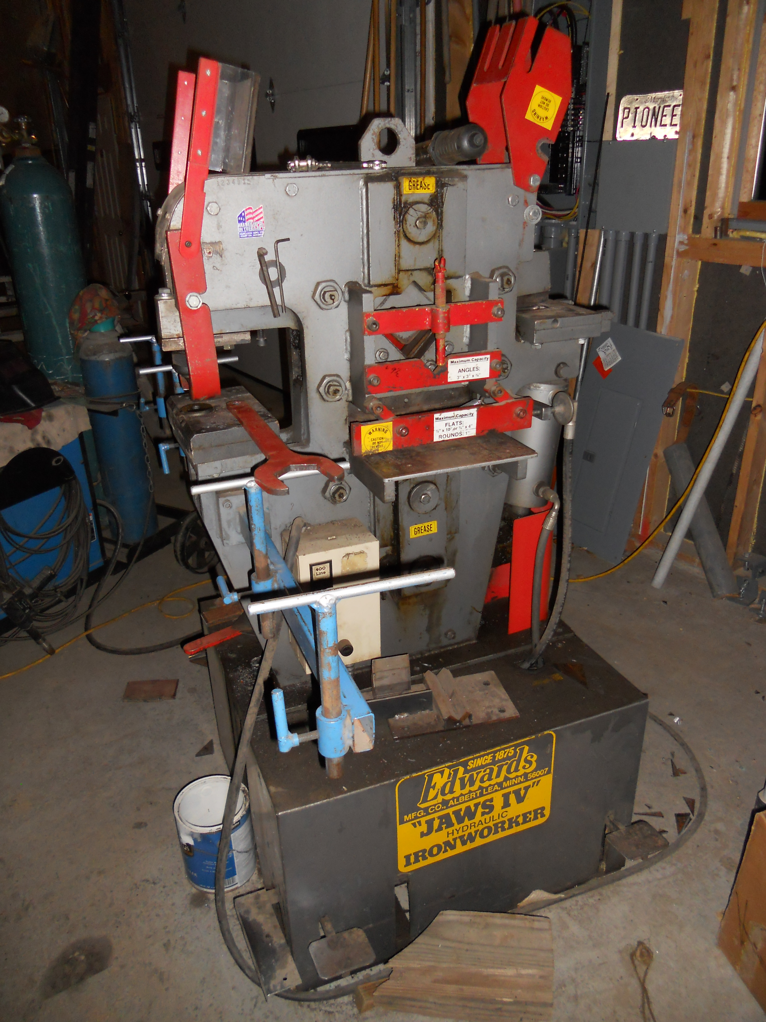

The best way would be to punch the holes on an iron worker. Since I got mine earlier this year I only use my drill presses less than half the time.
My new best friend for the past 8 years or so.:thumbsup:

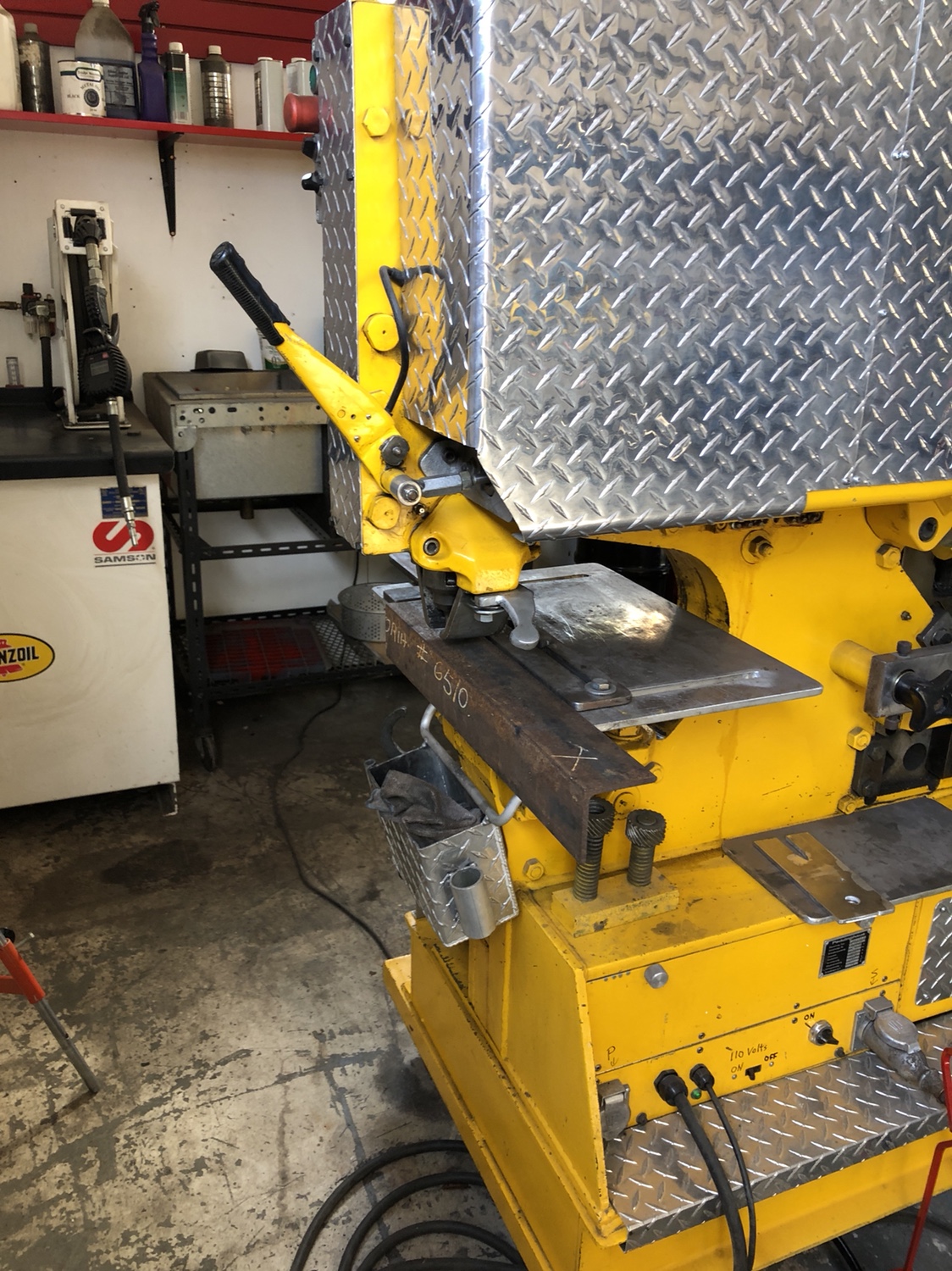

It's limited (for punching) to the thickness of your material, ie; 3/8" minimum size hole is 3/8, 1/2 is 1/2 etc. I think it a "property" of mild steel that must be adhered to when punching. Iirc my little I/W's (maximum) will punch a 1" hole through 5/8 material.
HCJ, it might be worth a trip to a local fab guy with an iron worker. He might get you for an hour minimum but it's an option, unless you want to drive to Maine. I'll get you a beer and punch them for nuthin.

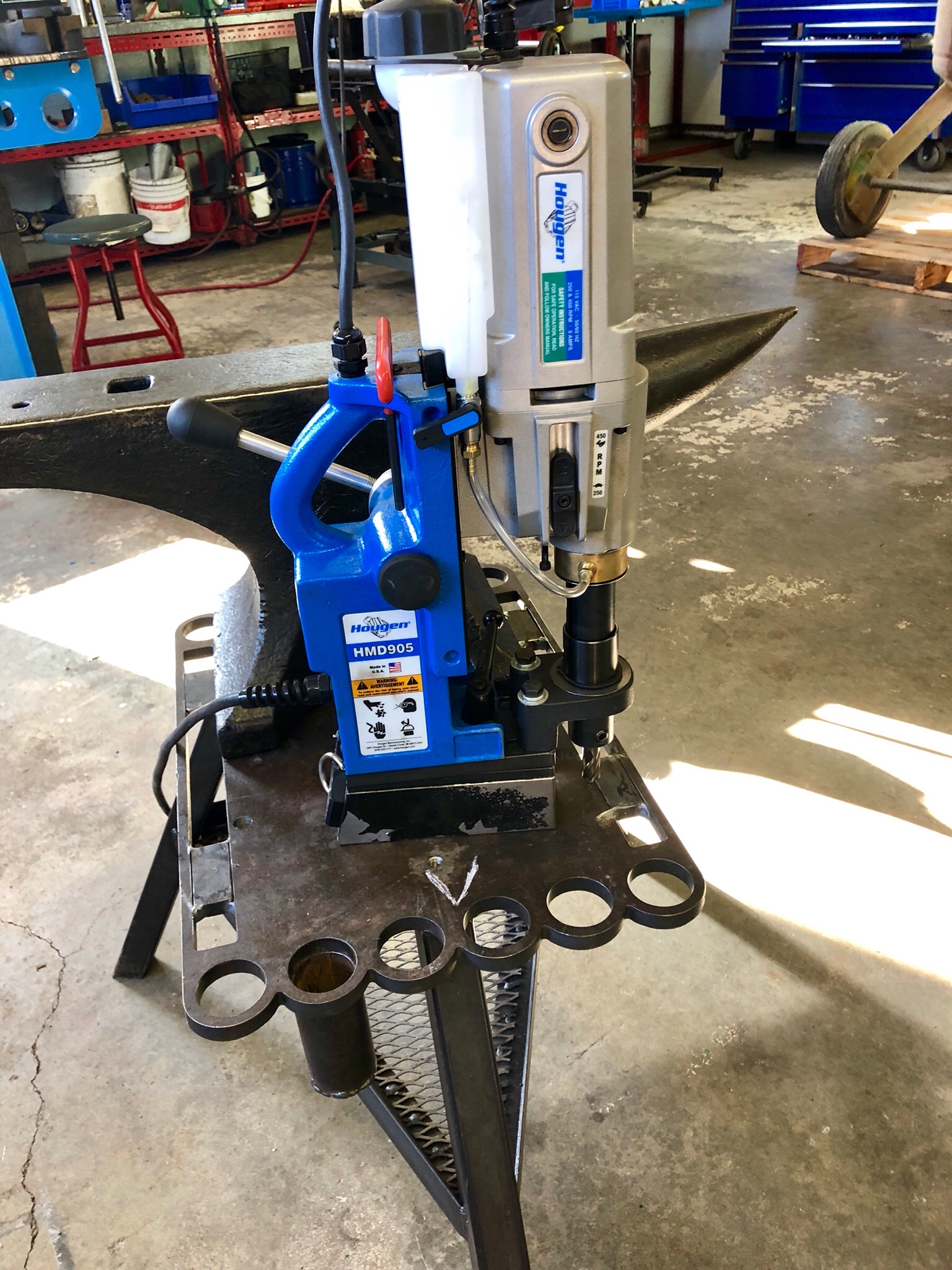

Will a mag drill lock onto a welding table with 1/2” plate top? Just curious. .
AS WE SPEAK.... the answer is yes. I’m currently drilling holes for the hold downs on my new anvil. 1/2” plate base. IMG_2410.JPG
Here’s a closeup of the hole. 9/16 thru two adjoining pieces of 1/2” plate. Aprx 10 seconds per hole.

BB, I'll defer to you as I think you are much more a metal worker than I. Is that 1/2' hole in 1/2" material a "thing". I read it in the book that came with my I/W.

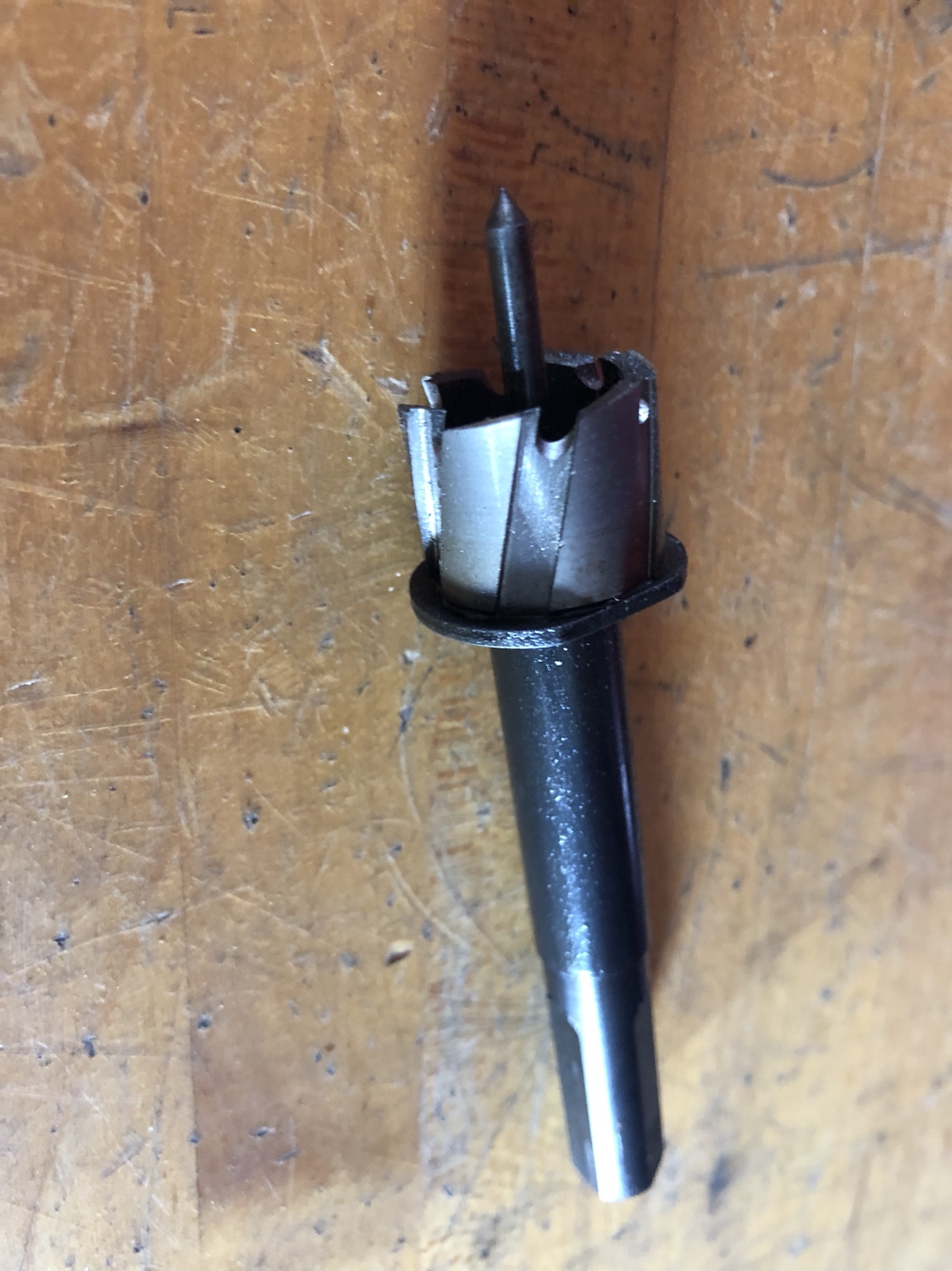

For one thing, there may be smaller than 7/16" cutters that fit the 3/4" Weldon shank, but I haven't seen them. As Terry mentioned tho, there ARE smaller annular type cutters with regular drill shanks, that would work on your DP if you can find a way to tighten up the table tilt. Be VERY AWARE, though, that not all the sheet metal type cutters will cut deeper than 1/4" - I have this set
Blair 119 Rotobroach Cutter Kit Hole Saw Kit - Hole Saw Sets - Amazon.com
But if you look at the second picture in that link, you'll see that the smaller sizes all have a shoulder (necessary so the adapter will fit) - I just measured my 3/8" cutter, and it would just BARELY cut thru 3/8" thick steel before that shoulder hits.
Here's Blair's info - Blair Rotabroach Hole Cutters
They don't show any cutters below 13/16" with DOC greater than 1/4", but I have their 11090 KIT
and I know for a FACT that the 3 larger ones have NO SHOULDER, and WILL cut 1/2" DOC. As mentioned, the smaller ones will just BARELY cut thru 3/8" material before hitting the shoulder.

Add-on - "Will a mag drill lock onto a welding table with 1/2” plate top?"
Terry covered that too; I've drilled 1/8" square tube with the drill sitting on the tube itself, but two things - one, my mag drill is "not yer father's mag drill", I intentionally bought one of the heavier duty ones, (correctly) assuming that, because it's HEAVIER, and meant to hold on vertical surfaces, that the magnet structure has more pull, and (2) I didn't push it quite as hard as I usually do.
Magnets did NOT pull loose on the 1/8" material, but my USUAL table it sits on (the GRAY thing in the pics) is a 12" long piece of 10" C channel (3/8" web) with an ADDITIONAL facing of 1/2" flat bar, full-welded, with ends closed using MORE 1/2" FB - then I surfaced the top (after knocking off most of the weld beads with a flap disk) by using a 3" diameter carbide fly cutter on the mill. This gives me a nice flat surface for the drill to grip.
lol. Yes. The diameter of punch must always be LARGER than the thickness of the workpiece.
