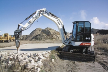

the contractor i work for hooking up septic controls has a rock hammer/breaker on his matchine. goes thru bedrock and granite just fine. but its destroying his machine. he says hes constantly rebuilding his equipment due to that hammer. the vibrations and noise SUCK. i hate being onsite when this equipment is in operation.

I hired a machine that was a tad smaller than that to chip out a septic tank. It was just regular rock not granite or anything and it took 5 hours to chip out 18” over a 5x10’ hole. And yea they wreak machines and are super annoying. If you’ve got the room blasting is much better but they won’t blast within like 250 feet of existing structures.

We put the hammers on the oldest machines just for that reason it beats them to death.. just changed a oil cooler that broke apart..........
