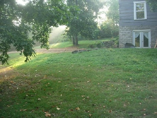

Here's a side view. Builder said they couln't bring a top heavy concrete truck here with this angle (truck would be facing picture and would be leaning sideways)
Septic tank is on other side of tree and field is below tree, extending into the yard on far side

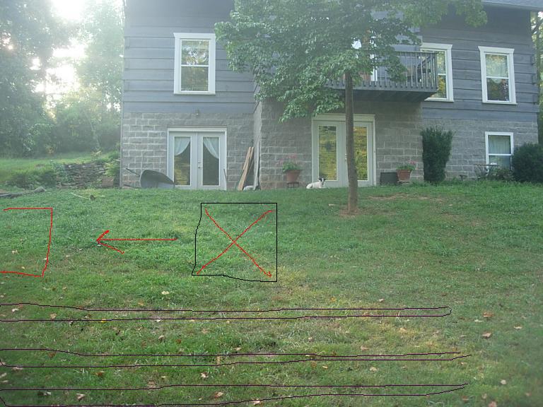

This is looking up
The red "X" is the approximate location of the current tank that they're going to fill in. The new tank will go to the left and will actually be a bit off the picture. Under (downhill) of the tanks is the drainfield.
Since the new tank will be to the left, you can see how the drainfield blocks the access. Also... the yard itself slopes down to a dropoff that is about 3' high so it's not easy bringing a truck up from the bottom. I don't think any of these pictures show the row of trees at the bottom of the yard

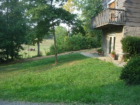

Looking down the hill, the house blocks some access, this dogwood blocks some access and then the drainfield blocks some access.
He told me yesterday he wants to take the dogwood down as that might give them better access.
We did everything we could to SAVE that tree so I'm not too keen on doing that, however, I did tell the wife last night that if he wants to replace the tree (his expense) then I'm ok with that
I might also offer to him that if he wants to replace the drainfield (with proper inspections when done) that he can rip it up all he wants. Again, this would be at HIS expense.
I was very clear about this situation prior to him quoting anything so if he's got some challanges now, he had ample warning and didn't do enough homework.
My feeling is, if I knew enough about this situation to 'warn' him upfront about these obsticles, (that he should be ahead of me on) then I don't really care what his challange is to get over them, nor his expense.
