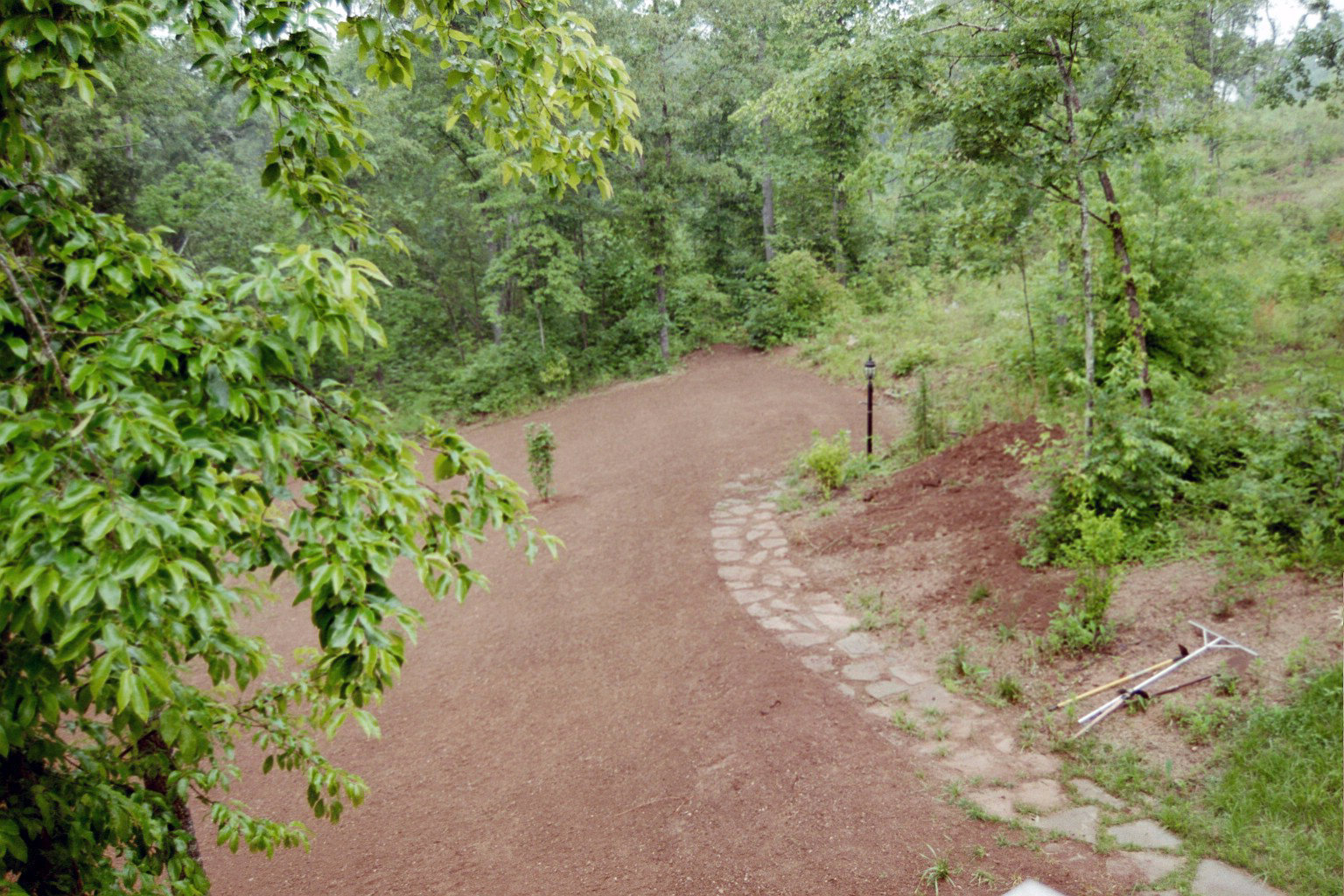

As aside...I asked above about the logic of putting something down (plywood? geotext fabric?) and dumping a "dirt road" on top of it for them to work on/drive over. The "road" would be made with topsoil instead of the dumptruck of rocks they want to bring in (to achieve same goal).
Is there any merit to laying down some 1/4" or 3/4" sheets of plywood and then dumping several truckloads of topsoil on top of them to help raise the height and spread the weight out?
If they use topsoil then I can simply work that in later...if they use rocks... then no matter HOW much they say "oh, and we'll clean them up when we're done" I know I'm going to be left with a freaking TON of them mashed into the yard, working themselves up over the years as mower projectiles.
I'm sensative to this a touch because I've hand raked this entire yard about seven times (yes 7) to get all the rocks out...and each freaking time I did it, we had a torrential rain to ruin it. I'd bring more dirt in, hand rake it again.... and another torrential rain.
Finally I said the heck with it... I gave up knowing I can't whoop Mother Nature.
Picture attached of my butt baby smooth side yard prior to Mother Nature whipping my hiney :eek:
btw, I swear I did it 7 times. Really frustrated me
