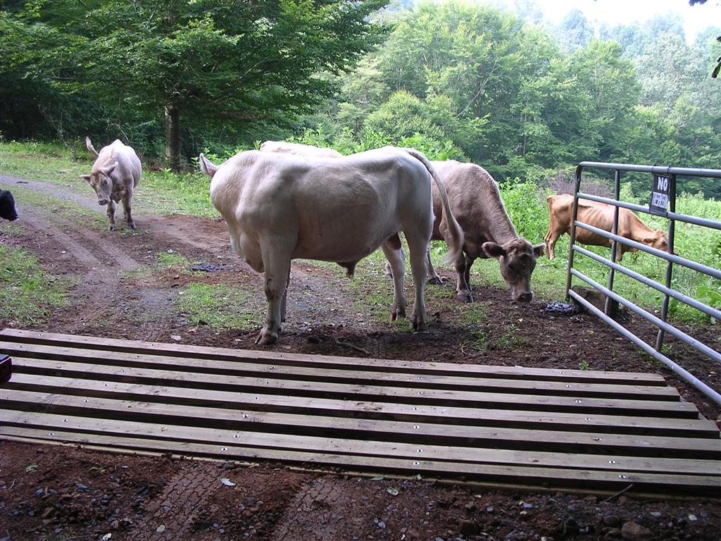

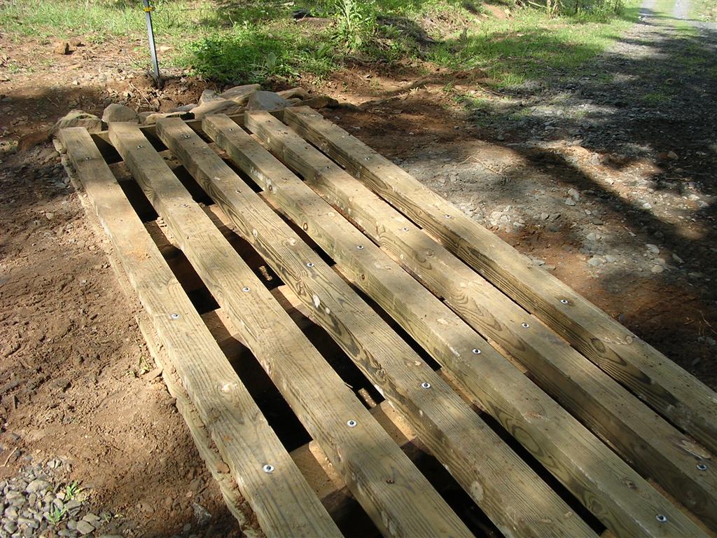

I have always heard them referred to as cattle guards and they can be made from whatever you have handy and that will last. My understanding is that cattle will not walk over anything that they can see down into. I agree with Bird that they are not willing to have a leg slip through and break. I just recently built these two on our place in NC. It got real old this summer having to undo the electric fence at the house, drive past, stop, get out hook the electric fence back up, get back in, drive down to the entrance, stop. get out and open the gate, drive through, stop, get out and close the gate, run our errands and then reverse the process when we returned home:( I rented a small excavator to dig out the pits then used 10" square locust logs for the stringers and pressure treated 4X6 for the decking on top. The spacing on the gaps ran around 5 1/2" if I recall. I then boxed it in with pressure treated 2X12"'s to keep the dirt and gravel from washing back in. I will have to clean them out every few years because the cattle will cross them if the pit fills in. I know that most of the ones I have seen before were made of metal but when I asked around most of the locals said they built them this way

We learn all kinds of things on Tractorbynet. I've never seen a wooden one before. I can see how it would work OK, but wonder how long the wood will last before it rots out. I'd be inclined to think it's smoother driving across it than driving across one made with steel pipe.
   / Drive over gate #29
The locust will be there long after I'm gone and I hope to get 7-10 years out of the pt 4X6"'s with the limited use it will get for the time being. If and when the 4X6's need to be replaced all I have to do is unscrew the 5 screws used to hold each one in place and screw in a new one:D When I was originally researching cattle guards on the net I came across several plans for wooden ones including one from the USFS. I know mine will not last as long as a metal one but it cost considerably less to build and hopefully will do the trick. It's not too bad driving over but you still get that rumble strip feel. The real test will be when I get some gravel trucks delivering for our drive. Those things are heavy but my contractor took a look at the locust timbers I used and said it could probably handle two, one stacked on top of another!
