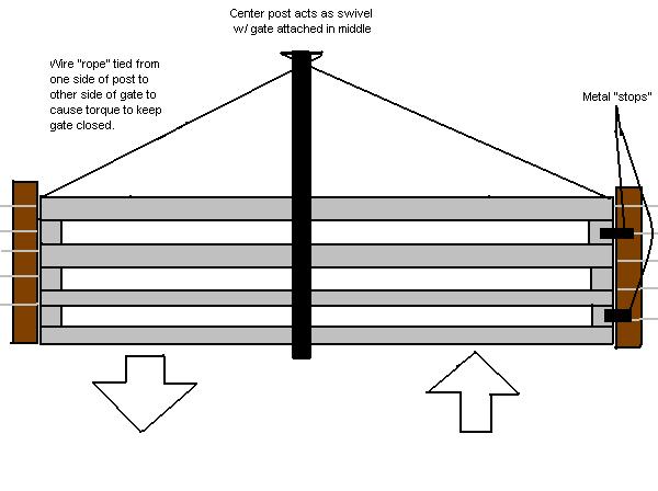

Hello TXDON,
I think maybe U mis undestood my typing , I said a BUMP GATE not a bumpED gate! We got a lot of those types of bumped gates up here in Liberty County tooo! I don't think the bump gates are just in South Texas but that's where I saw them(down round Del Rio). I've seen deer hunters pull up. bump and pull truck w/16 ft lowboy throu w/o gate hitting trailer but then swing shut! I suppose that was what they were designed for! I noticed those beautiful yellow flowers in background of U'r pic, was that the goldenrod aka ragweed?

Roho, the yellow flowers are broom weed.
Does the bump gate work in only one direction? Can cows bump it open?
   / Drive over gate #57
Well TXDON, It sure seemed to be able to be bumped from either side but I can't remember how it worked or looked!!! I know that it had to be some sorta catch latch that stops the gate but can't place it in my mind! 2 much water under the bridge! & now with solor panels, batterys and electronics the way they are, I'm sure that simple design is out by now!

Another interesting note on cattle guards:
When you have a cow or two that has learned to "walk a guard" you can take a light colored paint, like yellow, and paint every other pipe or rail.
They will quit walking over it.
Something to do with them being able to see the light color better so that they misjudge the gap.
And yes, there are a lot of cows and horses that fall off into them, I've had to help rescue many. Luckily, I've never personally seen one break a leg.
It probably helps that most of ours aren't very deep below the pipe.
As for the bump gate, I've (hopefully) attached a crude drawing of one.
The center post acts as a swivel with the gate attached to it and it has wires tied from one side of the post to the opposite end of the gate which causes torque to keep the gate closed.
you drive up and bump the right side of the gate with your vehicle and it swings open, if balaced right it will hang there for a few moments before pulling its self shut.
These are used more in goat and sheep country than in cattle country because a cow or horse will learn to open them eventually, sheep aren't that strong though. These gates are usually pretty darn heavy, most I've seen are about 20' wide and made with 5-6 pieces of 2X8 pressure treated boards.
