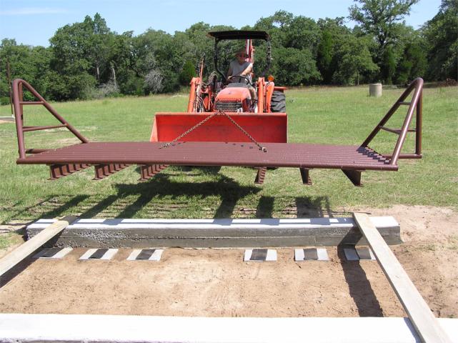

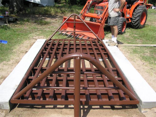

My cattle guard (to keep the cows out of the yard) is 6' across, and has 4 1/2" space between 11 pieces of pipe (pipes are about 2 1/4" OD). Here is a picture of me setting it with the FEL. I poured two beams of cement and set the cattle guard in between. I removed the boards on the ends once I centered it by lifting each side up with the FEL.
Oh, by the way, a friend down the road did not have a cattle guard or fence around her yard and the bull lifted up her partially opened garage door and turned around several times on each side of the car causing considerable damage. At least that's her story and she's sticking to it.:eek:

If I were building one myself I would sure put some thought into how strong it needed to be to support a fire pumper truck.

Well, I think drill stem would do that, but if I didn't have a pond I might be more worried about the tanker!
