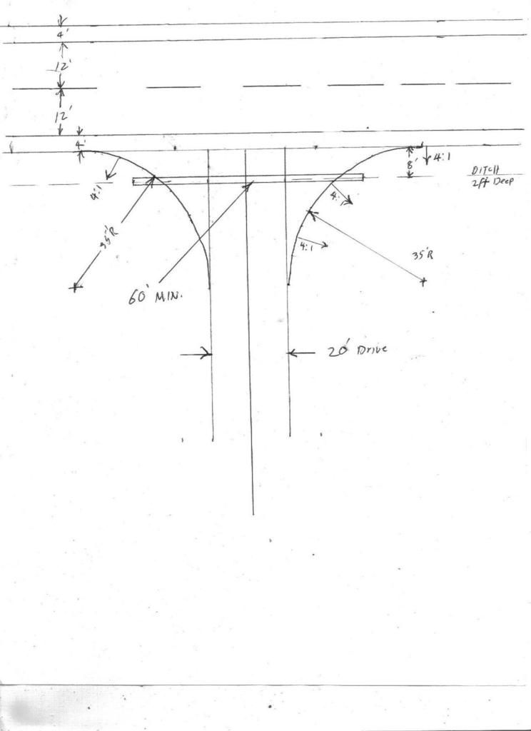

52' across my 'dirt' drive apron, 2x 20's and 1x 12'. Metal, 12" diameter, wrong size, actually needs to be 18" diameter. Was installed prior to me living here. Access is onto town's dirt road, and the drive has enough width for proper grading at both ends of the culvert, and lawnscape up one side of drive, ditch on lower side to run water to feed end of culvert.
40' will do must drives nicely. 20' is too short for adequate grading, slope at ends, etc. This is a job where bigger is better, and done once, then breath easy.:thumbsup:

The comments about extra length to account for slopes on the side are extremely important. For example: if you have 3 feet sides (3 feet on each side), and you have 3 feet of cover on top of the culverts, the slope will be 45 degrees... which is very steep. At that slope, you will lose cover (gravel). Longer is better.
Figure out how wide you want the lane/drive. Then figure out how much cover on top of the culverts. Then figure out how much slope you want on the sides. From that, you can calculate how much extra you NEED on each side/end.
Too short of culverts become an endless pain in the rear, which in a lot of cases are not easily fixed.
   / Driveway Culvert width #20
Here is what a plan view looks like if both drive and main road have 4:1 side slopes which are both safe to mow and erosion resistant.
