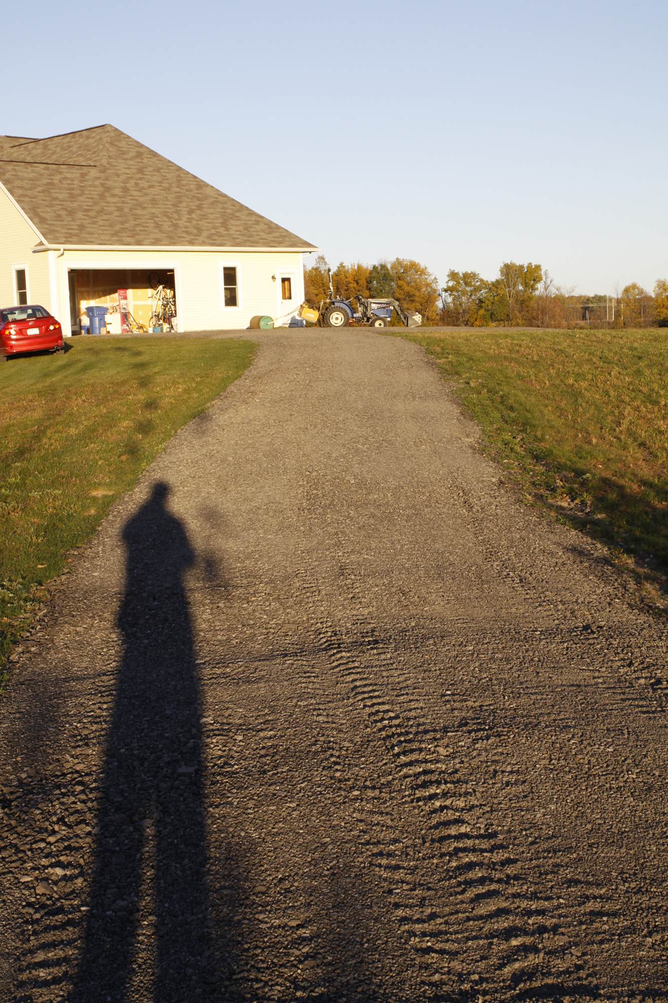

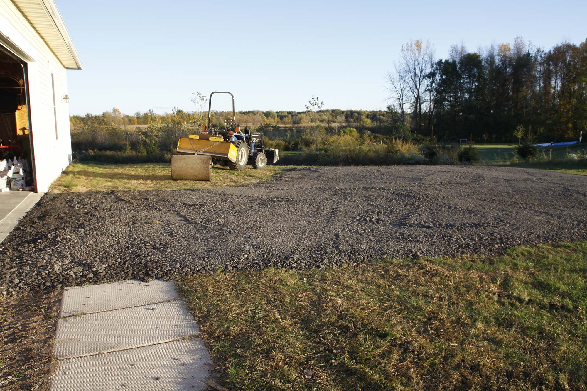

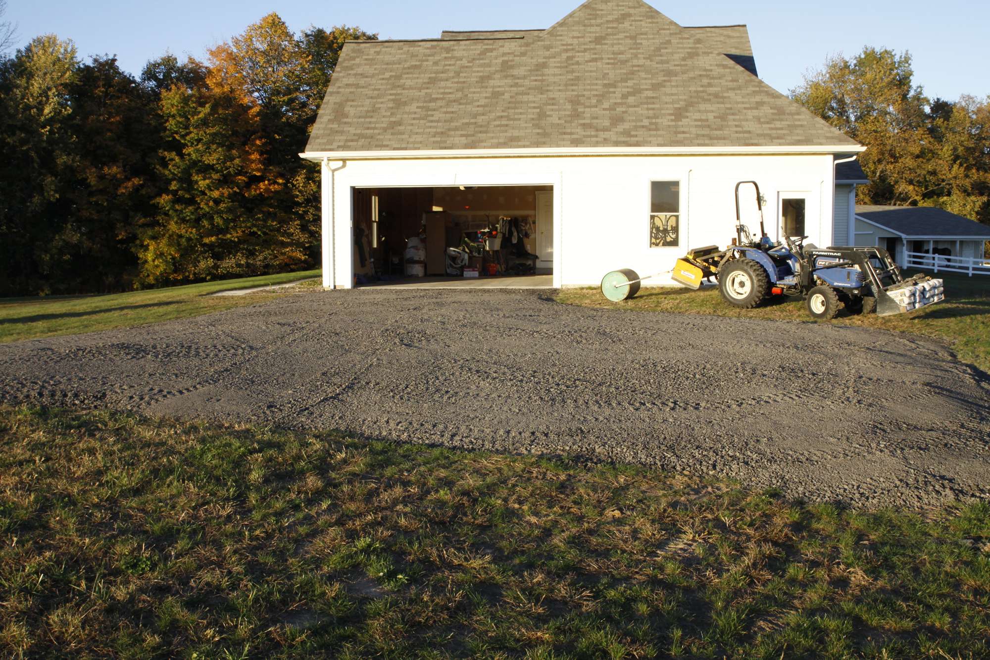

So finally here are some pictures. Two of the first three loads were pretty chuncky but I did get them spread fairly well. THe guy I bought them form stopped by and noticed haw bad they were and asked if I would like a free load of fine stuff. Can't turn down free. So finally he was able to deliver some on Monday. Here is the final outcome.
Anyone have any experience using a vibratory roller on asphalt millings? I tried rolling this as best as I could but the tractor still leaves marks in the top layer. If I still had some warm summer left I would just leave it but I want it well packed by snow so I can run the snowblower over it. The rental place has 1.5 ton and 2 ton rollers any thoughts?

I ordered some "chunky" stuff to try and get it to hold on my hill, and the guy brought me fines...we went round a round a while, and he showed up with a vibratory roller on a big skid loader. It helped quite a bit, there's been very little washing since then...very little rain, but it looks good so far. If you do that, you have to have it perfectly level/even/smooth before rolling
/ Driveway finishing
#11
When you say perfectly level/even/smooth, how perfect is perfect? It is smooth but it does have some gradual level issues. Spreading the top coat I moved it to the places where I needed it with the bucket then my wife raked it out by hand. I did drag a heavy pipe across to help on the leveling but it is not "perfect". I would have liked to run the back blade over it some but there is only about 1" of fines on the top and was worried about stirring things up and making a mess again.
/ Driveway finishing #12
As smooth as you'd like to have it forever...I didn't put in enough time, and there's some humps. I thought the roller would pack the high spots down more than it did and even things out...not so much.
