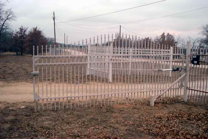

Harv, I thought I'd show you what I've finally done on my girlfriend's gate to get it working again. I decided to leave the gatepost hardware alone and concentrate on the point where the operator attaches to the gate bracket. In this first attached photo, I took a picture of the gate to show that it really is a bit large for this opener. The guy who installed it told my lady friend that the gate was "right on the limit" and I think he fudged a few pounds. /forums/images/graemlins/smile.gif

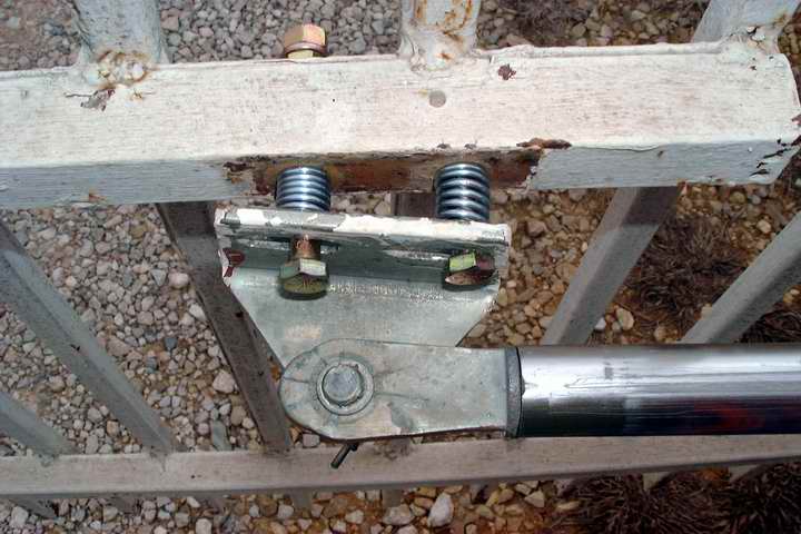

I removed the gate bracket and put a couple of compression springs behind it. I used grade 8 3/8" bolts because the bolts take a lot of side-to-side stress and grade 2 bolts bent like plastic.

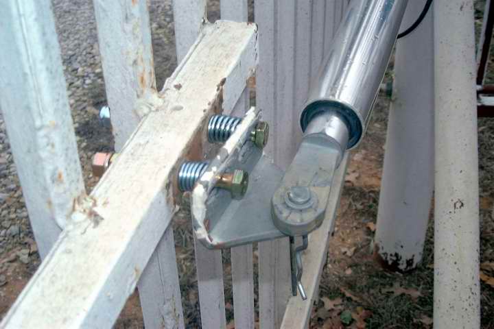

When the operator starts to close or open the gate, the springs compress and the gate doesn't provide an instantaneous load on the operator. The operator is much quieter than it was before when it would load up with the whole weight of the gate as soon as it started to move.
