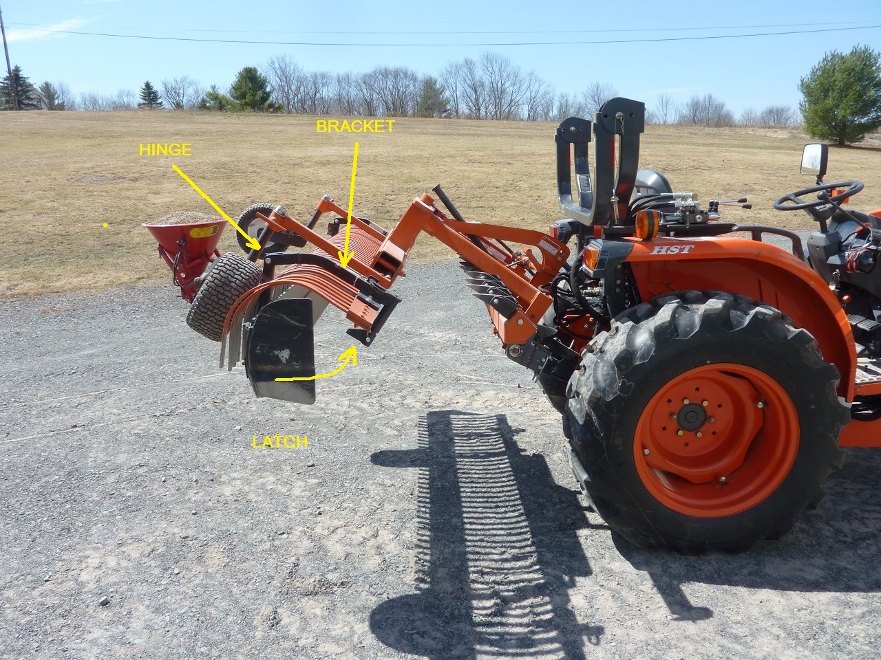

Man.... that's exactly what I want/need for my drive and other uses around the property. I've got an Everything Attachments (I got lucky and purchased back when they were reliable) offset/adjustable rock rake that's pretty much bomb-proof....
However, the cost of buying an aftermarket set of gauge wheels and grader blade for the rock rake are freaking ridiculous. One of these years, when the kids are gone, I'm going to get a welding rig along with the raw materials and fabricate the remaining parts I need. Even with the time spent learning I'll still be money ahead of purchasing pre-made.
How does the grader blade attach to the implement?
The blade is mounted on hinged brackets which are bolted to the cross bar. It folds down and rests against the tines when in use. It folds up and is held by latches attached to the bracket when not in
use.

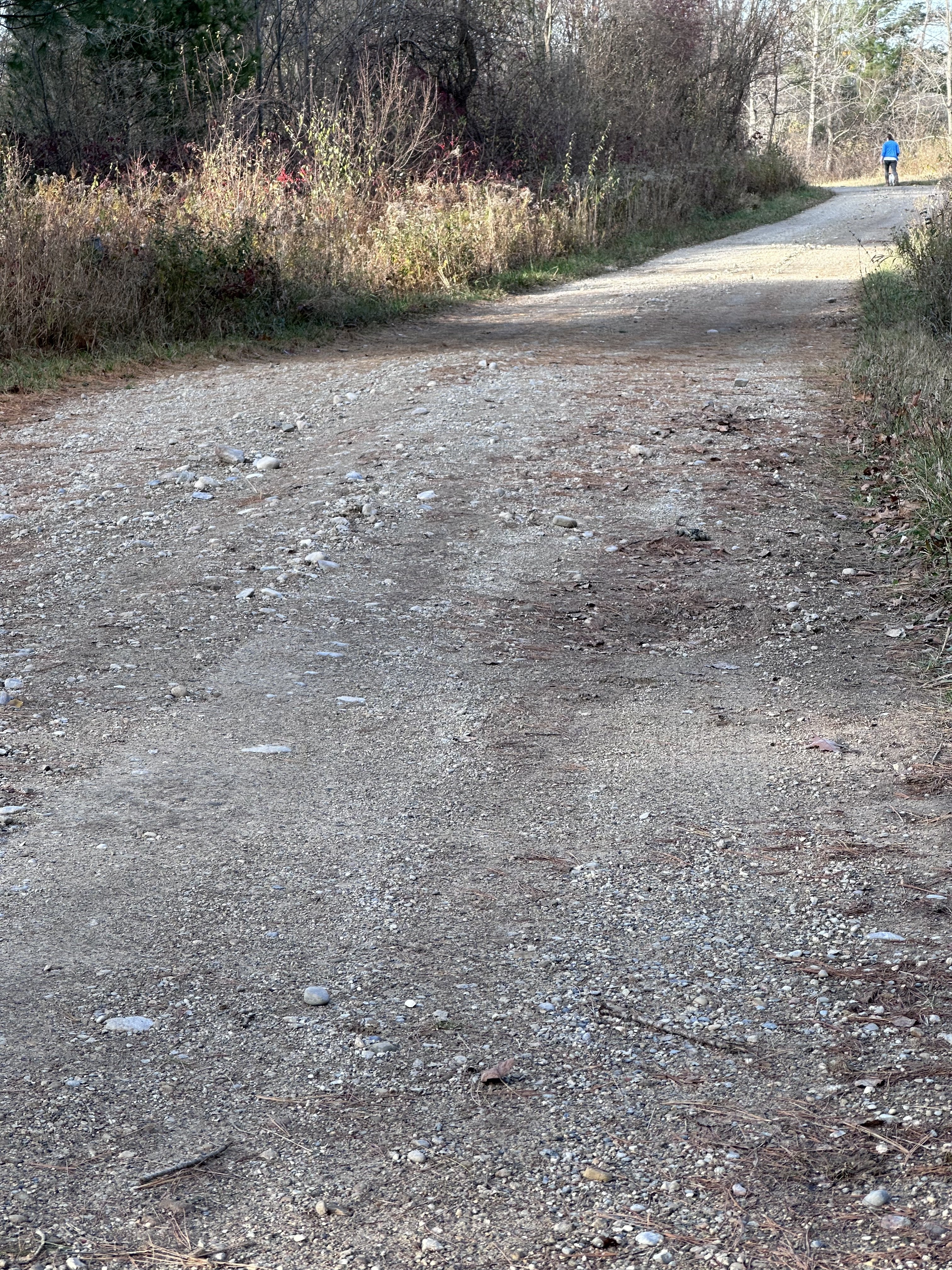

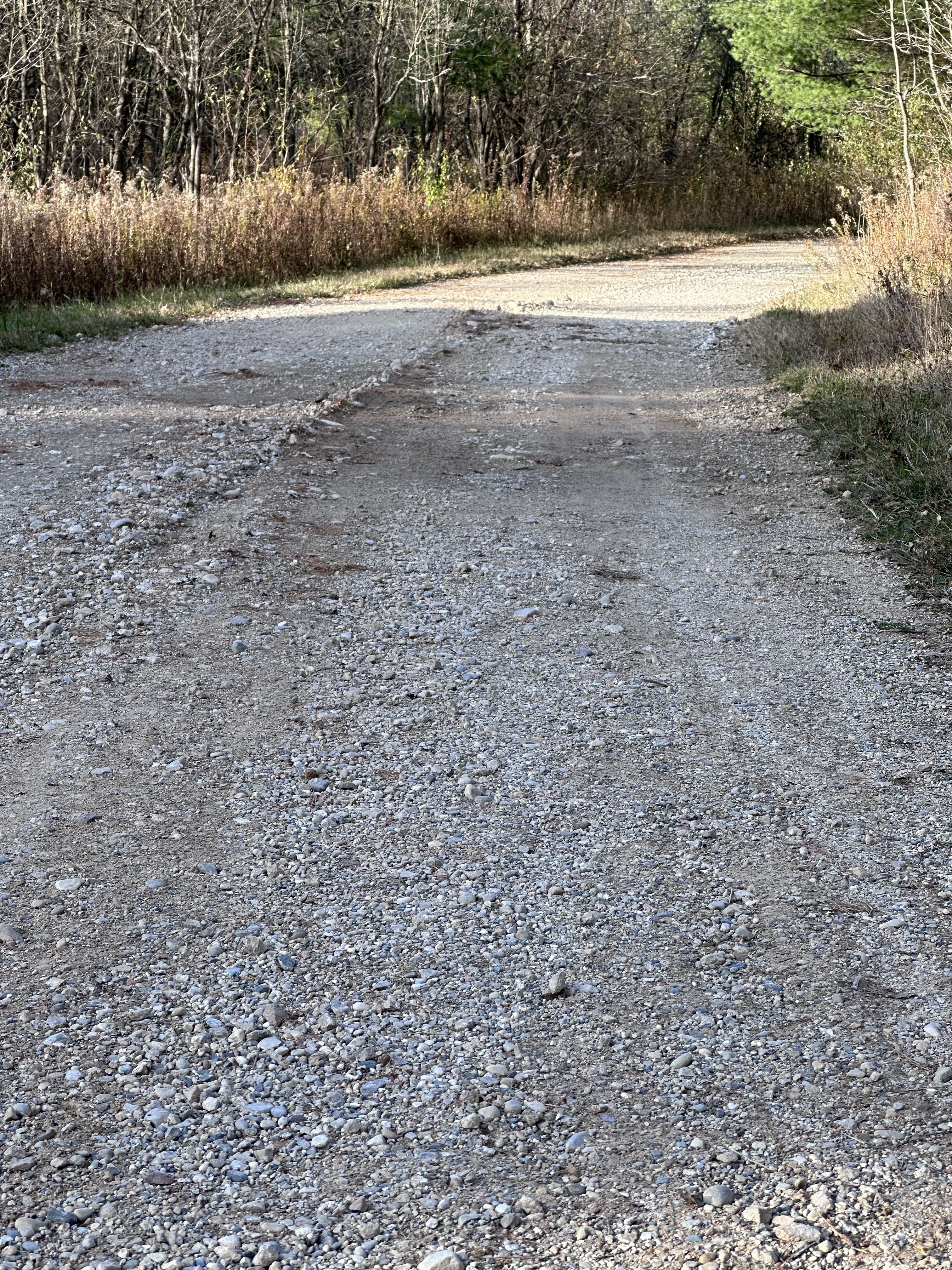

Photos of the driveway

Pictures help a lot. Those appear to areas that hold water. I would cut the grass shoulder down, to create "weep holes" and then scarify the low area, and add some material to it. I dont think the dips you are showing are the result of a short wheel base problem.
You mentioned that the subgrade may be organic or expansive; water sitting on it will certainly make the problem worse.
   / Driveway help #30
It appears that the road bed is lower than the surrounding ground. This will be difficult or impossible to keep shaped up because all of the drainage is into the road. The only real solution is to bring in more gravel to elevate and crown the road bed.
