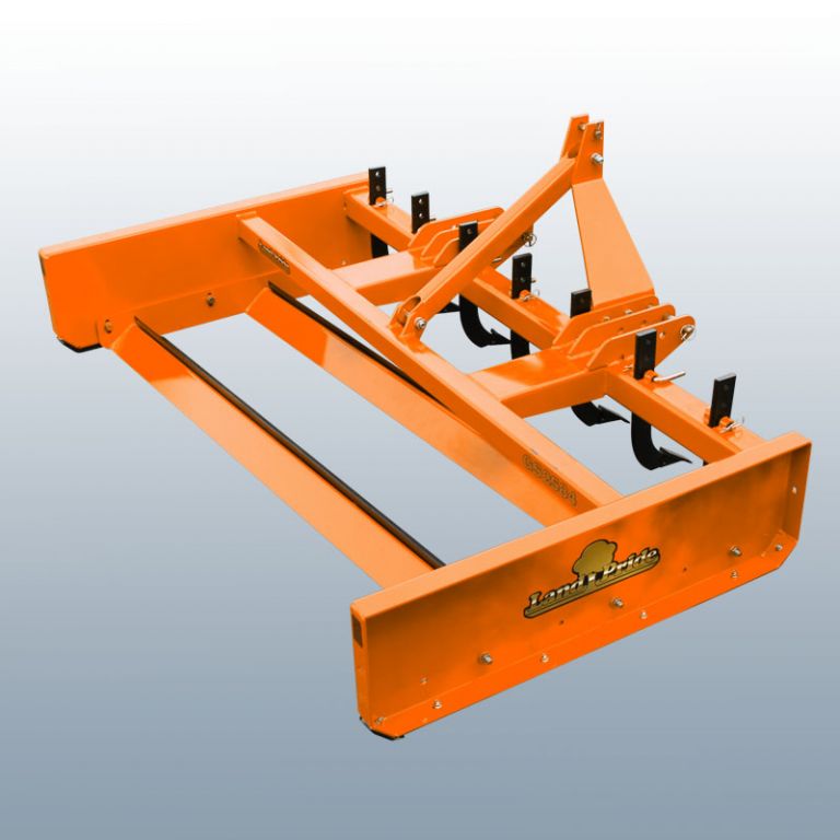

Hey gang, I know the whole drievway scraper discussion has been leveled off quite a bit :laughing: BUT I havent seen anyone suggest something like the Agritek scraper. I have a few driveways and two small parking lots that would need leveled. My personal driveway doesnt pothole but with the rain I get a little washout in certain places. BUT I do have two driveways that tend to pothole get a little uneven. I typically will crown the driveways by angling my 3pt scraper blade to the center then grab a higher gear with the blade straight across and let the blade ride up. It does a pretty good job but it tends to not crown out far enough to get the water off the drive.
I like the landpride driveway grader but I dont like that the spill off is both on the one side, and that is where I like the Agritek style driveway scraper. They are both priced about the same only but the Agritek is 72", 96" and the LandPride is 72",84", 96"

I haven't used the DS series Agritek scaper so can't comment on it. I have put plenty of hours on the skid style LPGB and have built two of them with straight blade designs. If you are working driveways for most of your use the angled blades with spillage on one side only would be an advantage imo. If you were using this for smoothing out large areas such as lawns and pastures then the straight blade works better imo. I use mine for the latter purpose, will be working a lawn over today with mine. Some of the LPGB's have adjustable height and angle for the blades giving you a choice for different conditions and use, the Landpride with scarifier teeth looks pretty good and would be my preference of the two you pictured.

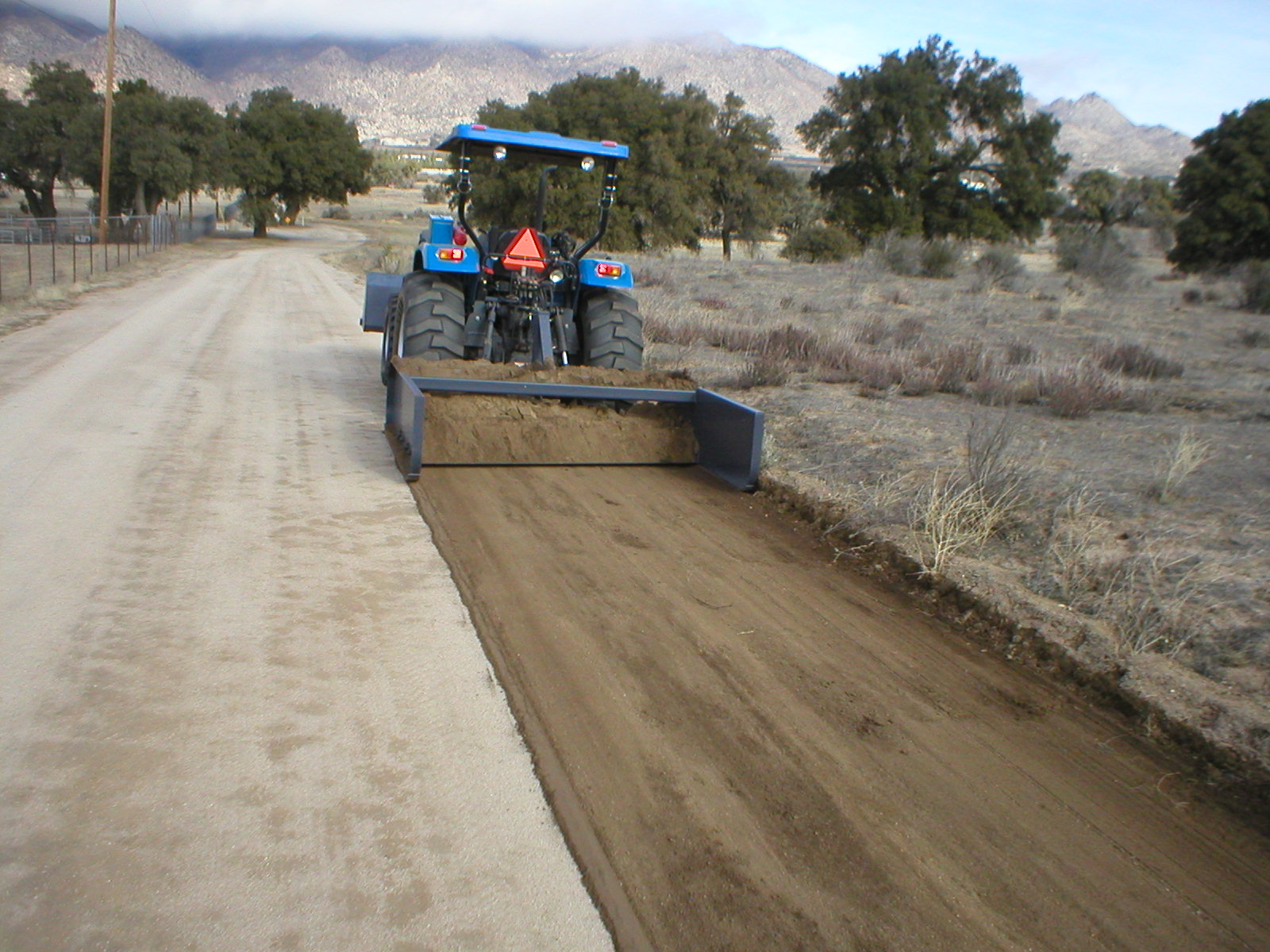

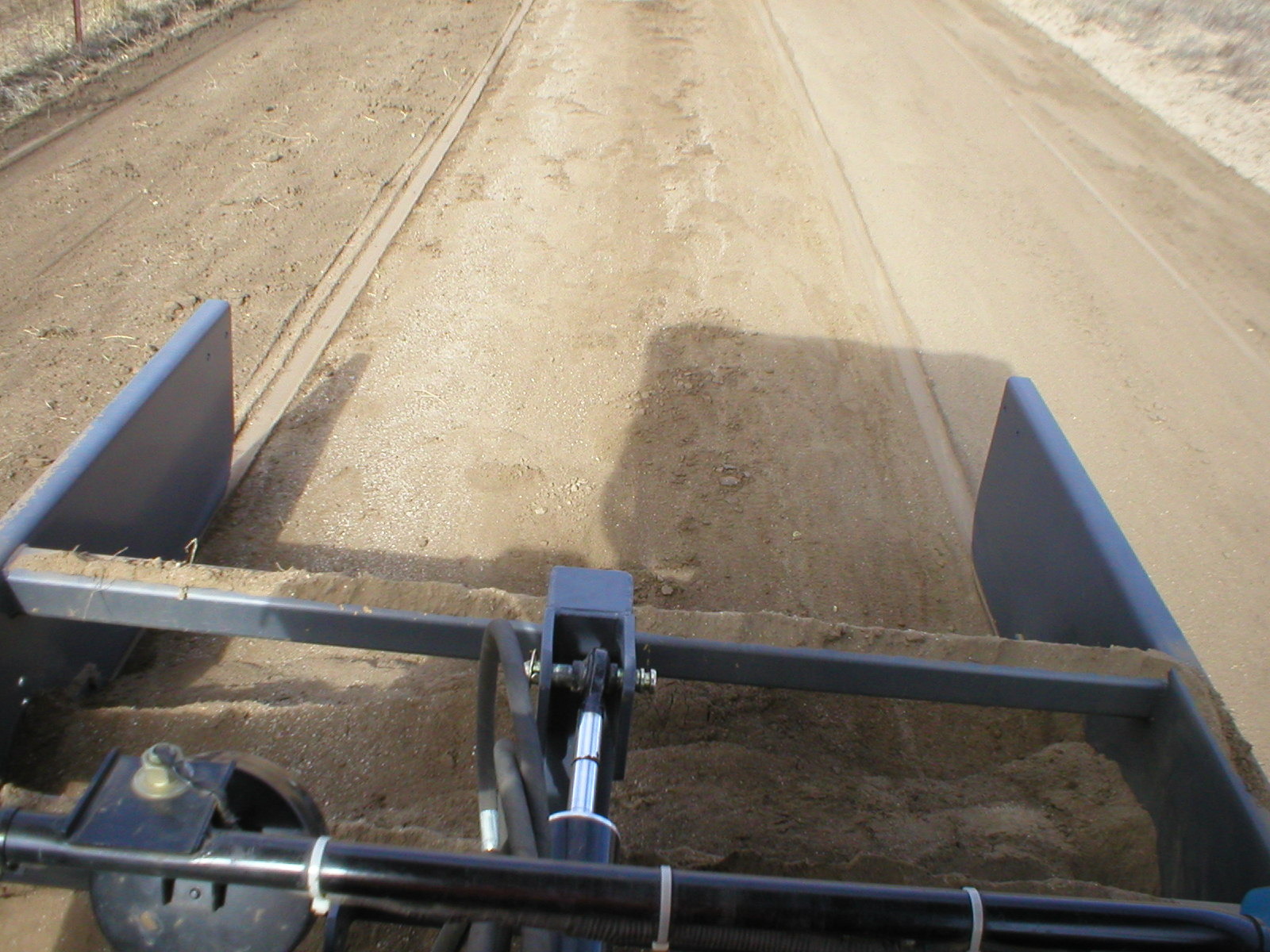

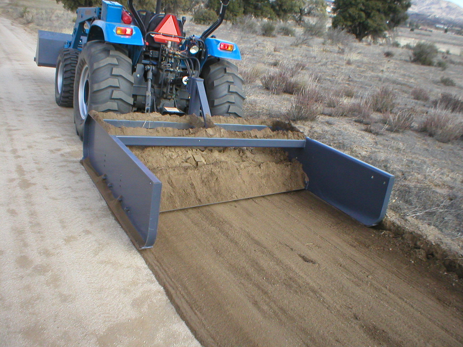

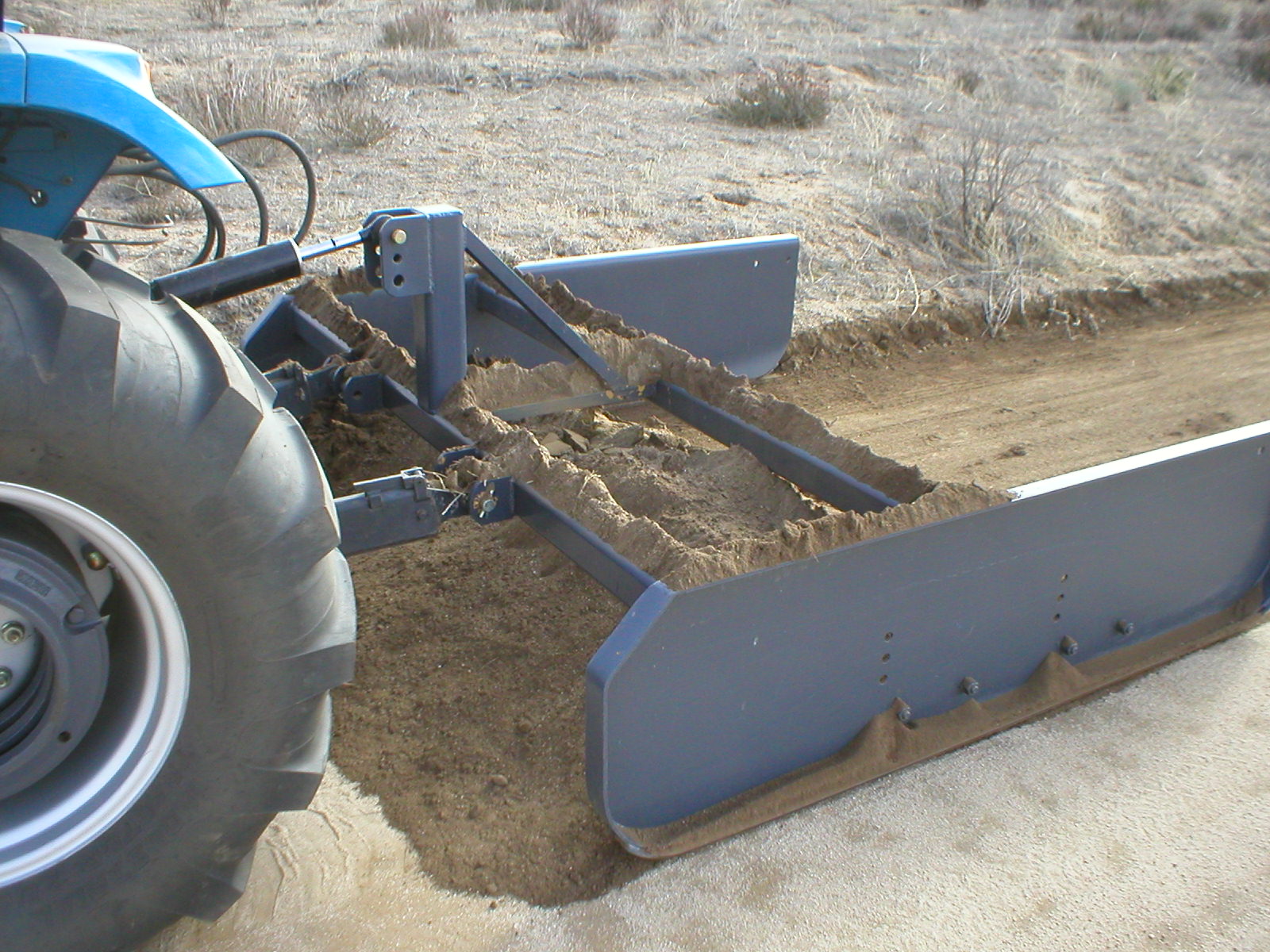

It has been my experience that the side ways material movement that so many talk about is at best minimal. If one actually watches the material go up and over each blade, it travels side ways, at most 1" and I actually doubt that it is that much. Here is a pic with the grader loaded up with about a yard of material and you can see that not all that much is left. ;)

I can't address the Agritek scraper, but it looks like it would work fine for spreading loose material. I've got a Land Pride Grading Scraper, and really like it. So do my neighbors!
I'm not too proud to tell you that I got frustrated with using my box blade and rear blade to maintain my driveways. But the LPGS was easy to work with from the start. It didn't take long to shape up the divots and small potholes.
I also discovered something interesting this winter. My weight box was blocked in when I hooked up the snow blade, so I just hooked up to the LPGS, figuring it would work as well or better than the weight box. Turns out it also worked well enough to push snow back and even spread out snow piles instead of turning the tractor around to use the snow blade. Then I found out that it worked great to cut down the snow and ice ruts on my neighbor's drive from when he had to leave before I could get over to clear his driveway. Slick! In the future, I'll leave the weight box off and just use the LPGS when I put on the snow blade.

If you have potholes then you would really benefit from the ripping shanks on some grading scrapers. I ended up with a BEFCO GS, it was cheaper than the Woods or Land Pride and I could order it on-line and have it shipped right to the house. It's also heaver, a good thing.
I'm not sure if the angled blades are needed. The nice thing about them is they do move the gravel to the side. It comes in handy on level drives. You can drive on one side of the drive, turn around at the end, and then go back down the other side moving the gravel from the edges to the center. When it comes to moving gravel back up a slope it's not so helpful.

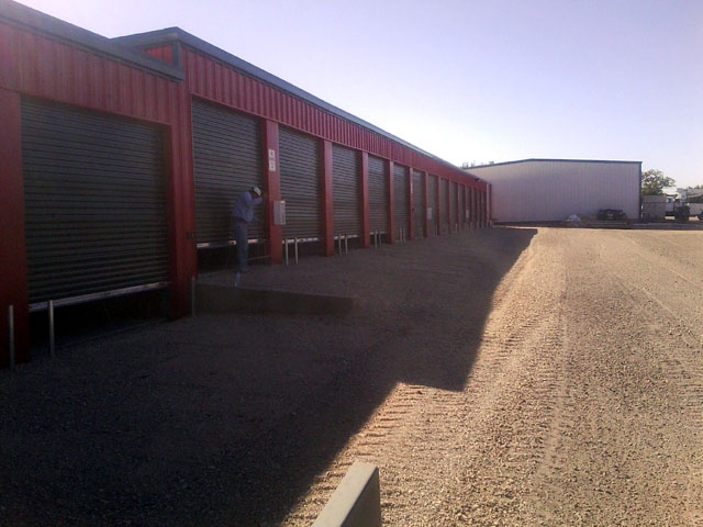

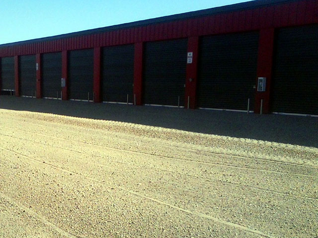

Here's a couple landplane photos for you.
Arena ready for a rock picking party
Graded flex-base
A better angle

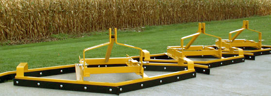

I actually like the idea of an asphalt float better. Pic from a TBN members previous post..
