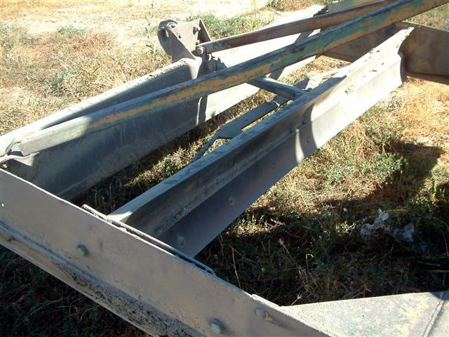

It seems like some of the landplanes with multiple blades (most of them?) are also relying on the blades as structural members. There is no other support on the bottom portion of the landplane, towards the back, aside from the blades.
On my LPGBs, the blades are fastened to 5/8" x 6" angle. I don't think that there needs to be anything else, not with mine anyway. ;)
That's what I was referring to, as far as adding structural stability. Meaning that the blades being there, are what add to the structural stability, because without the blades, there would be no need for the angle iron it's bolted to. :D

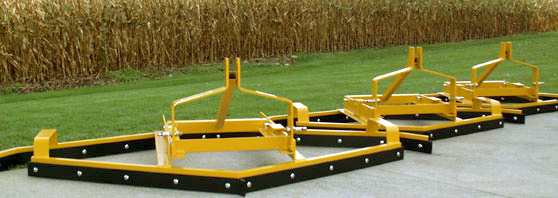

Hey gang, I know the whole drievway scraper discussion has been leveled off quite a bit :laughing: BUT I havent seen anyone suggest something like the Agritek scraper. I have a few driveways and two small parking lots that would need leveled. My personal driveway doesnt pothole but with the rain I get a little washout in certain places. BUT I do have two driveways that tend to pothole get a little uneven. I typically will crown the driveways by angling my 3pt scraper blade to the center then grab a higher gear with the blade straight across and let the blade ride up. It does a pretty good job but it tends to not crown out far enough to get the water off the drive.
I like the landpride driveway grader but I dont like that the spill off is both on the one side, and that is where I like the Agritek style driveway scraper. They are both priced about the same only but the Agritek is 72", 96" and the LandPride is 72",84", 96"

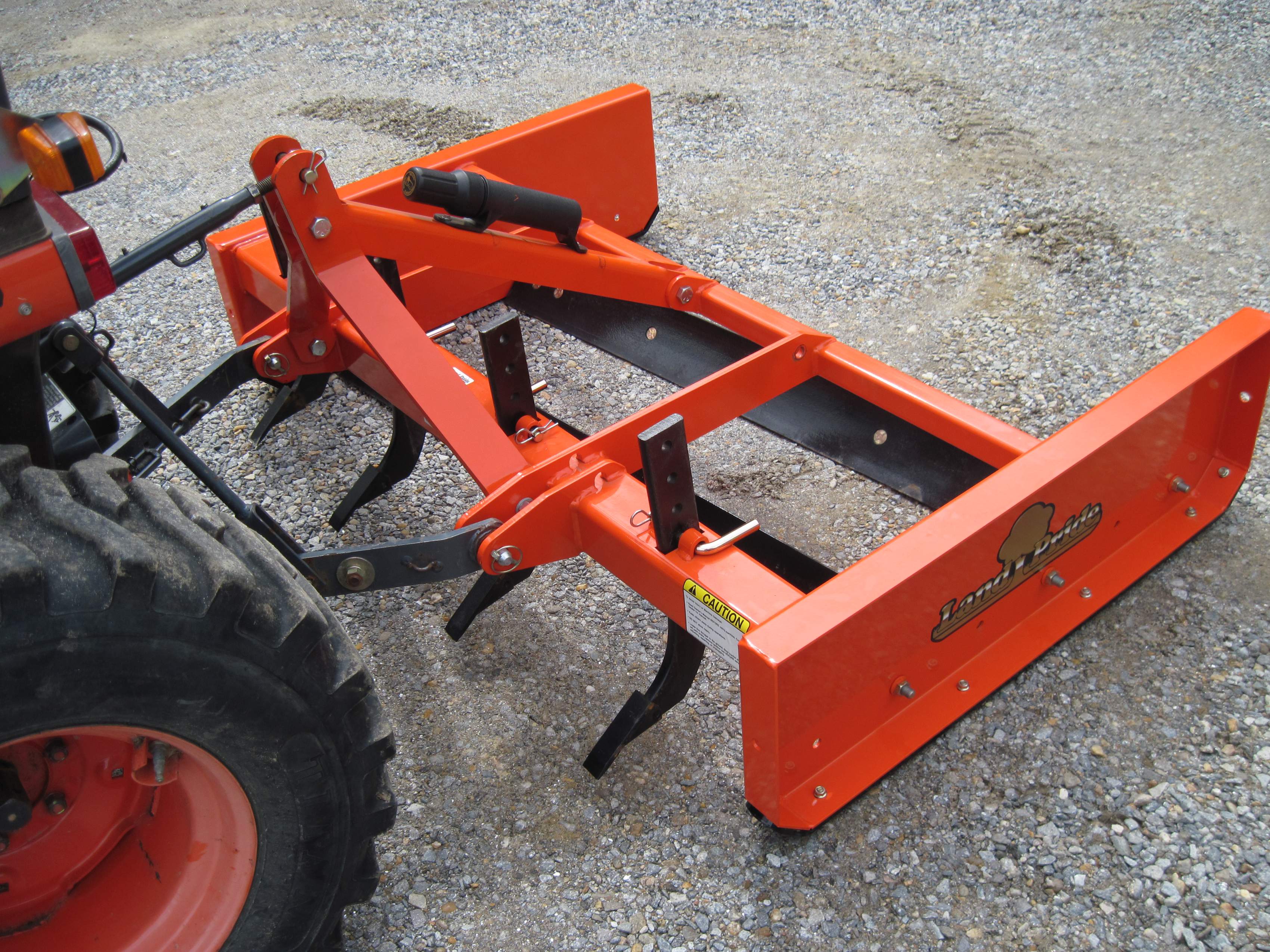

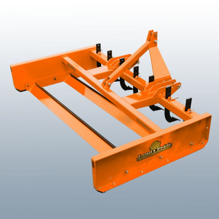

When I bought my land plane, I had to deal with deep pot holes. I bought the Land Pride because it had the rippers so I can rip down as deep as I need.
For quick touch ups, like I am going to do this weekend, I leave the rippers up.
The scarifiers give me ability to rip up like a box blade, and the plane gives me the speed, control, and ease of use that I was looking for.
I really enjoy working with this tool.
The BEFCO has an inner frame that's adjustable. The blades mount to the inner frame and the whole thing can be moved up and down. The outer frame is made up of the sides, the cross members, and the 3pt mounts. The front cross member is extra heavy as it also holds the rippers. I think the Woods and Land Pride also are like this.

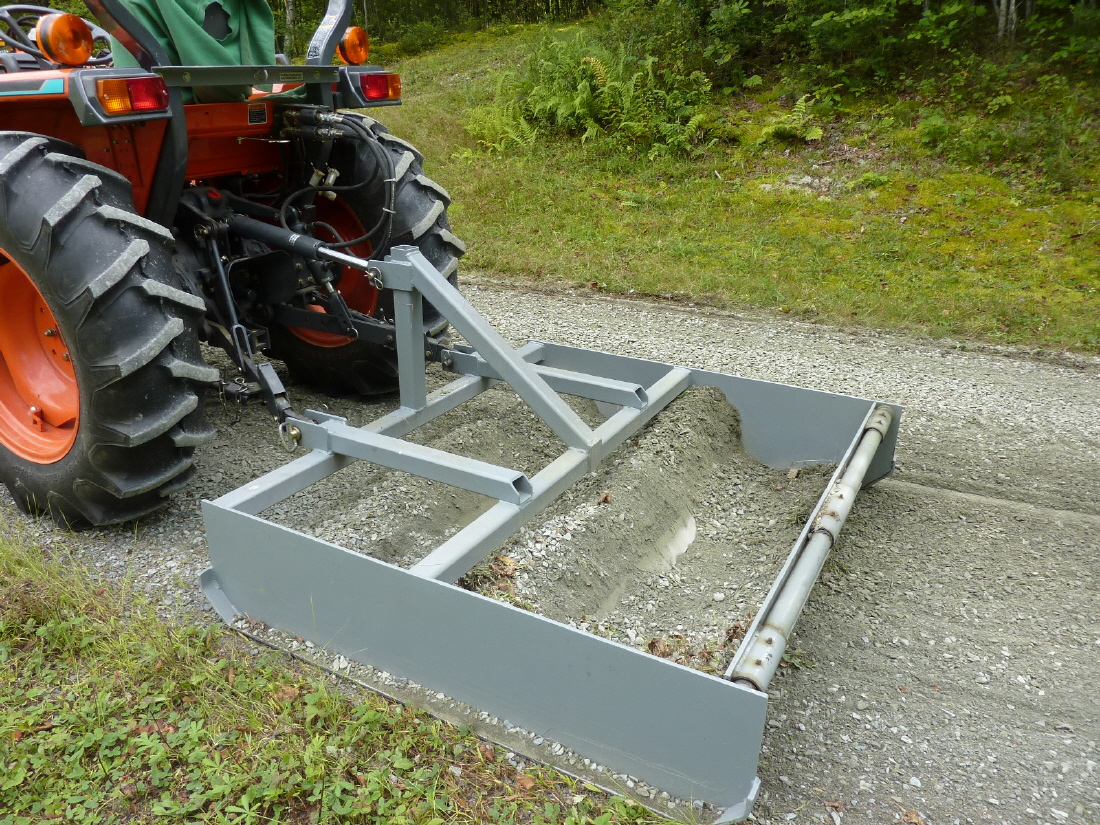

Old thread but good discussion... I agree with you Danny. But would like to add that the land plane grading scraper should be doing a lot more than moving around loose surface material to fill in low spots. If it is working right it cuts down into the road leaving a hard flat under surface with a loose layer of freshly mixed gravel on top which should be compacted for best long lasting results. The trick with pot holes is to go over them with the LPGS when they are first forming so you can cut down to the bottom. For your own road that should be no problem. For comercial work you probably won't be called until the drive needs serious work and is beyond using just a LPGS for repair.
