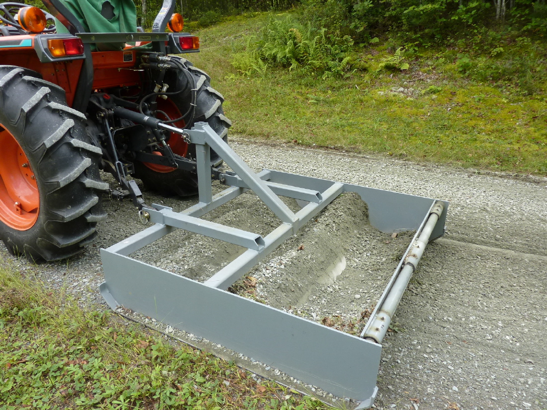

Old thread but good discussion... I agree with you Danny. But would like to add that the land plane grading scraper should be doing a lot more than moving around loose surface material to fill in low spots. If it is working right it cuts down into the road leaving a hard flat under surface with a loose layer of freshly mixed gravel on top which should be compacted for best long lasting results. The trick with pot holes is to go over them with the LPGS when they are first forming so you can cut down to the bottom. For your own road that should be no problem. For comercial work you probably won't be called until the drive needs serious work and is beyond using just a LPGS for repair.
