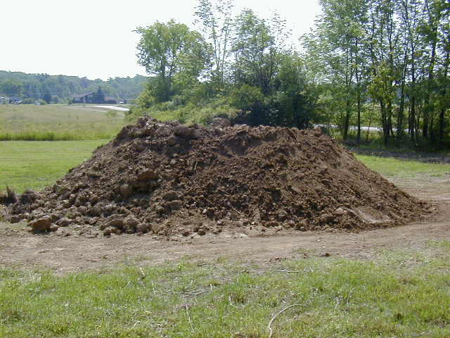

Wish I would have spotted that before I dug. Wife said they have the large rock there already. And they spread it decent with the truck. Should I dig this back up? /forums/images/graemlins/confused.gif Or just see how it handles it first. /forums/images/graemlins/ooo.gif Driveway currently went back only 50' so far. I hit a soupy spot that sunk my tractor last night. And after getting it out I was to aggrivated to continue. (After 10:00pm The neighbor kiddy corner across the street starts staring. Don't want to upset anyone yet. Still moving in.) I'm thinking of taking the backhoe and seeing how deep this soupy spot is. Then backfilling with some gravel or something solid. Like concrete from the Barn I've yet to tear down! /forums/images/graemlins/wink.gif I'm hoping to put a workshop at the end of the parking area. So I can finally have my own play space without animal cages and supplies. (10 years in business with the chinchillas and they finally have there own place. ) Is there a good way to pack the stones? And the future pad for the workshop?

Soupy spots normally indicate water run off. If you have water problems you will need plastic drainage pipes under the drive to move the water. If it is allowed to cross the top of the drive it will never firm up.
I have 3 pipes diverting water under our drive in various locations. They keep the drive stable.

Sorry about the typo (50 vs 15) at least I plugged the right # into the equation, 35-40 ton total. As far as compacting the stone; what we have been using is a rental walk-behind Vib Roller. They get about $125/ day for one here. You need to be able to fill it with water on site. I know this much; when you turn on the HYD. VIB. you know there is something at the end of your arms. I've used one for 5-6- hours in a day. I think it took me three days to stop shaking. But, the "thing" as I call it seems to do a good job.
