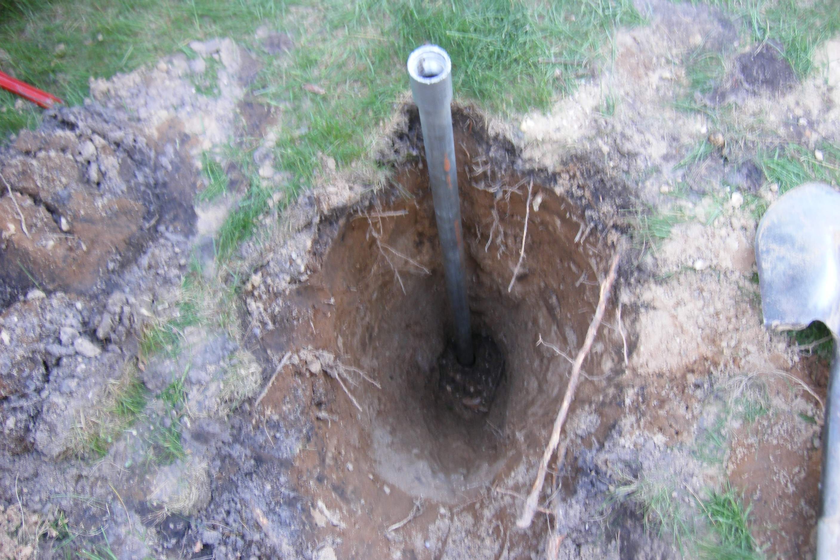

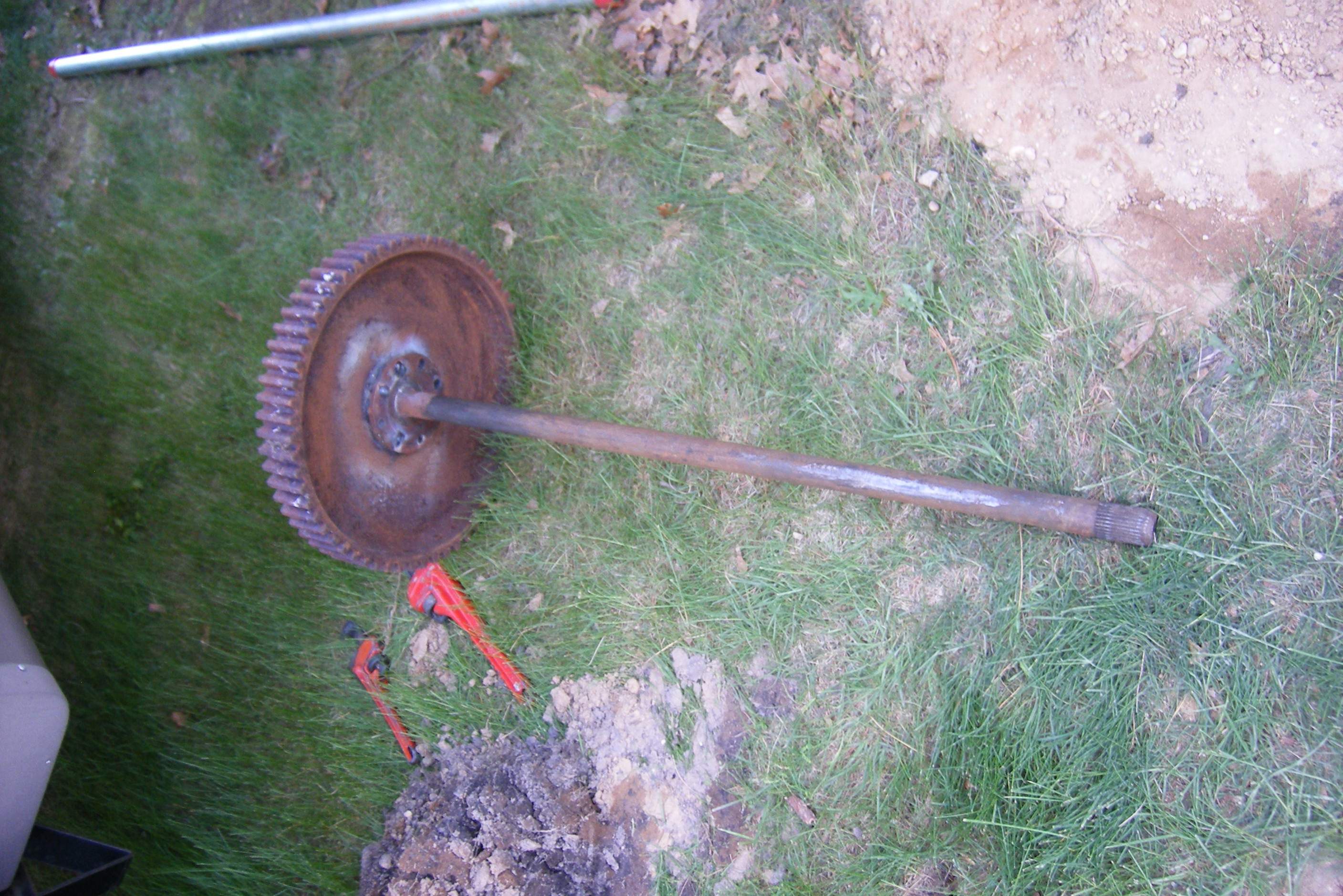

I've put this off for over a year, so today was the day to start.
I'm pounding it down, bit by bit. I'm down about 14' feet so far. I already hit some water. I intend to drive it down 20-23 feet and I will be using a jet pump I got off Craigs last year. I really want to stop using our deep, submersible well for irrigation of the gardens.
I'll keep you posted as to how this goes.
/ Driving A New Well
#2

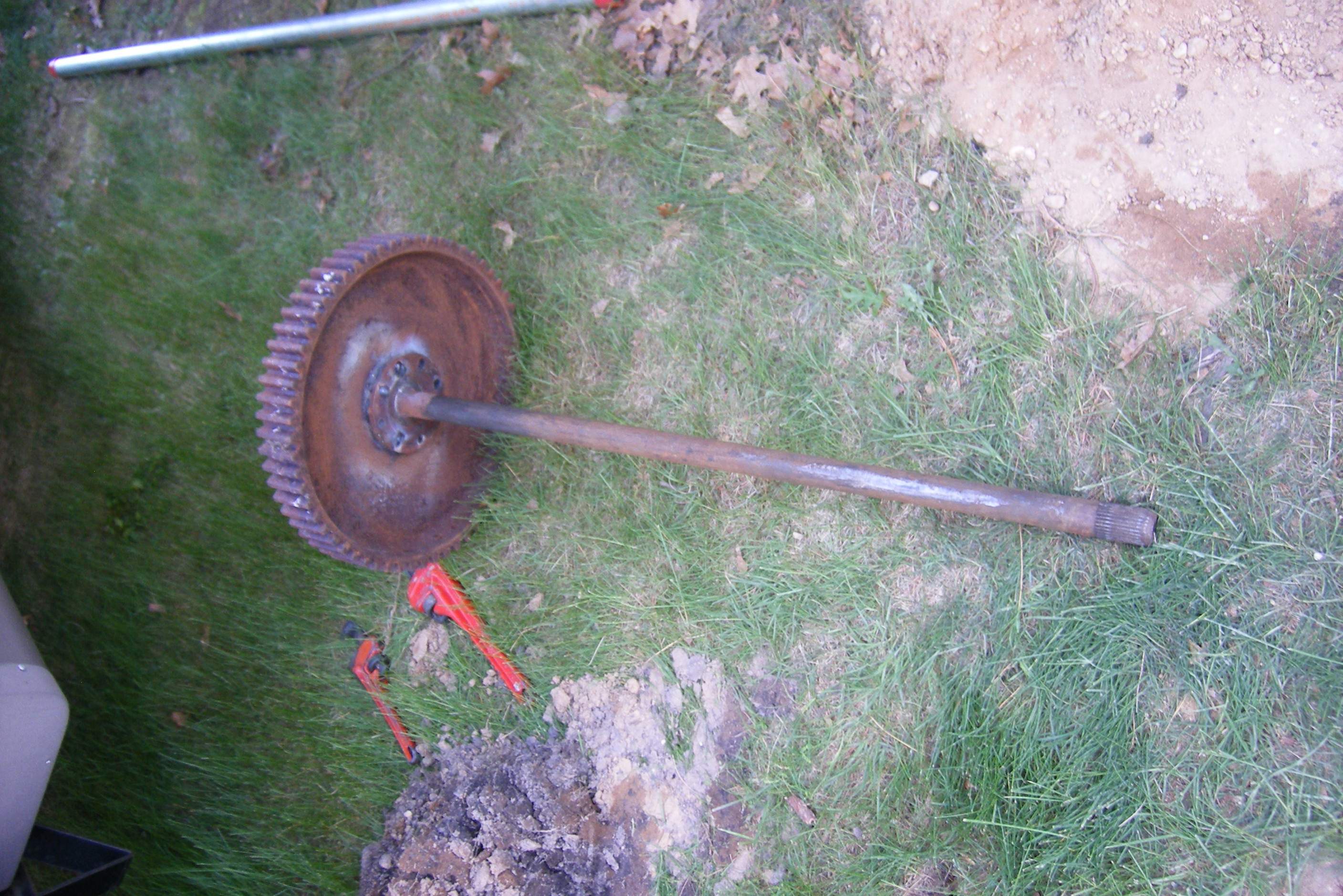

Couldn't find a widow maker to rent at our one and only rental yard. Oh well. My neighbor looked through his junk iron and we found an axle shaft and an old gear that has to weigh 40 pounds. Welded the axle to the gear. Slide the axle down the well pipe. Pick up the gear and let it slam down.
It's working better than anything I've ever use before. Thanks to my neighbor, Tom. :thumbsup:

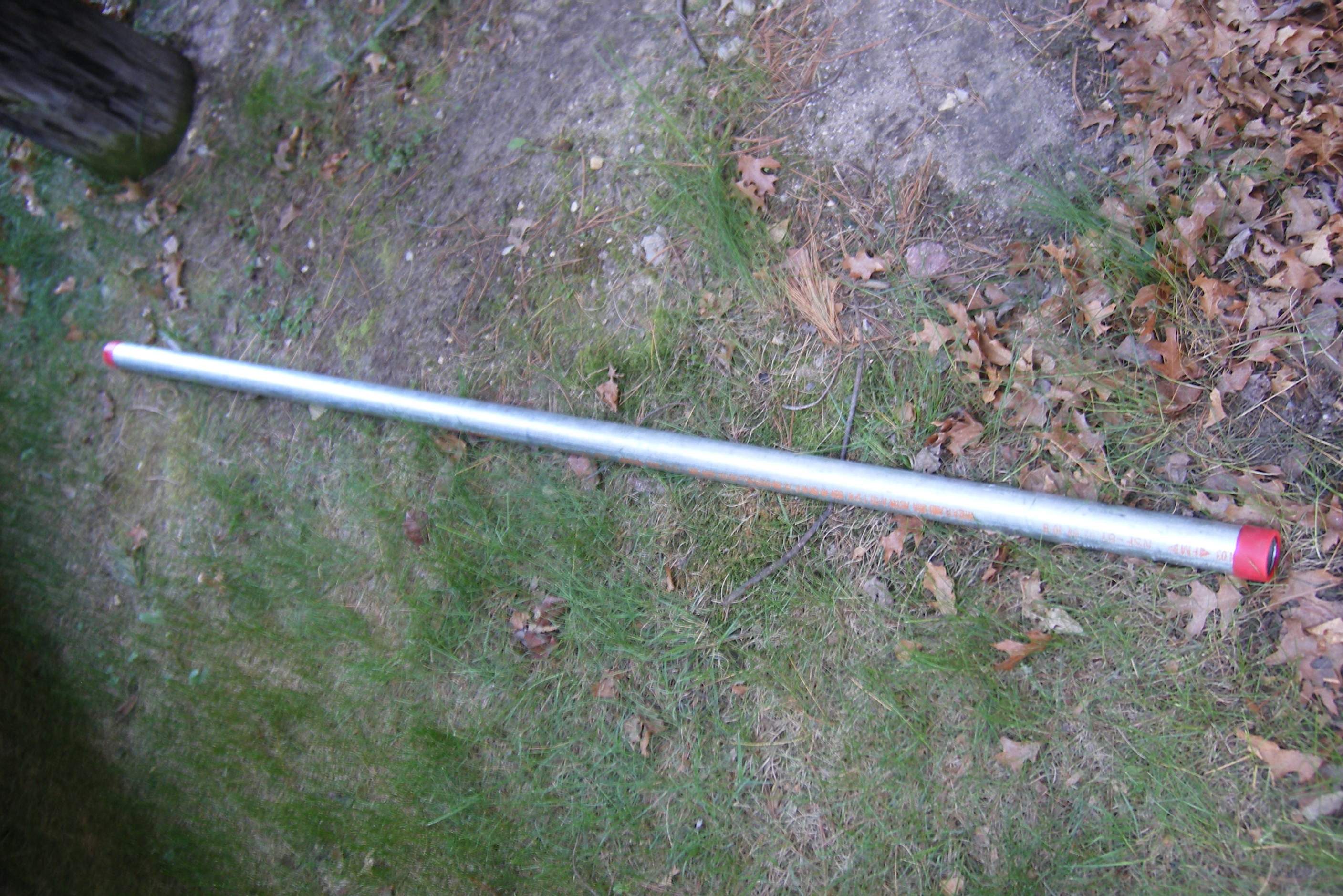

A driving well point, pictured, has a hard point, and the body of the point, is perforated and has a stainless steel screen. I am driving a 1 1/4" diameter point. The point cost about $80. The pipe is standard galvanized steel pipe. It is easier to drive 4' sections of the threaded pipe.
Local hardware stores will cut and thread the pipe, to size, for $1 a threading.
The pipe is very expensive at almost $2 a foot, at local hardware prices.
What is really expensive is the "driving couplings". These are hardened and will take the shock of being pounded on without becoming damaged. Mine cost $10 each.
You drive down a section, thread on another section of pipe and pound again.

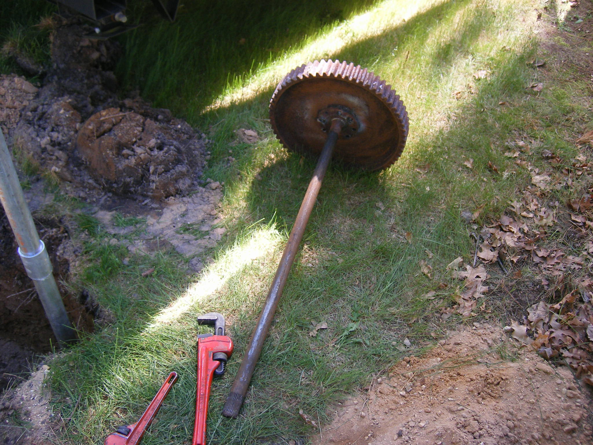

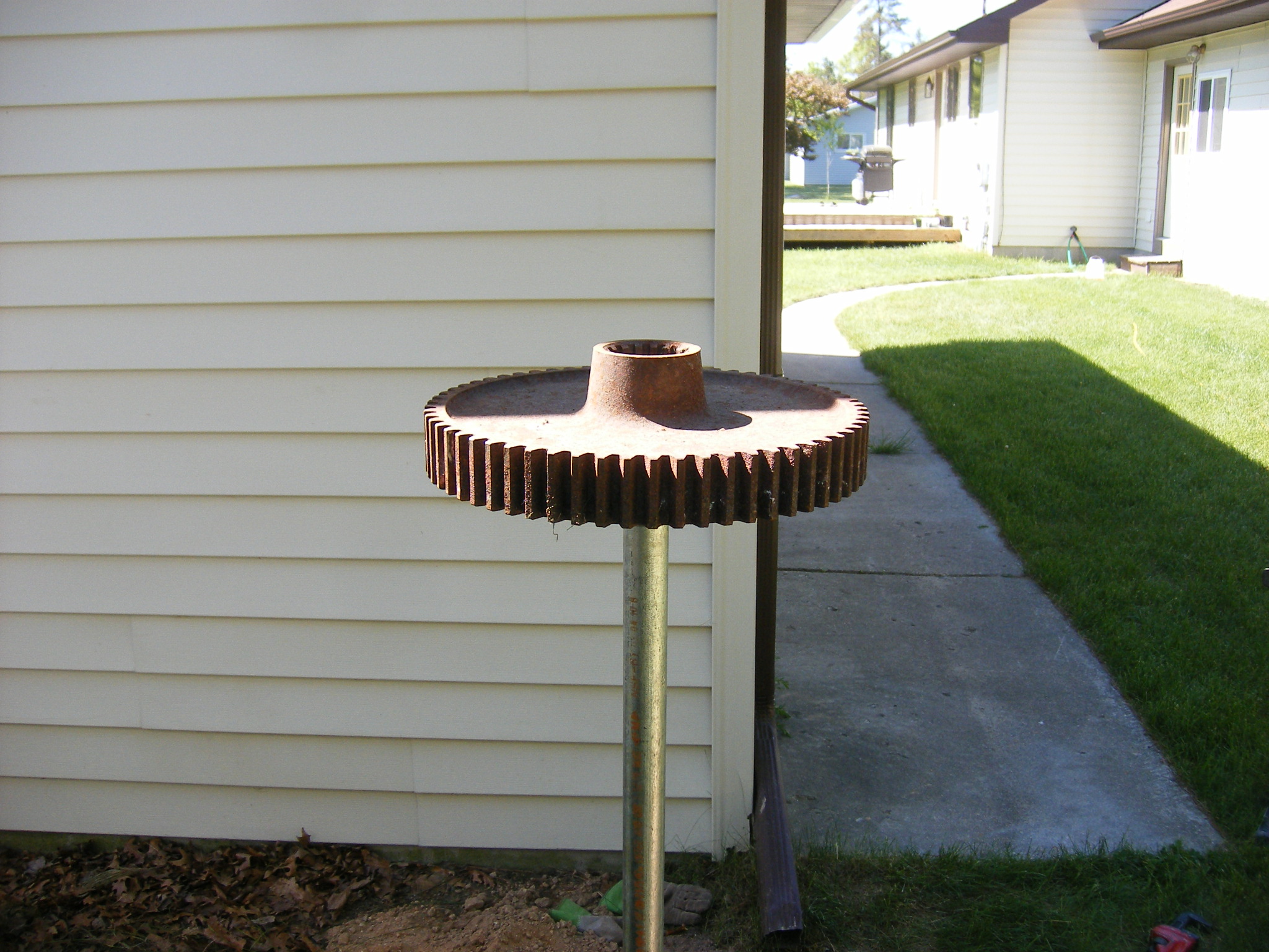

Update:
Since I've driven 12' already, from now on, I'll drive shorter, 4' pieces of pipe.
More pieces means more drive couplings at $10 a crack, but oh well. Teflon on each connection, at least I am doing so.
That home made driven has been a godsend. You do have to stop and constantly re-tighten the couplings as the whacking tends to shock them into a loose state, which is a no no on the threads, of course.

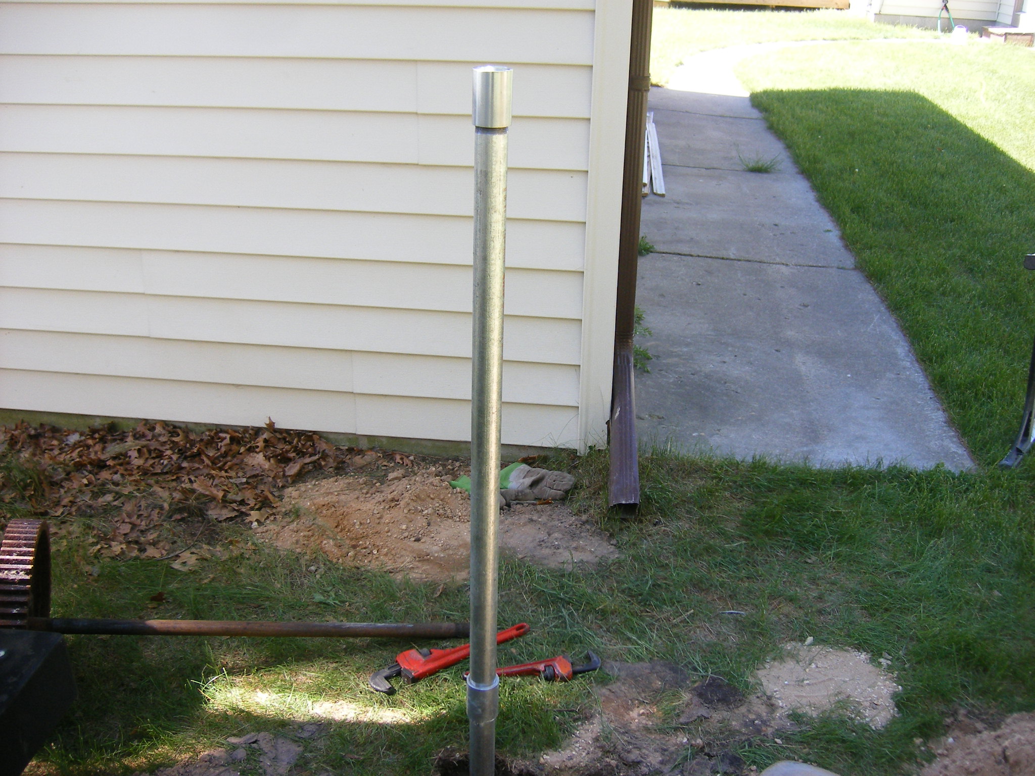

The homemade driver is working very, very well. I'd recommend this style over the the more traditional two handled pipe style any day. I've slipped a large washer, with a 1 1/4" center over the axle shaft. This washer is taking a beating, but it is protecting the surface of expensive drive coupling. No marking them at all now.
I also wanted to mention that I find I have to keep the pipe wrench handy. The impact causes the couplings to loosen a bit. After 20 reps with the driver, I re-tighen the coupling as a pre-caution.
We're down 17 feet now and the point is in water. Yes, as foggy1111 mentioned, we use the nut tied on the end of a string method for checking. We have 4' of water in the column. I'd like to go on down another 5-6 feet and see if we can have 8 feet of standing water.

OK, got it down around 19 feet and have almost 6 feet of water in the column. Probably try pumping on it. I've got another 4' section to drive, if I think it is needed. We shall see.
You guys have thoughts on "conditioning" a new point well?
