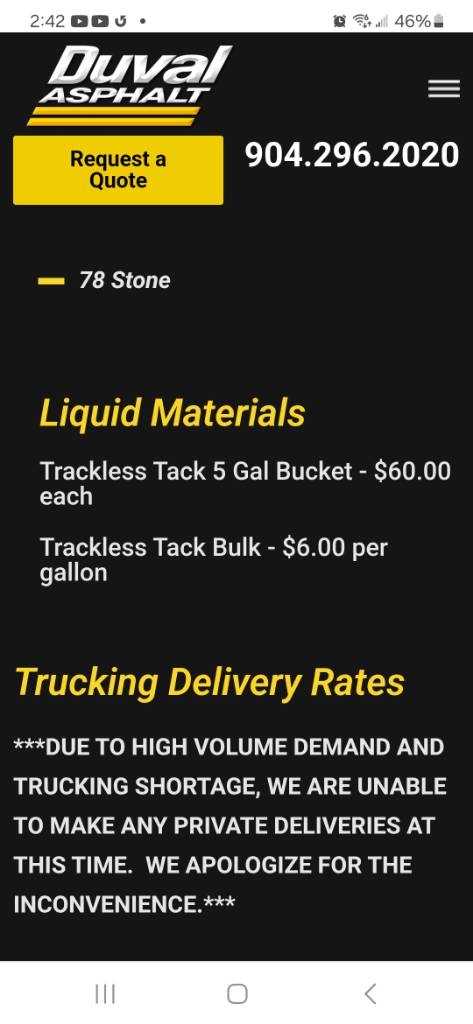

This is a semi local paving company/Asphalt plant owner that actually lists vendor pricing (which is pretty rare). This is Not the exact product, this Trackless Tack has a wax in it to avoid tracking it onto the road once it "breaks", Special MS emulsions is likely the best bet. It's not straight AC, and isn't ran at the same temps, and can be watered down somewhat and still be effective.
I read a study once by Oklahoma DOT that studied using higher application rates of more watered down prime, and found good results.
Atleast knowing the product name might get you pointed in the right direction.
