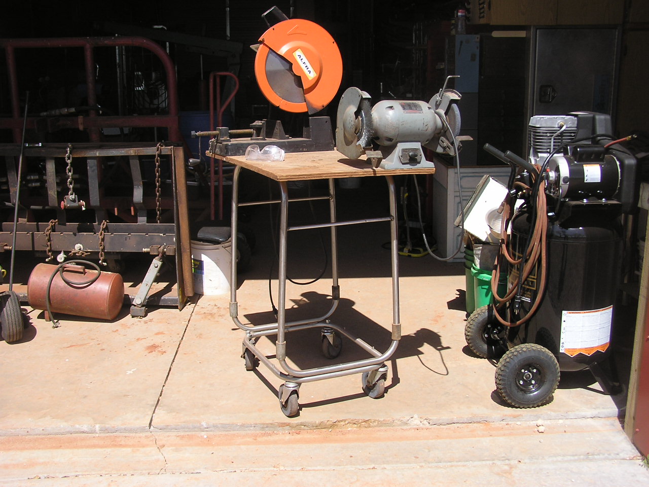

Yep, you don't know what you are missing :D.
I use mine for precision cuts, it is very high quality and well built.
