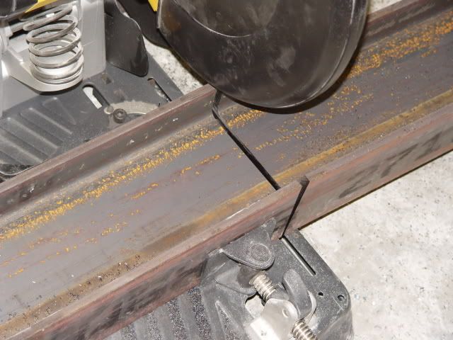

That's a mighty big hunk of wood in that saw Jim! Do you regularly cut heavy structural with it?
I have the same chop saw but I (previously:D) would use the horizontal band saw for that beam.

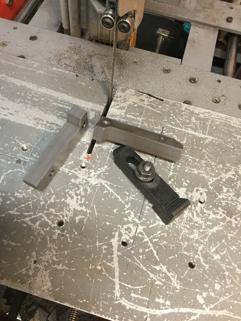

Setting up the bandsaw makes it into a different tool. Using a DeWalt portaband in a home made table, I get perfectly square cuts and notches with no trouble. The picture shows a couple latches cut out of 3/4x2 bar. Using a 10tpi blade from McMaster-Carr.
