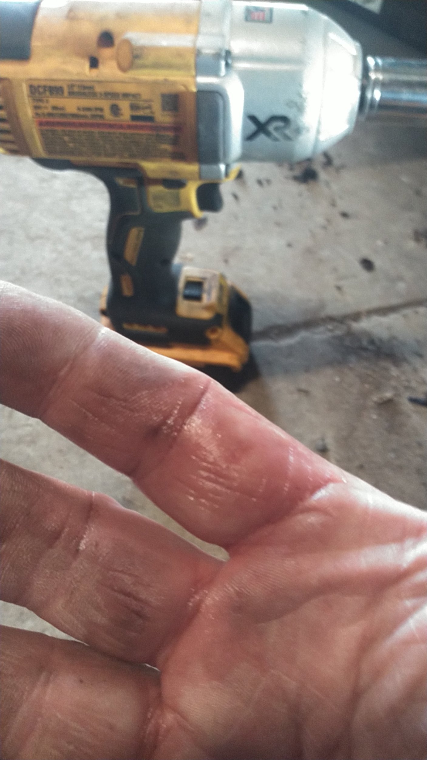

#23
Great to get in shop instead of usual desk paper pushing desk jokeying. As my backwoods pessimistic assumption seems correct occasionally, that's diesel on my hand. filter is weeping minimally from outer o-ring i believe. Makes sense considering the truck has a problem staying running after sitting more than a few days. Why would the gm engineers make that bloody filter so inaccessible? imo. This time around I'm more annoyed trying to document my trucks turmoil than having to pull that fender liner or inadequate repair methods by "professionals" I paid them to do it. Belt tensioner seems like it was properly done though. good day.

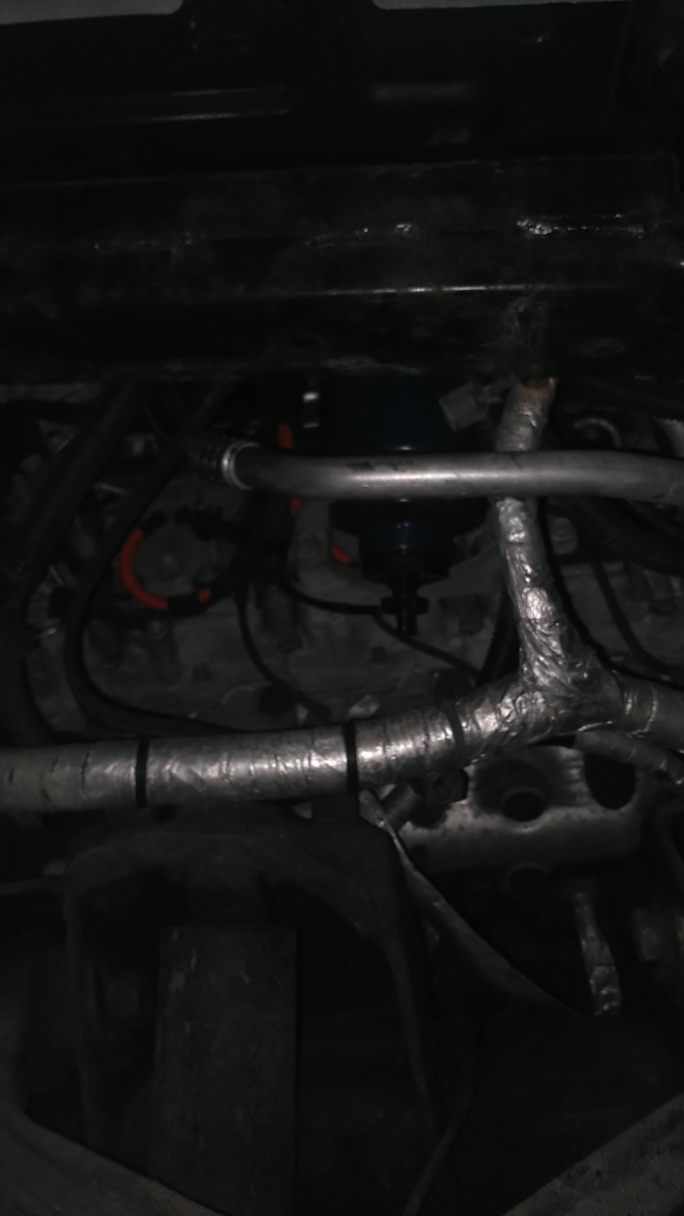

#25
I'm a sucker for learning hands on when around knowledgeable folks here's a picture of lower part of fuel filter weeping, it's very minimal and not dripping the shine is diesel, and is all I needed to see to justify replacing a rather expensive filter assembly. My other question is since it is weeping enough to cause problems staying running after sitting awhile cuz it's sucking minimal air has that weak cp4 high pressure pump been irreversibly damaged? Any way to tell without digging further into my Duramax?
/ My beloved Duramax needs help. #26
Install the new filter and make sure it doesn't leak, then if the truck runs good, I wouldn't worry about the pump.

I think I can monitor fuel pressure with my standalone banks monitor when driving just need to figure out how to change the parameters I currently have it monitor new fuel filter assembly is in I pre primed it with a mixture of marvel, power service and shh 🤫 off road diesel. Orings didn't look to bad minus a little winter grit around them, lower valve was definitely on a little to tight for my liking anyway I'm hoping the lower drain valve is ok cuz I didn't replace that. Anyways left a clean white rag around filter, using off road diesel and marvel it's much easier to look for leaking. Hopefully reassembly of fender liner goes smoothly.
