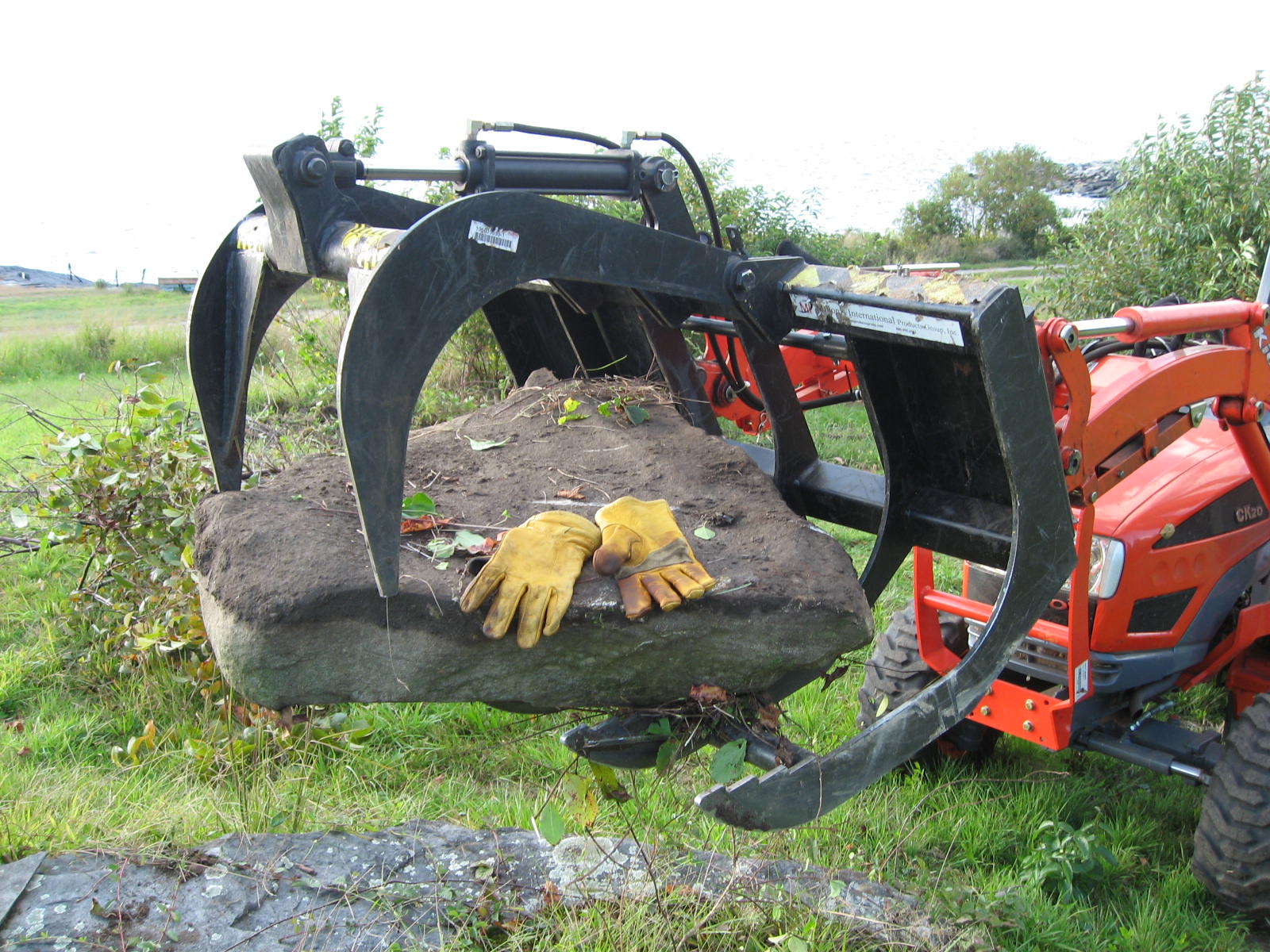

I searched and couldn't find anyone that has built one but here goes I'll try to discribe what I would like to build??? I would like a grapple that will reach out and then pull in brush or small logs to my fel.. 2 pistons working in tandom.. Has anyone seen this done or have any idea what type of problems I might have???
A backhoe with a thumb would do what you are asking. Any attempt to build a grapple with those characteristics would IMO result in a very delicate easily damaged mechanism that would severely limit the utility of the grapple for other purposes. To get a rock that is next to a tree just use a grapple to approach the rock side of the tree and grab it.

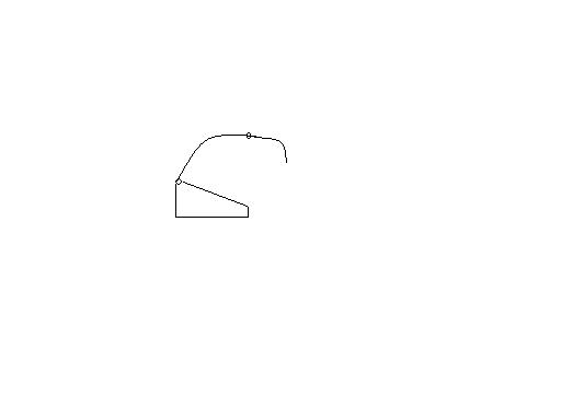

I have a backhoe with a thumb but don't keep the hoe on all the time.. I have very tight quarters in between the trees and lots of rocks and dead branches.. "kinda lazy".. If I were to use a normal grapple like you say.."Ok "in use" I open the grapple and tilt the bucket down" After you lower the bucket down you can't see what your picking up.... I was thinking if you could go in with the bucket flat that I would have more control over what I am loading???
I'll try to attach a "crude" pic,,
/ Dual action grapple #16
A true grapple allows you to see exactly what you are picking up as there is no solid bucket to block your view.
