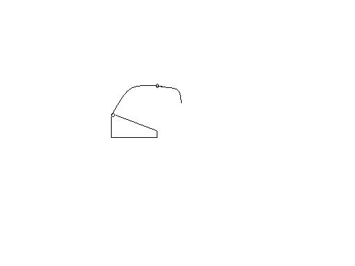

I have a backhoe with a thumb but don't keep the hoe on all the time.. I have very tight quarters in between the trees and lots of rocks and dead branches.. "kinda lazy".. If I were to use a normal grapple like you say.."Ok "in use" I open the grapple and tilt the bucket down" After you lower the bucket down you can't see what your picking up.... I was thinking if you could go in with the bucket flat that I would have more control over what I am loading???
I'll try to attach a "crude" pic,,
Go buy a "Hungry Hungry Hippos" game and tear it apart. There is some mechanism in there that allows the Hippo to arch up and over on the way out but it pulls straight back. It sounds like what you're trying to do. I'm sure there'll be a way to scale it up with metal and hydraulics.
In the end the project may not be practical, but if you give it a try at least the rest of us will know ;)

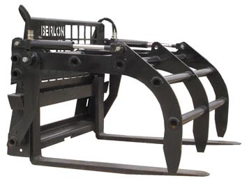

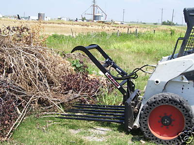

If you have a set of forks, something like this would be easy to build.
In the last picture, you could use one cylinder per fork, or put two forks on with independent action. These just slip over the fork, could even be a fork extension.
And, if you are a really good designer and fabricator, you could build a transferable grapple that could be mounted on either the forks or on your standard bucket. That would be nice.
There is little if any benefit to dual grapple arms and it would be much simpler, less costly and less weight penalty to just build one 24-30 inch wide grapple arm.
