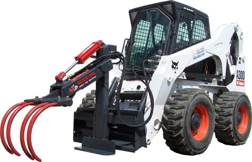

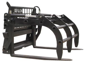

I think some 60 in fork grapples would work very well also. Picture below. hr3 are you planning to use one cylinder for the grapple or two independent cylinders for each half? The grapple on the Bobcat, actually reaches out and pulls stuff in to compress it. It can grab quite a bit more than a normal grapple. The first grapple is a hinged grapple.
